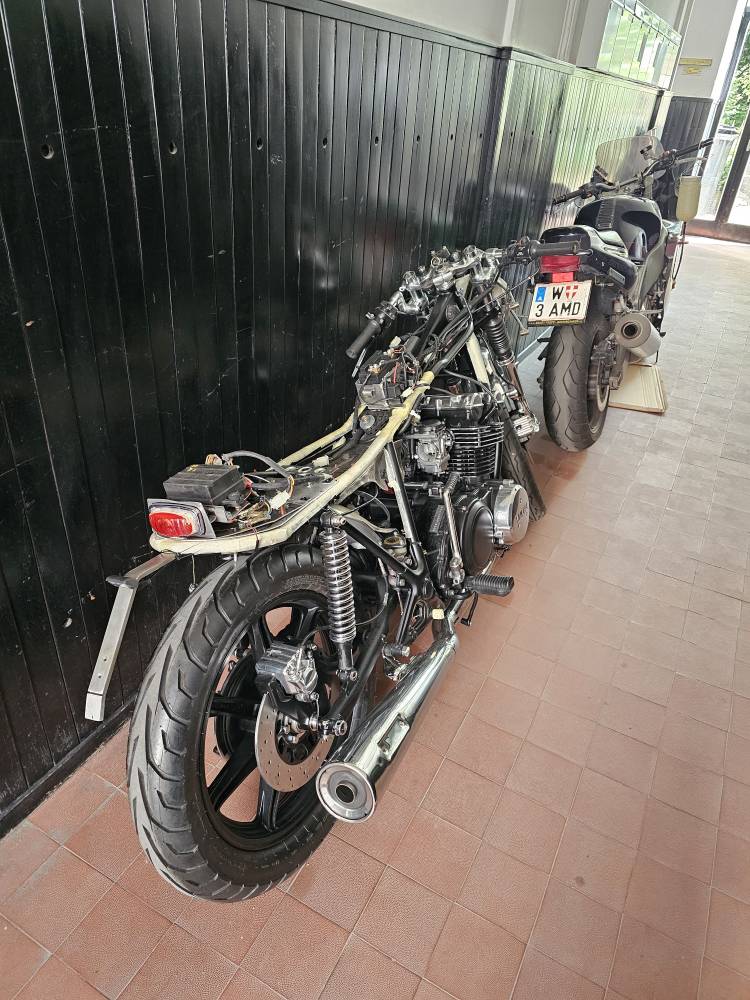

Dear Forum!
Its been years since I posted on here. Its amazing to login again and see that the community is still alive and well and keeps on making cool projects.
I have been busy with all kinds of things but was constantly chipping away on my Yamaha XS 896 project.
The project took so long since its been my learning project for my sheet metal skills and has been a steep learning curve.
I have been constantly learning and taking courses at Wray Schelin´s Pro Shaper workshop in Worcester near Boston.
The body of the motorcycle will be completely made from polished aluminium sheet metal.
Engine specs:
Big bore kit (896ccm,bored out XS850 cylinders)
Keihin CVK carburettors from a Triumph Sprint 900 (Main:120,Idle:38,Needle:N3RF) with K+N pod filters
3-1 Jama exhaust
Now I have been able to start the bike but ran into problems.
The bike only starts with starter fluid and kickstarter and electrical start combined.
The bike runs and idles on the carburetors.

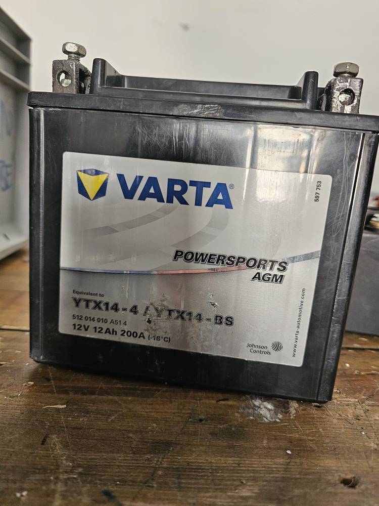

I am using a small lithium battery, which seems to be drained very fast and cant turn the engine over strong enough.
I also tried to use the battery of my FZR1000 which has a bit more oomph but it is also unable to turn the engine over.
What would you guys recommend doing now?
Just borrowed a larger lithium battery and will try with that one, but I have the fear that I will need a way larger battery (which will be problematic fitting under the tank).
Thanks guys!
Carl

Is it turning over slowly? If so the starter may be gummed up causing hard starting.
Ideally if your carbs are set up properly you shouldn't have to turn it over with the starter more than one or two revolutions for the bike to start up.
I would start by comparing the CCA/Ah of your batteries.
Keep in mind many folks ditch the electric starter for kickstart only for customs simply to get rid of the big old battery.

So I tested the bike with a new lithium battery I borrowed from a friend that has more oomph. The engine seems to be spinning more freely and I am sure that this is enough to start the bike.

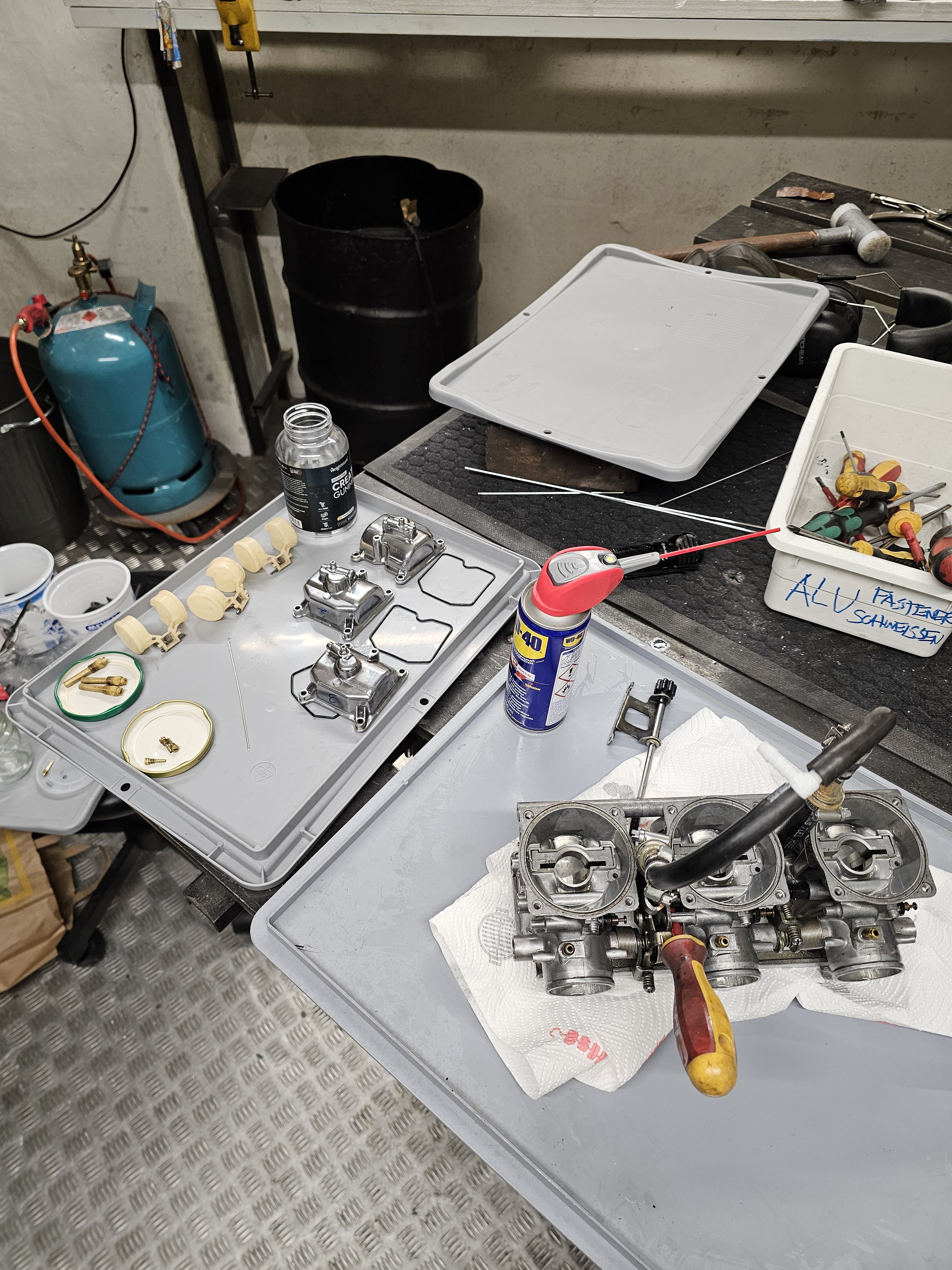

Dear Forum!
Thank you again for the answers, I will keep all that in mind when cleaning the carbs.I will focus on getting a clear stream of carb cleaner trough all orifices.

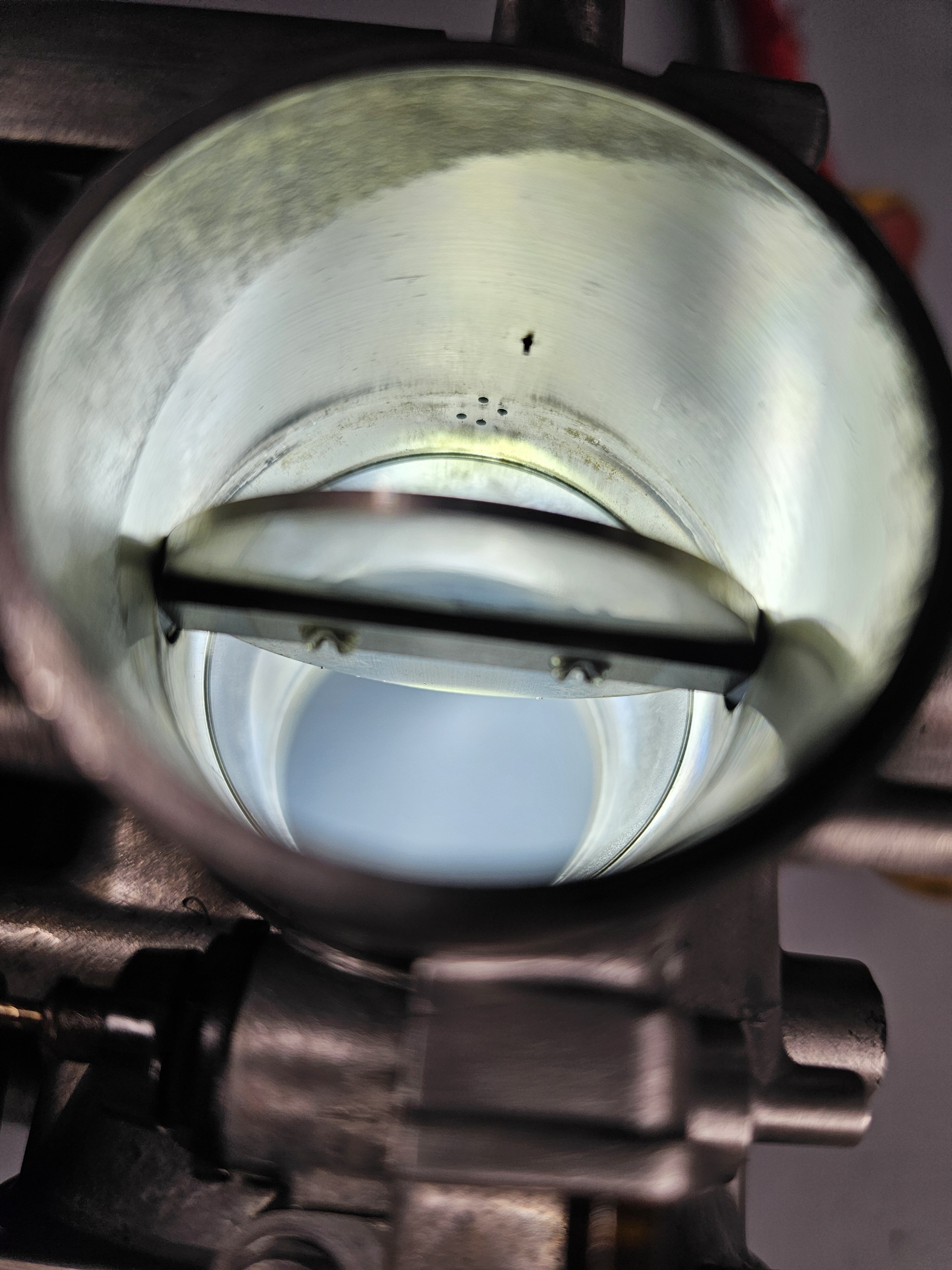

I took all the jets,slides,mixture screws out of the carburetor,being as careful as possible not to screw any of the heads of the brass jets up.
The mixture screw has 1 small opening going into the carb throat (with the peak of the screw slightly pointing out).
The idle jet has 4 little holes also opening into the carb throat.
I took all the hardware out and blew these holes clean with compressed air and carb cleaner.
Next up is the choke circuit.

I already came pretty far with cleaning the carburetors.I took out all the jets,slides, needles and seals. I blew trough all orifices and passageways with air and carb cleaner. I also used a ultrasonic cleaner and the repeated the process looking for a clean stream of carb cleaning coming out of every orifice.
From what I see there was no plugged idle jet orifice or jet.
I decided for now not to split the carbs. There are some orings on the plastic connectors (fuel flow connectors between carbs also air vents) which probably need attention in the future, but for now I thought it would be good to focus on the idle + starting circuits. I also saw that I missed an Oring on one of the mixture screws, which I will order and put in the missing spot as soon as I receive it.

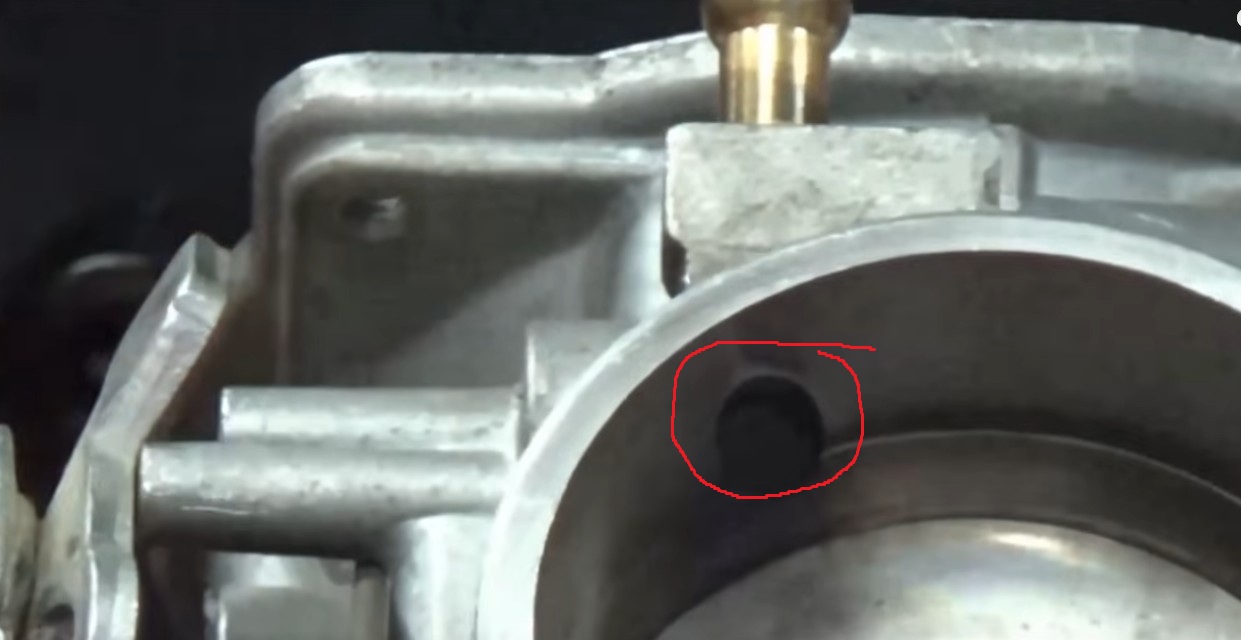

I however have problems identifying if the fixed starter jet is clear.
It is somehow hard to blow air or carb cleaner into the tiny fixed brass jet that is pressed into the carb body.
The passageway runs very complicated trough the carb body running by the brass choke plunger and then trough an orifice to the engine side of the carburettor.
I will try today again to blow trough the orifice on the engine side and maybe carefully run a guitar E string trough the fixed jet.

Dear Forum!
Here a little update on my XS project.
I took a good amount of time to tear into the Keihin CVK carbs looking for any blocked orifices or jets or tears in the diaphragms.
There were no visible blocks or tears and I could see a clear stream of carb cleaner trough all the passageways.
Then I tried to start the bike and I was able to start the bike with no starter fluid but again only with combination of kickstart and electric start.
With electrical start, the engine would turn over a few times then stop and not turn over (just hearing the click of the relays). The kickstarter alone is super super hard to kick down (which I guess is due to the higher compression rate of the engine).
Also the enrichener seems now to be working fine and I am able to start the bike within 2-3 kicks (together with the electrical start). The engine clearly revs higher when I pull the enrichener and if I release it when the engine is warm the bike idles nicely.

Also the kickstarting is now way easier and I dont need to asssist with electrical start.
Then I measured the voltage at the battery and the bike was charging up to 14.6V when revved. Looks like I found the problem!
I started the bike several times enjoying the easy start over the last days and was really happy with how it turned out.
Yesterday unfortunately I measured again and the bike was again not charging :-( measured again for continuity between the three prongs of the stator and I had that between 2 prongs :-(
What could cause this to happen again? Maybe I am unlucky and the spare generator is also broken?But why did it work for a short time and supply the battery with the right amperage?
