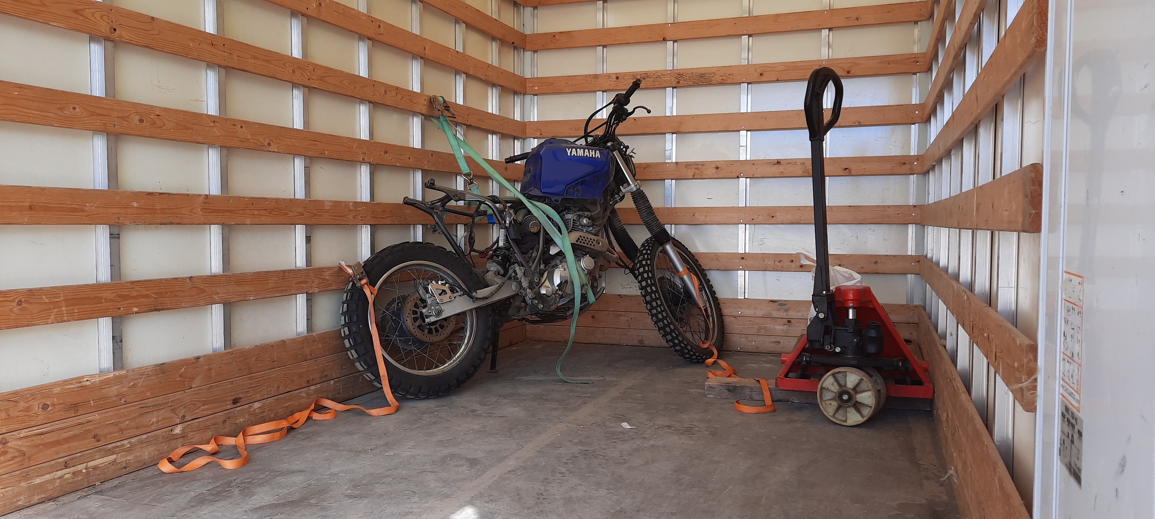

So, thappened yesterday... Frame is titled, wheels looks straight, brakes seem to do something and that's about it.
Mileage, history, if she's a runner,... is anyone's guess.
Let's just say, if she runs with just an oil change it's a bargain, otherwise I'll kick myself for it taking up space I don't have.
Behold my latest purchase, a 2003 Yamaha XT600E!

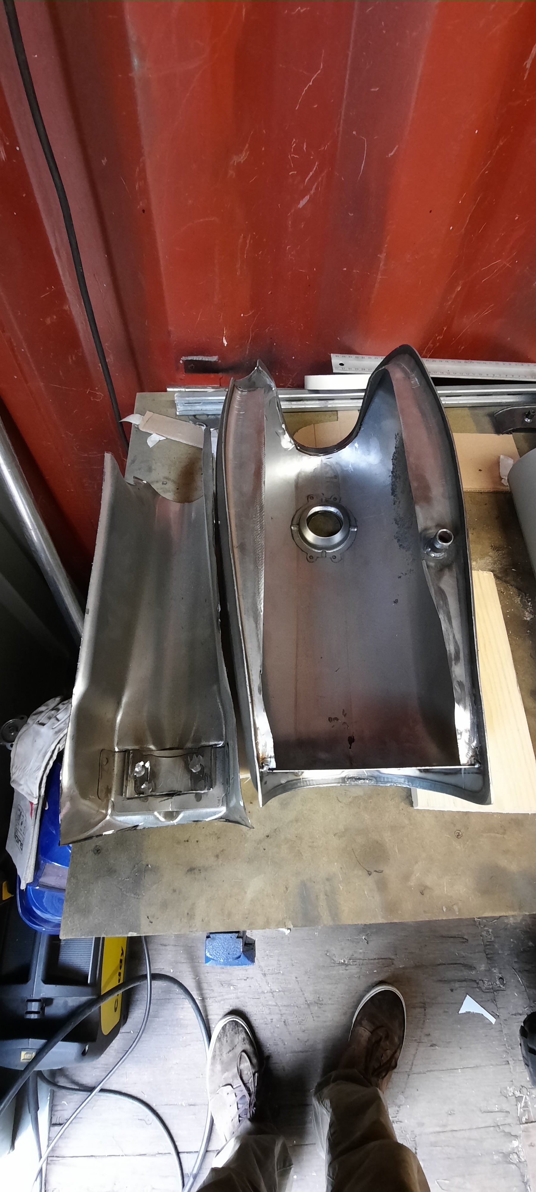

As the tank didn't want to fit due to the oil in frame neck. The front of the tank tunnel was too narrow and at the back I could fit another tank in with al the leftover space. I decided to bite the bullet and make it fit like it should.
Cut out the tunnel and made my own, after a lot of cutting and grinding welded it all up, a dozen of leaks patched up and about 6 - 7hrs of work but she's done!
Not my best welds by far but it will have to do. I will put an epoxy liner on the inside for peace of mind.
Atleast I improved the fuel capacity by a few liters I guess...

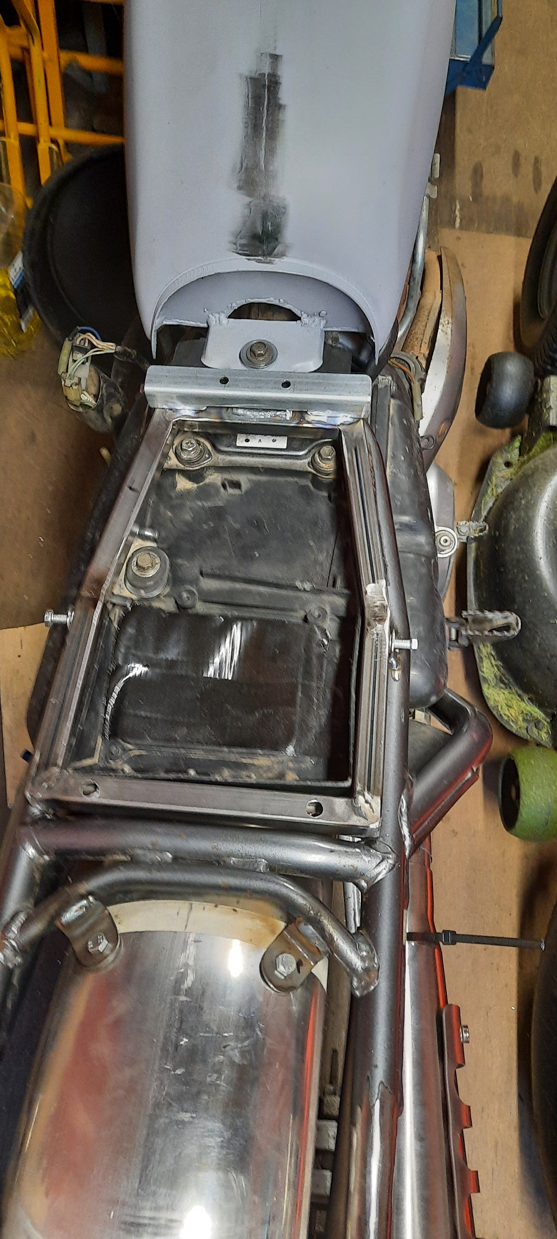

Got a little more work done, bend and welded in a new frame hoop, and mocked up the fender, seat and exhaust. Still thinking about how on hell i'm going to mount the seat firm but easily removable. Some pics to give you guys an idea of what's going on.
Oh and because the weather was pretty nice got a chance to take the missus out for a ride on the CB! ;)
Yesterday build myself a frame to mount the seat to, which in turns mounts to the frame. This gives me a solid seat fixture which can easily removed.
Still need to trim the back of the seat a bit to clear the fender. Fender is rubber mounted to avoid vibrations which could cause the taillight to prematurely break down, so any contact with the hardmounted seat is something to avoid.
Also gave the tank a coat of epoxy sealant just for the peace of mind.
Next jobs is to fully mount and weld up the exaust and start on the front end of the bike.

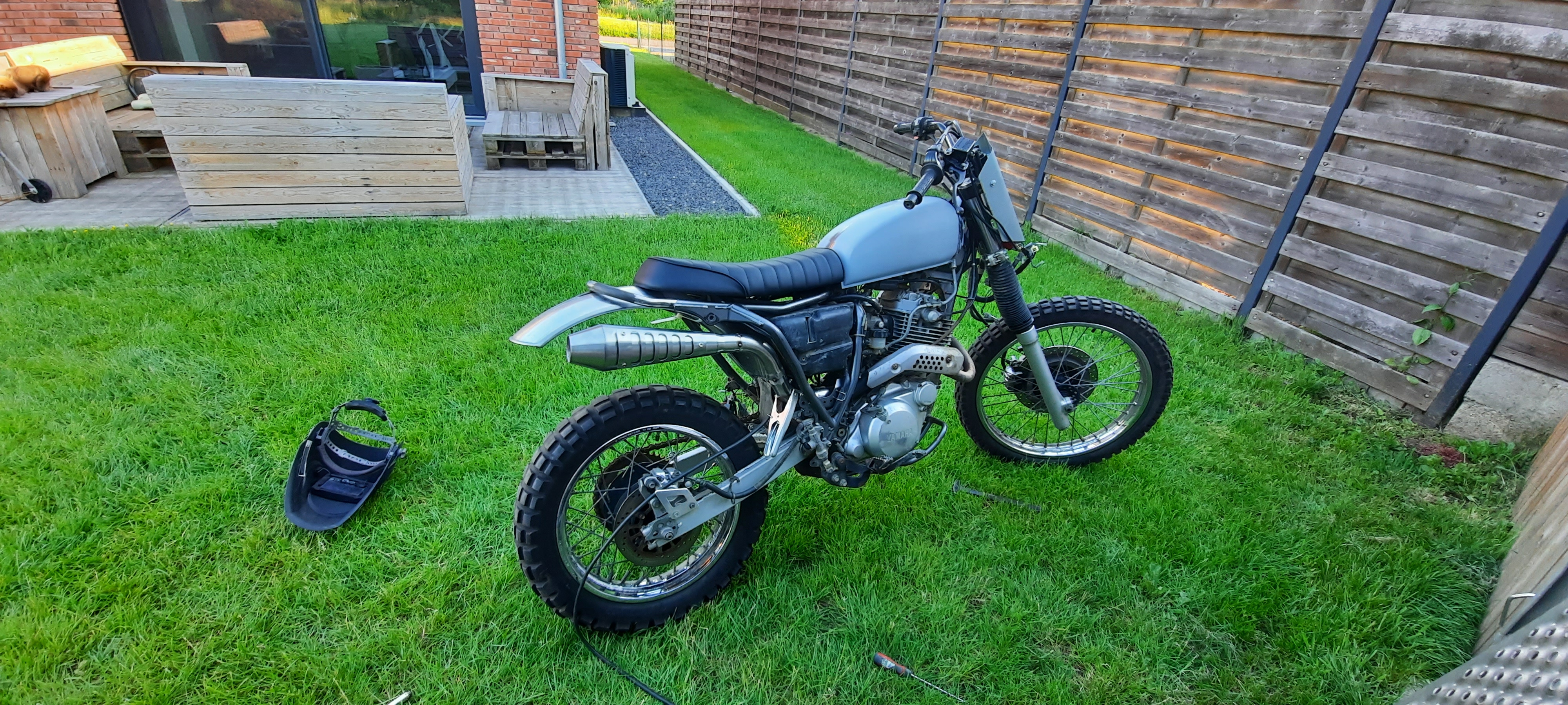

Last few week tried working on the bike after work when life let me. Starting to get there, won't be the most beautiful bike but that was never the intention, function is key here...
The cheap china tank needed some love, especially after the metalwork, a thin skim of filler and a lot of sanding...

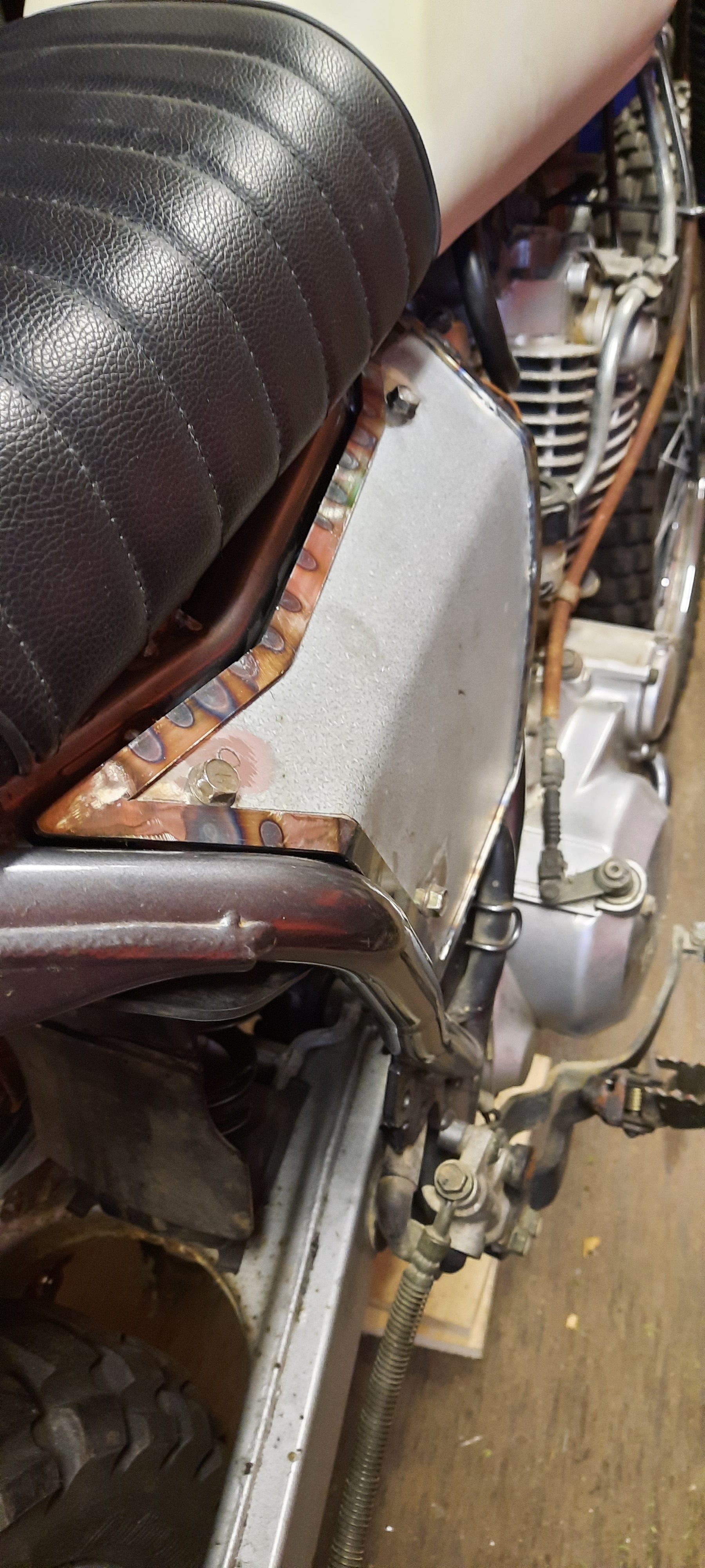

Brackets for the rear fender welded on, exhaust welded up and taillight mocked up. Still need to think of where to mount the licence plate but I'll get there when I get there I guess...
I hope the exhaust won't produce too much heat, otherwise I'll have one droopy indicator...
Exhaust painted and wrapped to avoid melting the airbox.
And I made myself some side covers to tidy it all up.

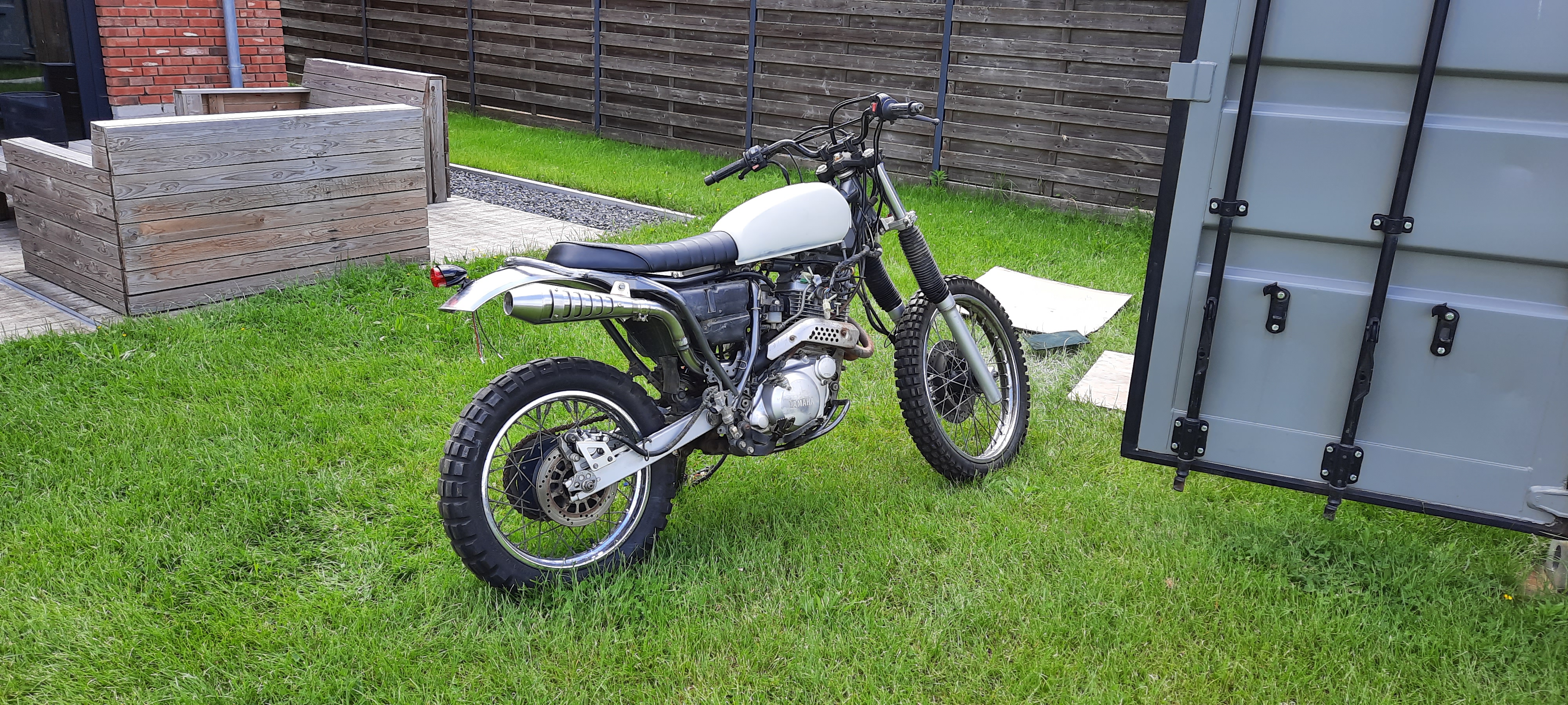

Now thinking about paint/colour schemes for the bike. Would like some kind of vintage looking livery that's not too hard to paint. Something that stands out and goes well with the silver frame paint.
Decisions, decisions....
