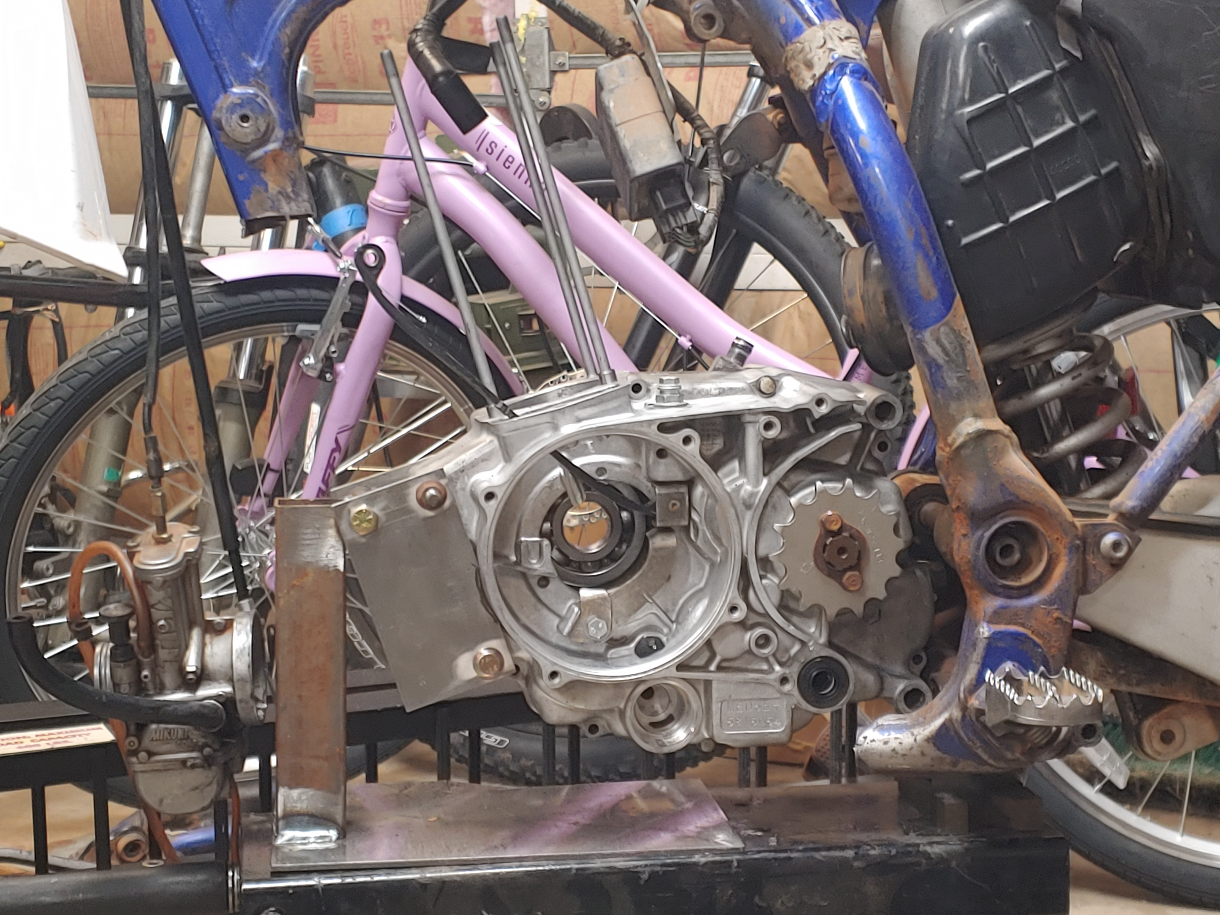

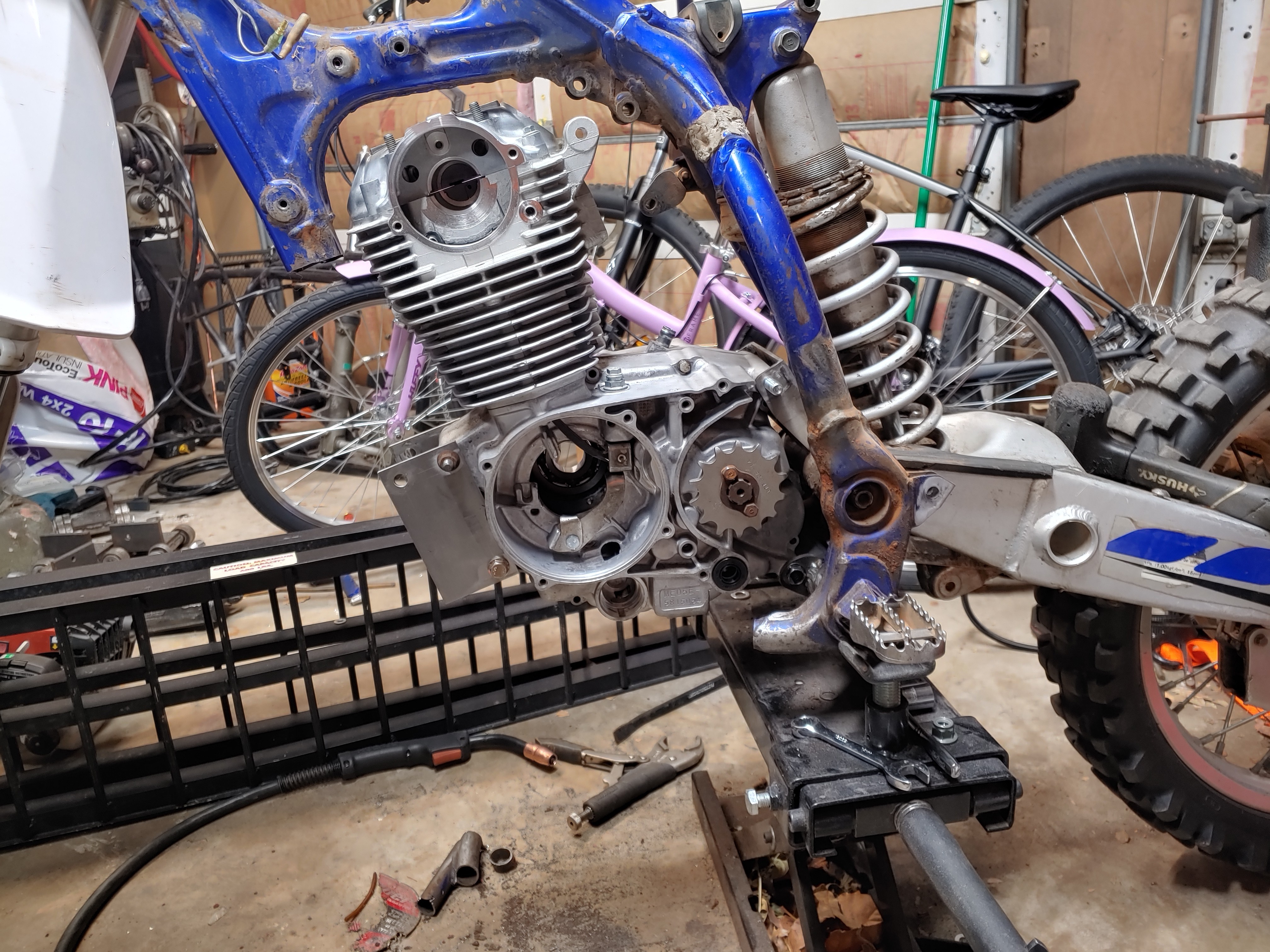

Some slow progress. I think the engine is sitting where I want, made a super basic stand out of scrap to line things up. Cylinder is off getting bored, maybe it'll be ready by spring.

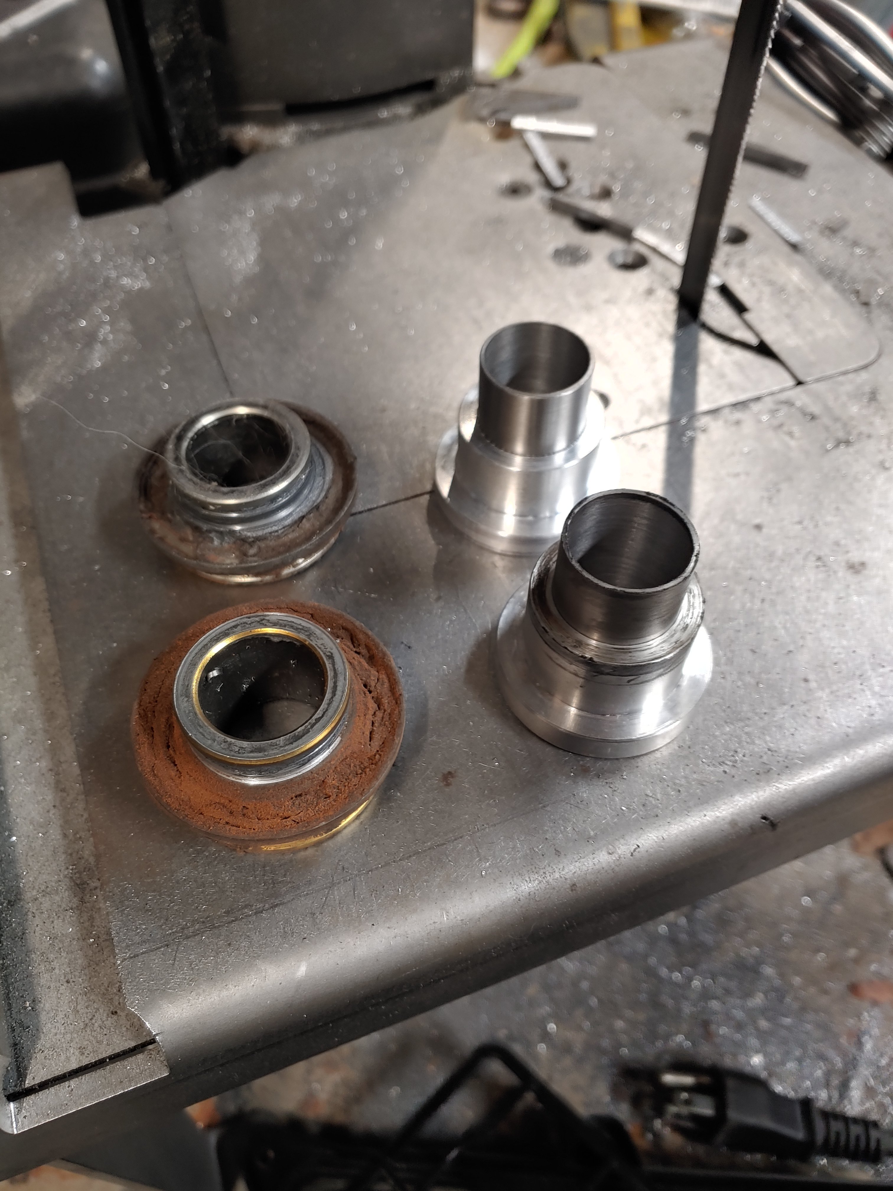

It's a tight fit, but the neck brace clears the head. Tube showed up so next step is to remake the cradle and set up the front mounts.

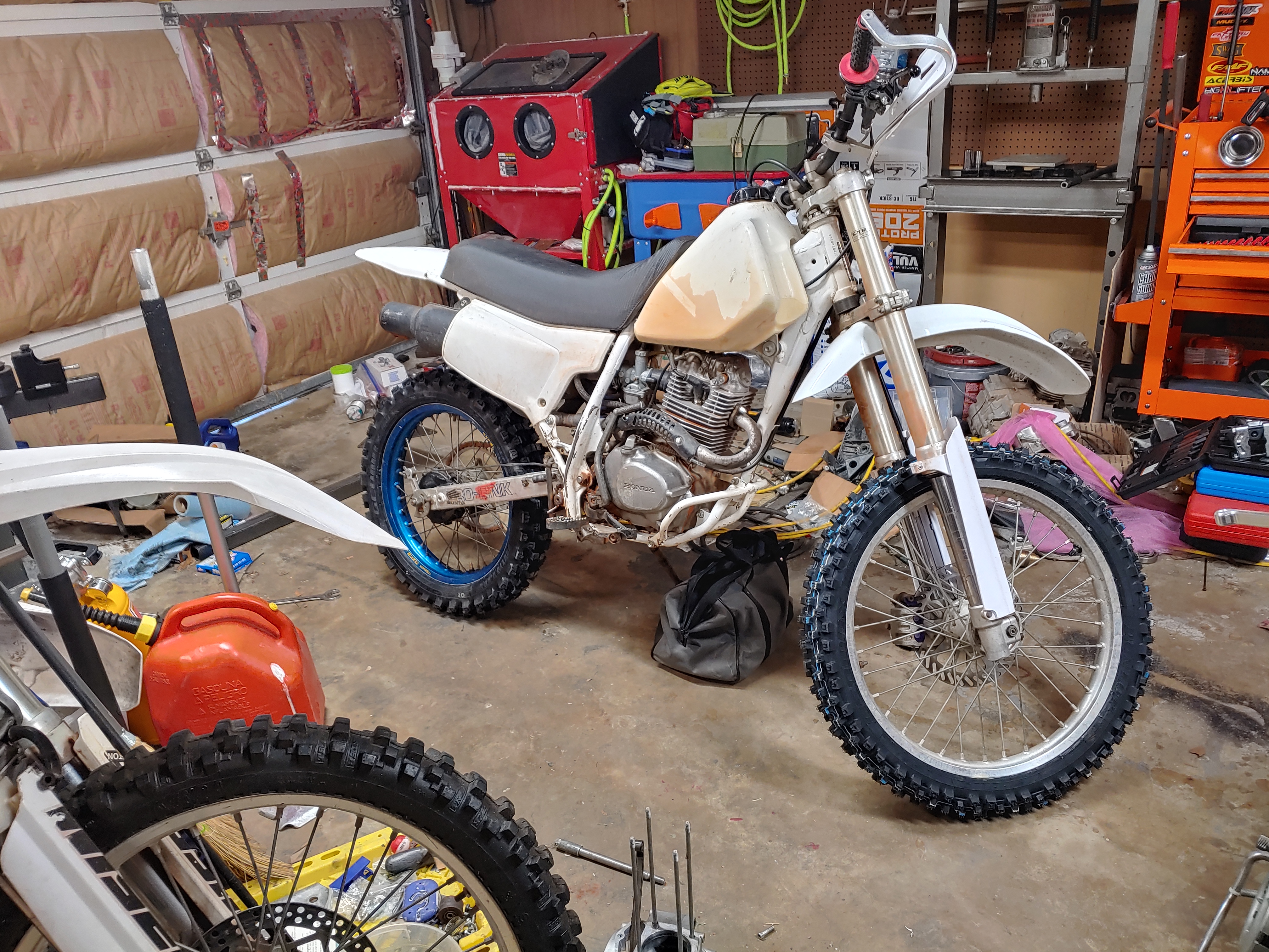

It's been a while but there are updates. Ended up with a stock xr200, swapped better suspension on, and have been riding it.

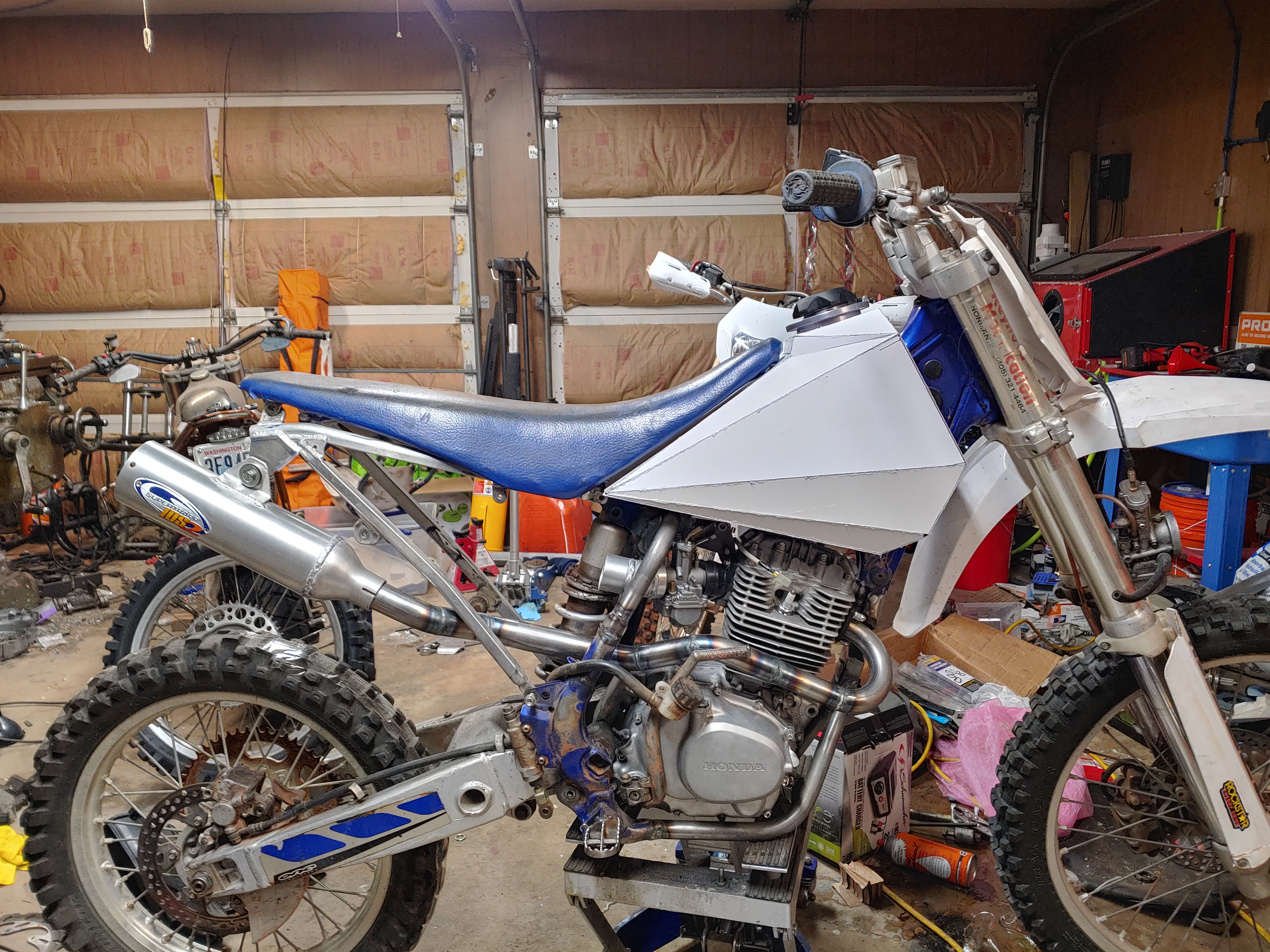

The stroker build has the motor together, and in the yz chassis. Yesterday I built a stepped header for it. Waiting on an intake boot to figure out the intake set up.

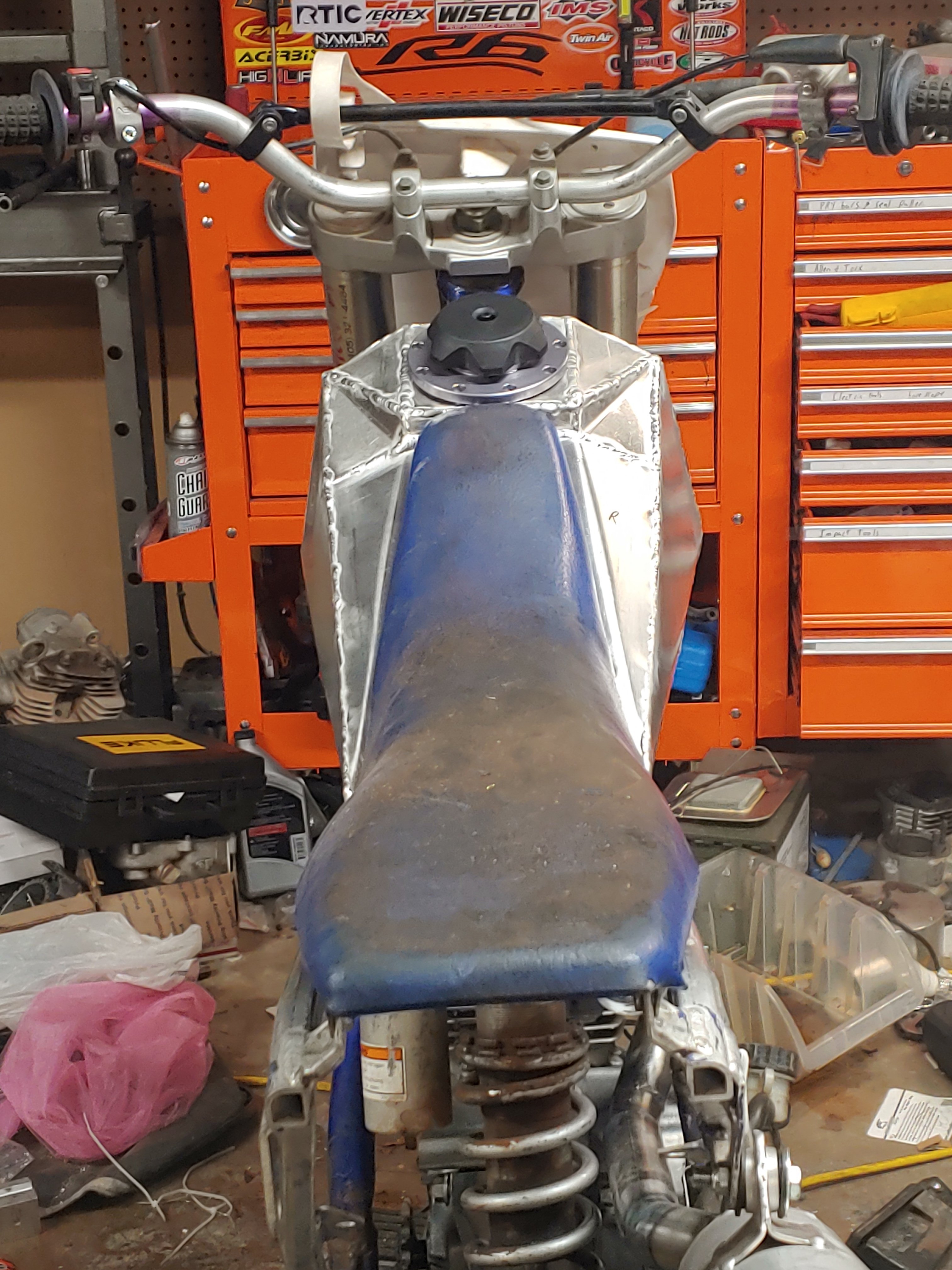

Starting work on the airbox and fuel tank. Gotta make templates to figure out size to get the right size of aluminum sheet.
loving this man. I regret selling my xr200 often. This seems like a best of both worlds project

I've got a stockish xr200 in the background, because I also regretted selling one I had in the past.
The tank is almost ready to test for leaks now. Once that's done I'll mod the airbox to connect to the carb.
Thanks, the tank ended up higher capacity than I was thinking at 3.5 gallons. I think I'm going to put fuel cell foam in it to reduce slosh since it won't hurt capacity.
