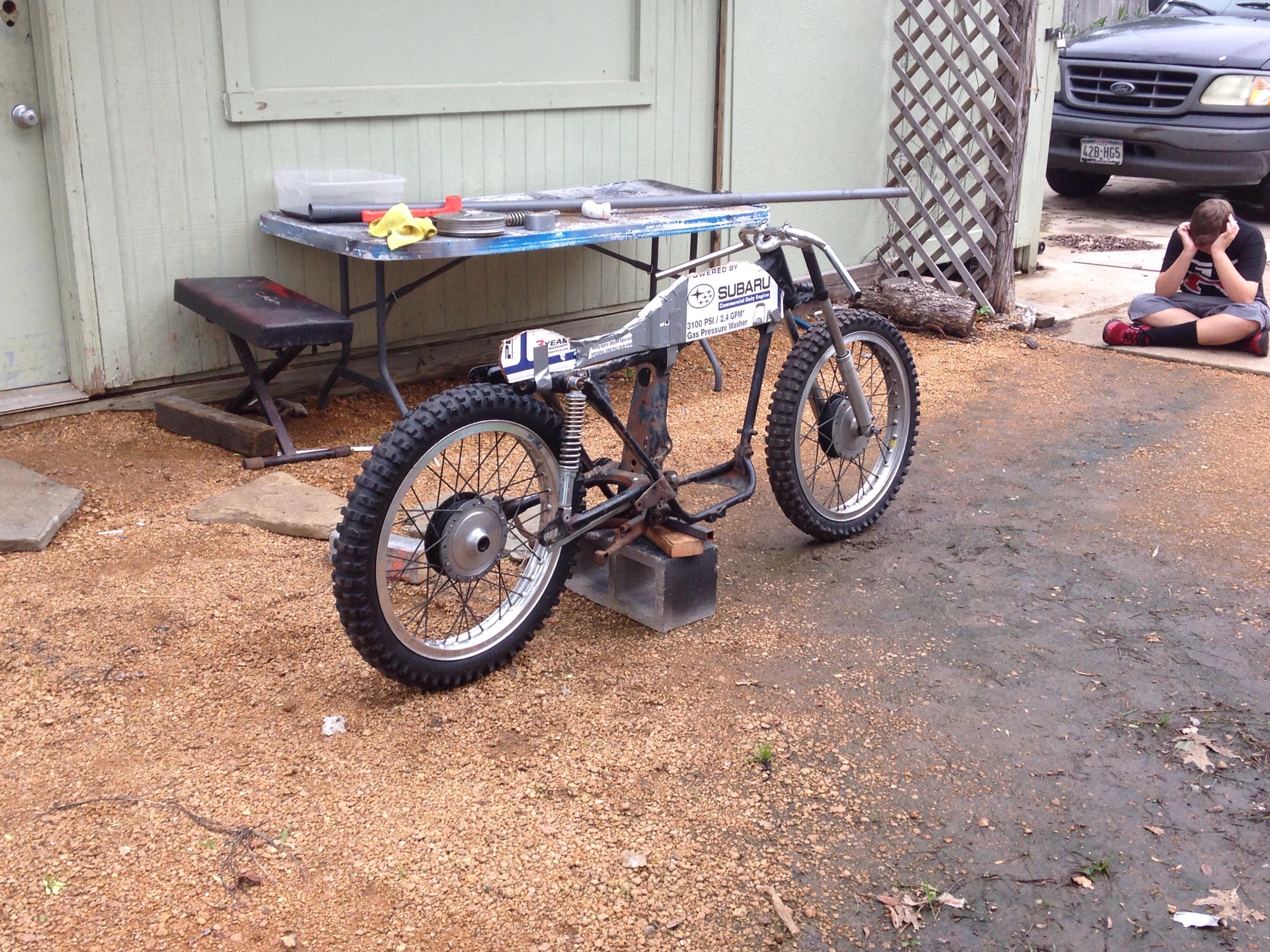

Zeke is at it again. So here are some iterations. 21" wheels

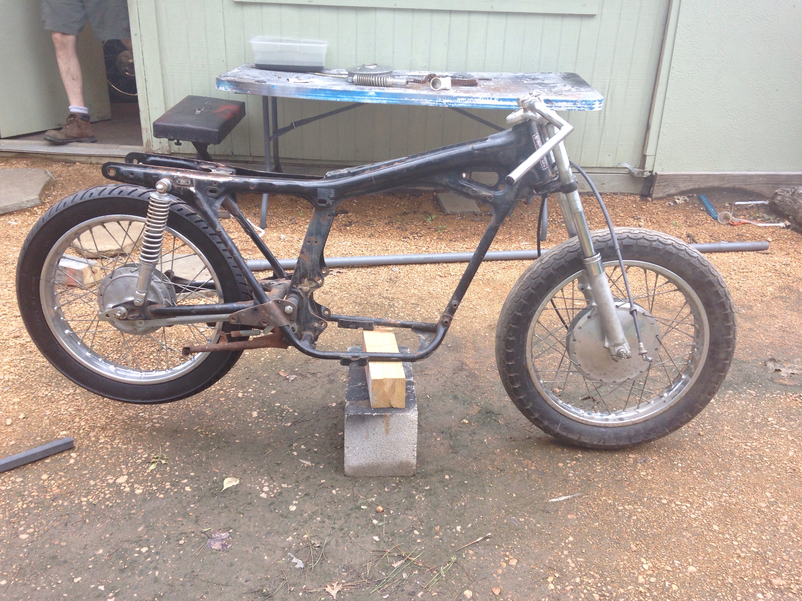

Stretched swing arm mock up

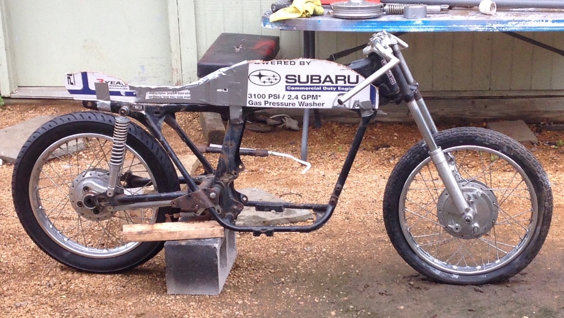

18" wheels

I like the 18" mock up the best..and the additions to the shop are pretty cool ideas too

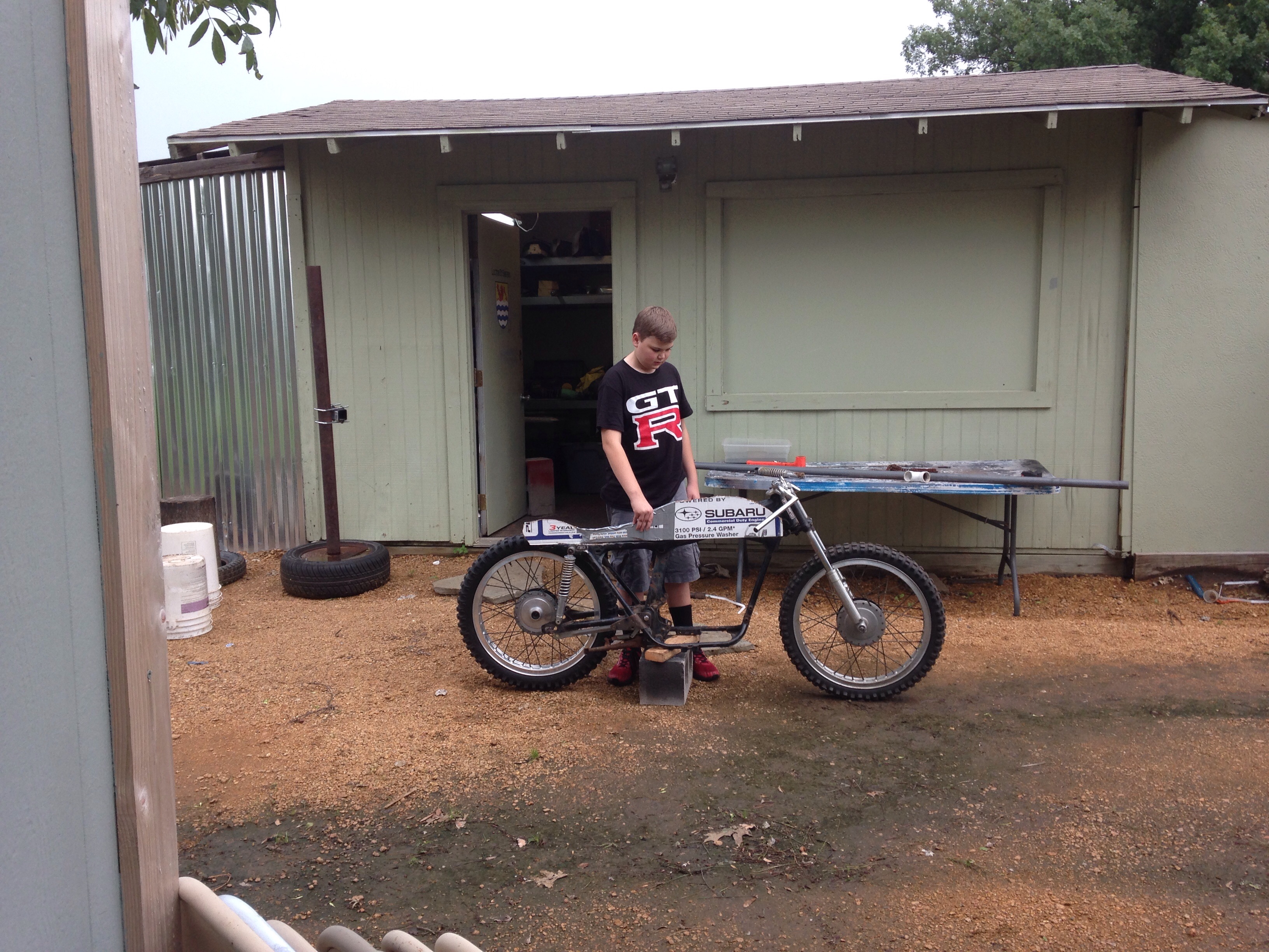

Thanks guys...I really liked the 21's but Zeke HATED them. We are mocking up 19's front and rear tonight. Found this little jewel. Did Akront make a 1.85x19 40 hole?

18 are the way to go. We have a CB450 hub and alloy rim so that must be 40 hole. Can't remember where it came from though. CB160 and CB77 are 36 hole IIRC. Or have I built too many Yamaha TZ and GT750 Suzuki 36 hole wheels and lost track of what fits what?
