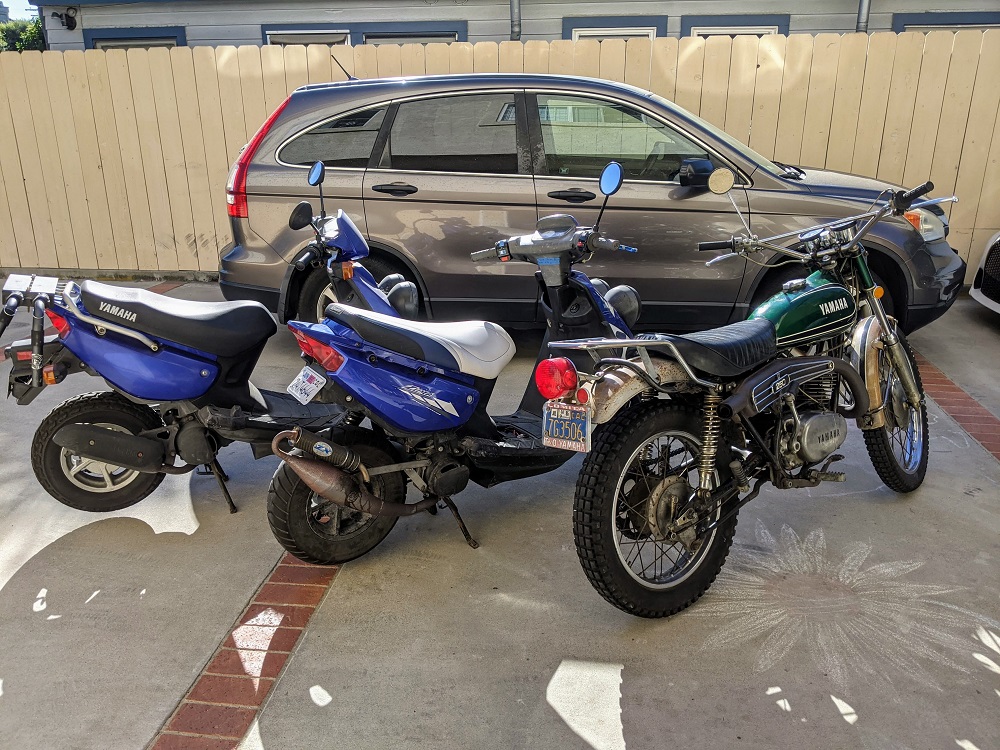

(the middle scoot is the one we're talking about in this thread. See 'Yamaha DT3 - Small Garage, Large Ambition" in Projects -> Trackers , for the DT3 build.)

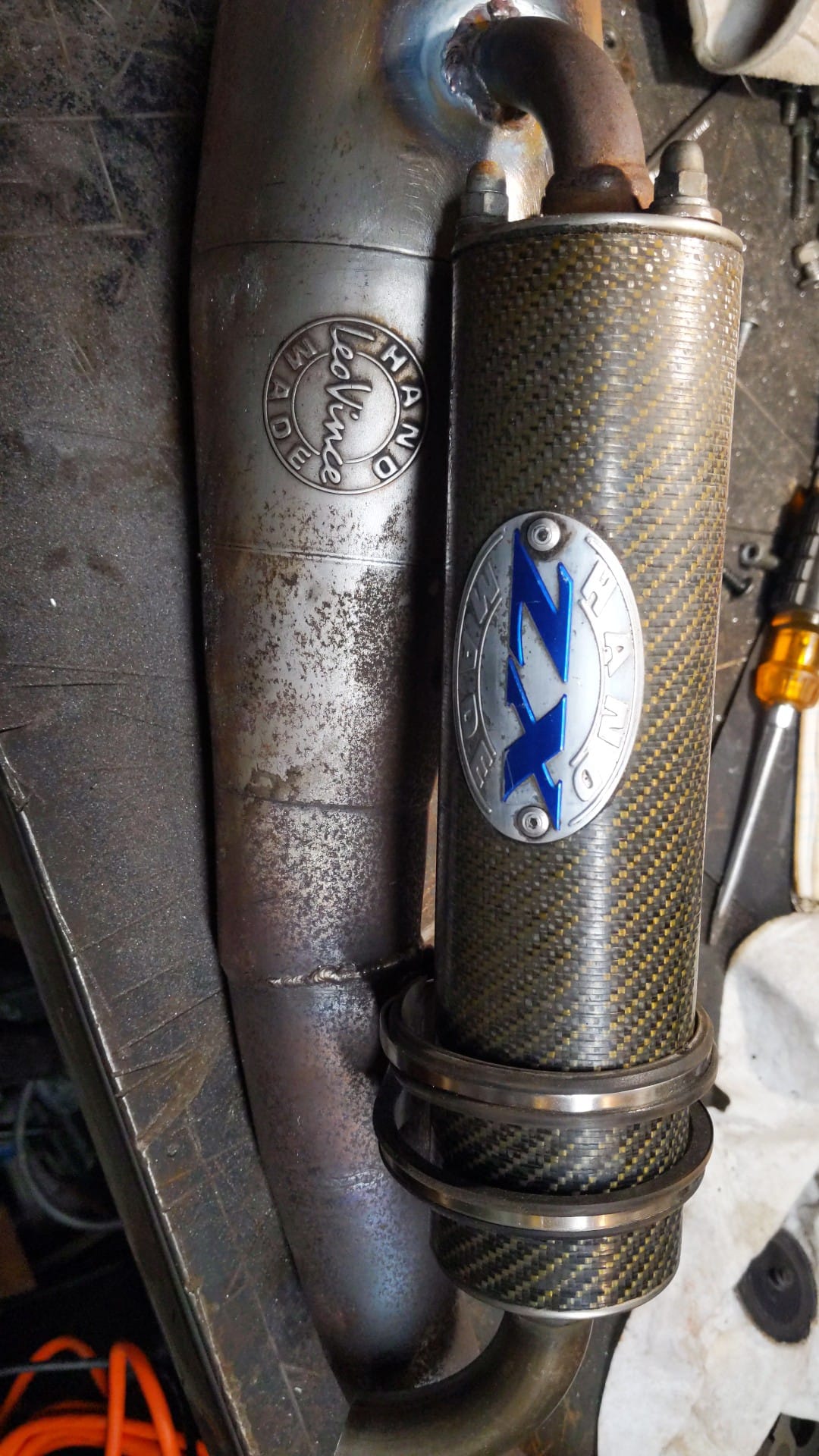

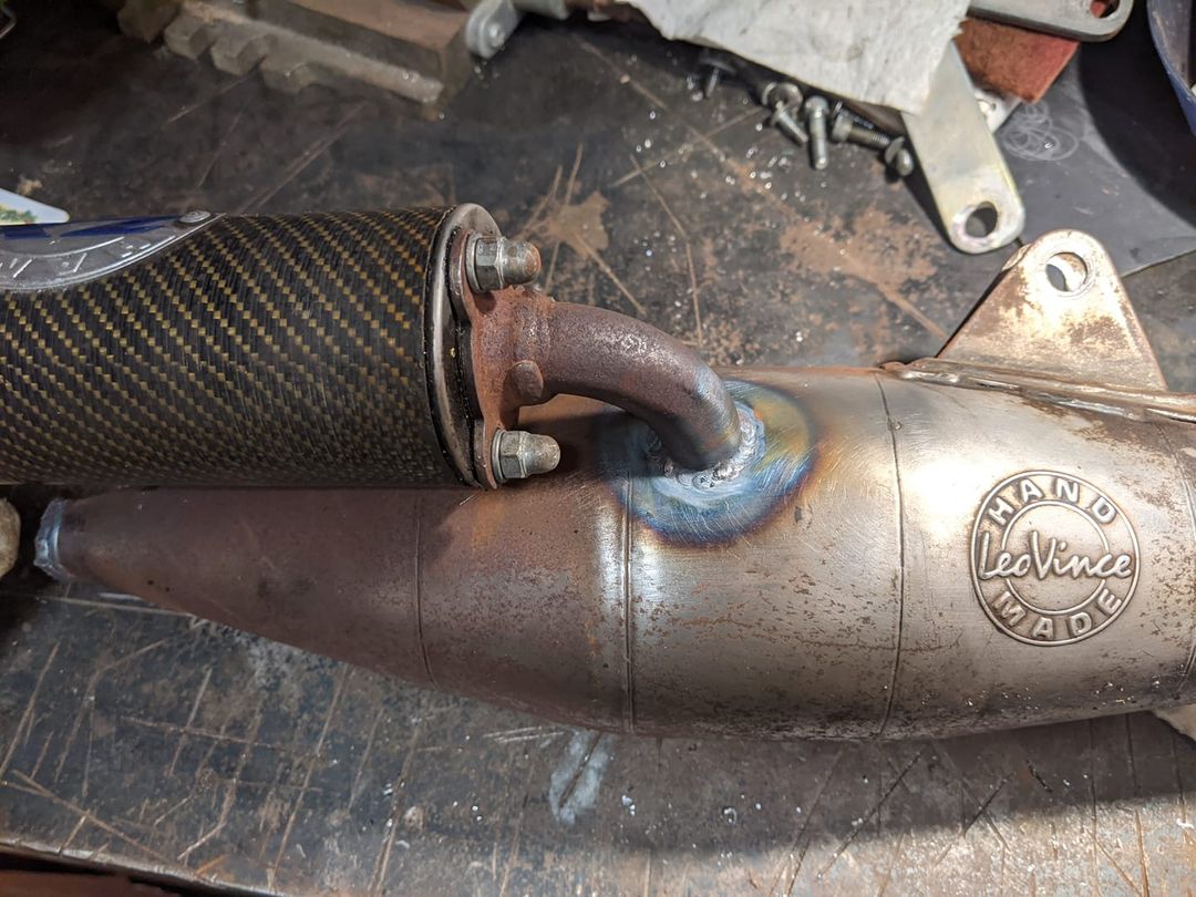

First attempt at the idea of a 'side bleed' exhaust. I modified the LeoVince ZX it came with. Tested the concept-> Worked well -> Improved later for packaging
Same concept, just moved silencer around 180 for better packaging
Cleaned it up with some better paint:

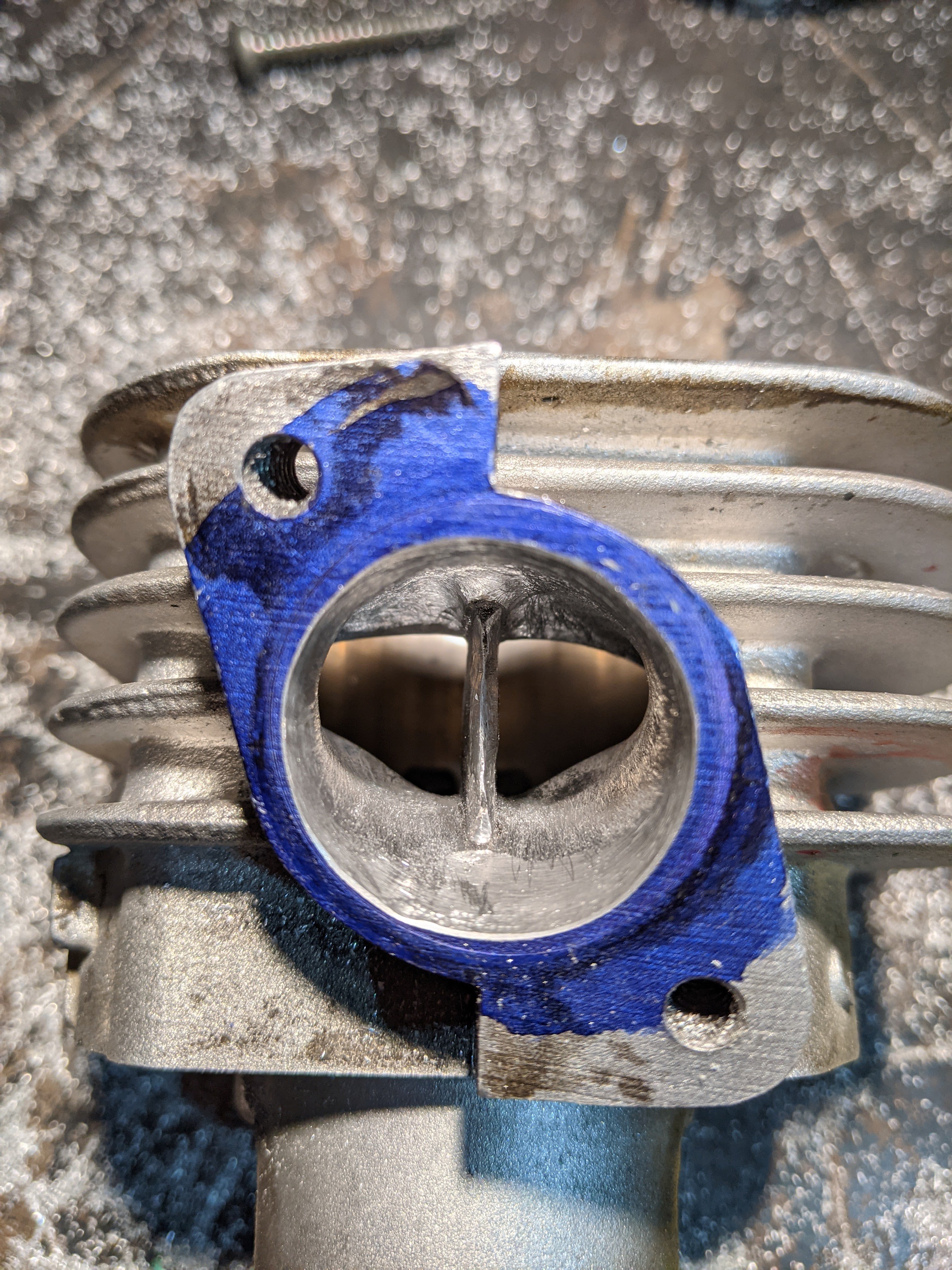

Started looking to open her up and found a number of areas for improvement. I started with a general clean-up of the cylinder ports and de-restricted the intake boot. That help marginally, so I knew the pipe was holding me back. Following Alexander Bell's book, I opted to build my own exhaust (really to help dial in my ideas and execution before the DT3 pipe), and I learned a ton along the way. I also opened up the exhaust port more to help match the new pipe.
Before:
After:
Before:
After:

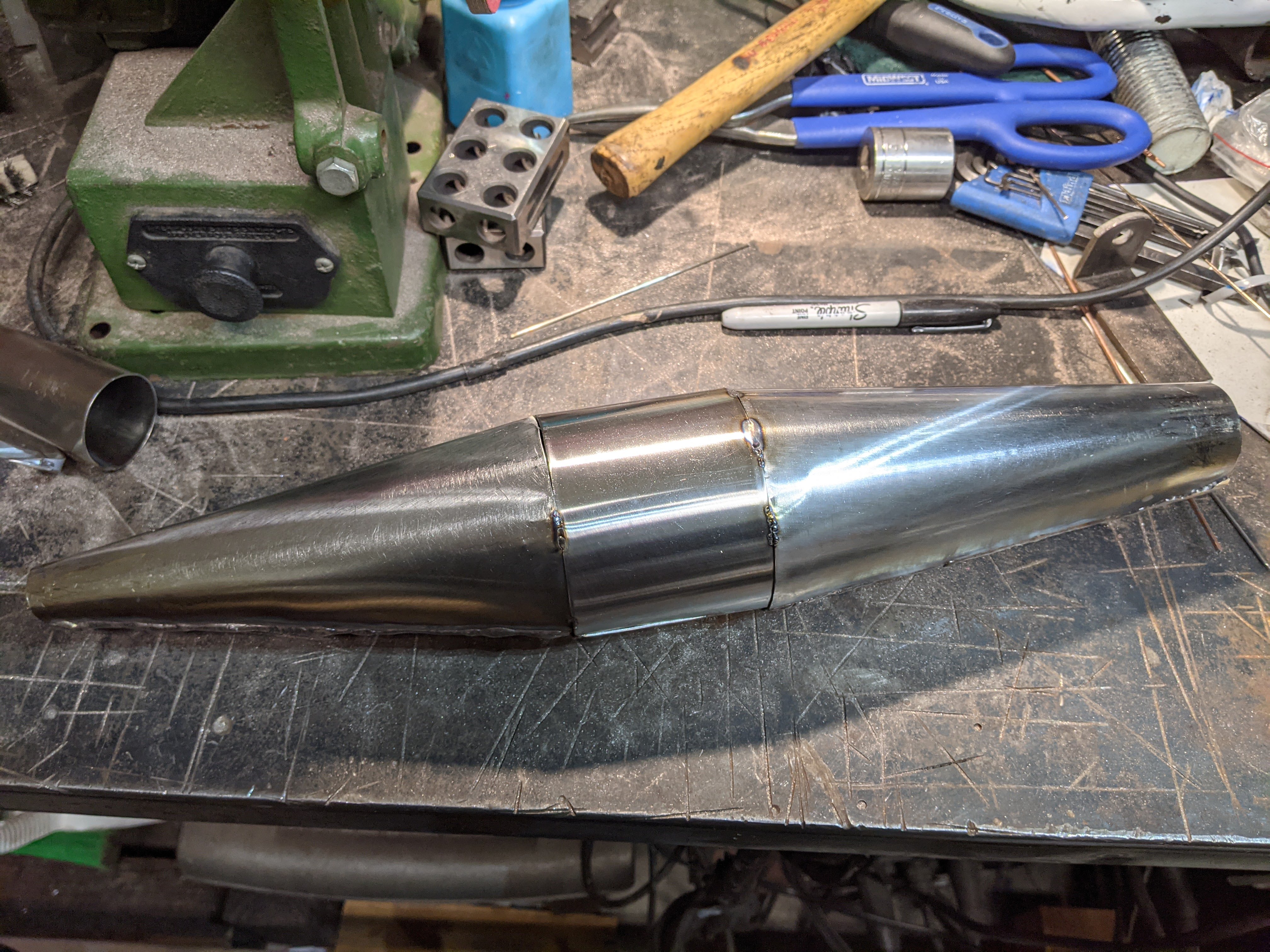

I've learned some things as I tried this attempt with silicon bronze.
1.) Slip rollers can make partial cones - but it's a mutha f**ka to get a tight radius cone on 1 end and large on the other. (1" roller targeting 1.5" semi closure is about all I'd expect)
2.) Silicon bronze is not for butt welding. Period.
2.1.) Silicon bronze is man's best friend one moment, then turns around and shits on your carpet the next
3.) A friend, Mitch Nunes advice: - filler diameter should be close to the thickness you're welding. I used to think this was 'nice to have' but more and more I'm realizing I've been using whatever I had at the ready and it's been doing me dirty.
3.1) 20ga stainless but welds rather nice on a tig machine using .023 mig wire, (20amps, .7 PPSwith)
4.) The tuning book I have is recommends you cut one side and add to the other for bends, but you don't change the centerline distance. The hell with that business - too much unnecessary work. Instead, it's better to spend the time to figure out how much angle and how many cuts you need, then just add the cut material to the start length and make a single cut on an angle, then rotate the pieces to get the desired affect.
5.) Limited patience shows in parenting and quality of weld.
All this comes on the heals of trying to determine how I want to build the pipe for my DT3 Yamaha. I figured I'd use the scooter for testing all sorts of stuff, so I set out to design and build the exhaust for that first.
The DT3 color scheme will end up navy and gold, with the same design(esq) as the factory paint. I wanted to get more of a gold accent on pieces of the pipe, but it's apparent that isn't in the cards. The bronze just isn't the way to do pipes past the header flange. Lesson learned.
In 2-stroke pipe building, some aspect are easier than expected, others are harder. Getting the header cuts to hit the angles I wanted were actually pretty easy. Getting a cone to taper 6.5 deg on a 3-roll slip roller is not.
Pipe calcs (note; calculation does not equal execution. I lost some volume and length in fabrication. Target RPM may not match what I was hoping for...oops)
Cylinder exhaust port exit / header entrace dia: 30mm; As built = match
Header: 1.5 deg expansion, 42mm exit; As built = match
Diffuser: (single stage): Entrance = 42mm, ID = 90mm, Taper = 6.5 deg, Length= 210mm - A built was slightly shorter, slightly smaller exit OD
*Note* this was targeting an expansion factor of 3. That's on the high-side per Bell's book. Ended up smaller at ~83mm , which is still a 2.7 expansion factor for a 30mm exhaust inlet (Bell: 2.5-2.8 is typical, 2.9-3.1 if room allows)
Parallel section: Designed ID 90mm; As built = 83mm
Baffle: 10.5 deg, Exit ID 19mm; As built = match
Stinger: 17-19mm ID, 100-205mm long ; As built = 17.5 ID, Length TBD

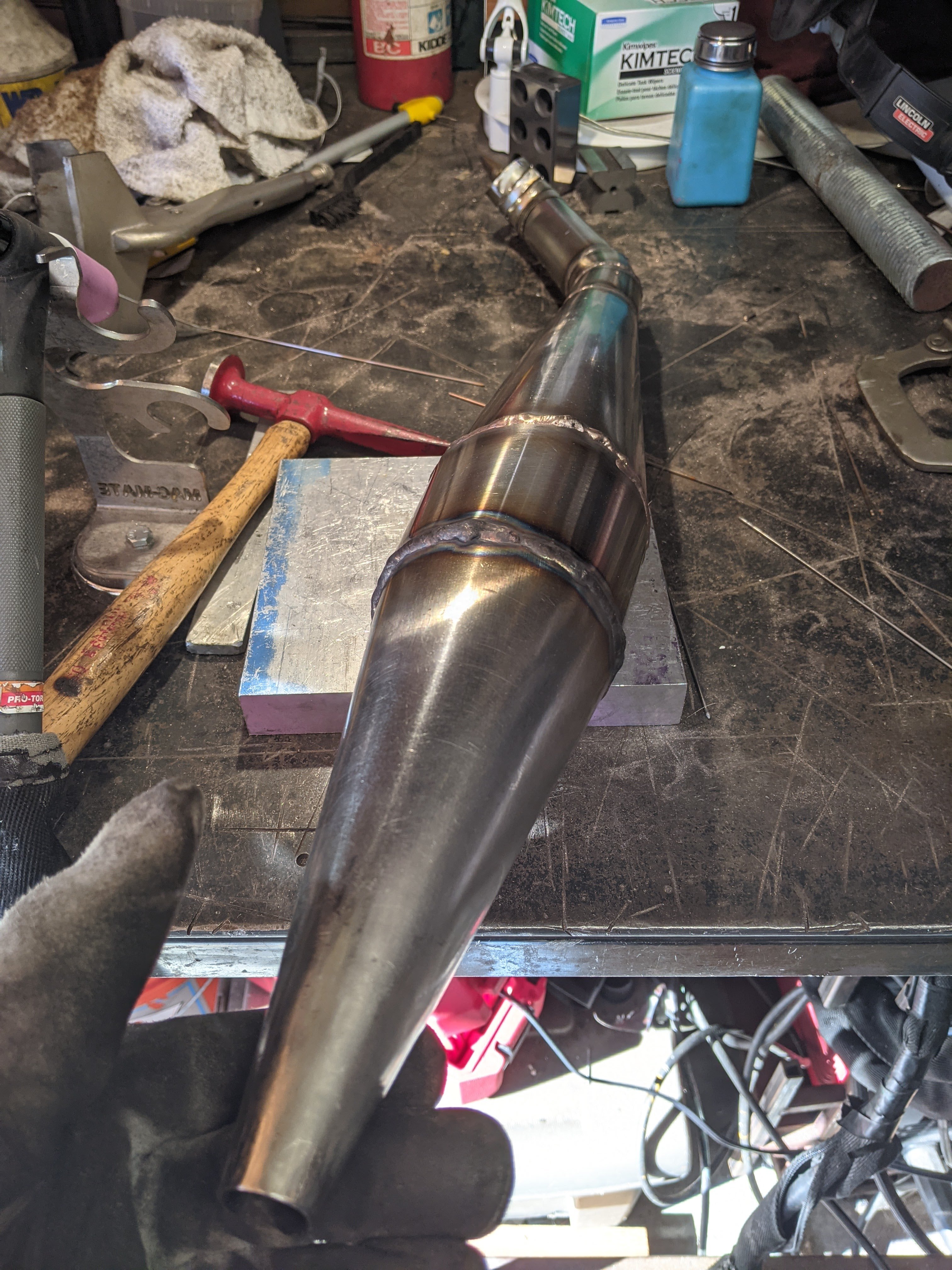

Bell's calculations are a great place to start. To get the curve in a tapered header, it is much easier to use cone generating software and cut the cone into sections which can be rotated to get the desired shape. Better to roll them with a slip roll to make the sections, but if you are careful, you shouldn't lose much length (if any).
This pipe came as a set of rolled but not welded cones that had to be sectioned and rotated. I decided on the angle and how many sections and printed out the sections for each cone, then cut them as carefully as possible and then hot glued it all together. The first few inches were what was left of a set of TZ pipes that were junk except for the flanges.

Exhaust is getting close to finish.
Quickly adapted the original silencer I had and did a clearance check. Should be able to fire it up today!
I never updated this!?!
That pipe was aweful. The peak RPM was WAAAY too high and as a result, I couldn't get the engine to climb into it's useable RPM range...it just didn't have the torque to get there. The next iteration of the pipe will be a bit larger diameter in the belly, shorter/sharper on the reflecting cone, and similar on the expansion cone. In the meantime, I put the leovince zx pipe back on an tuned it for a good time.
