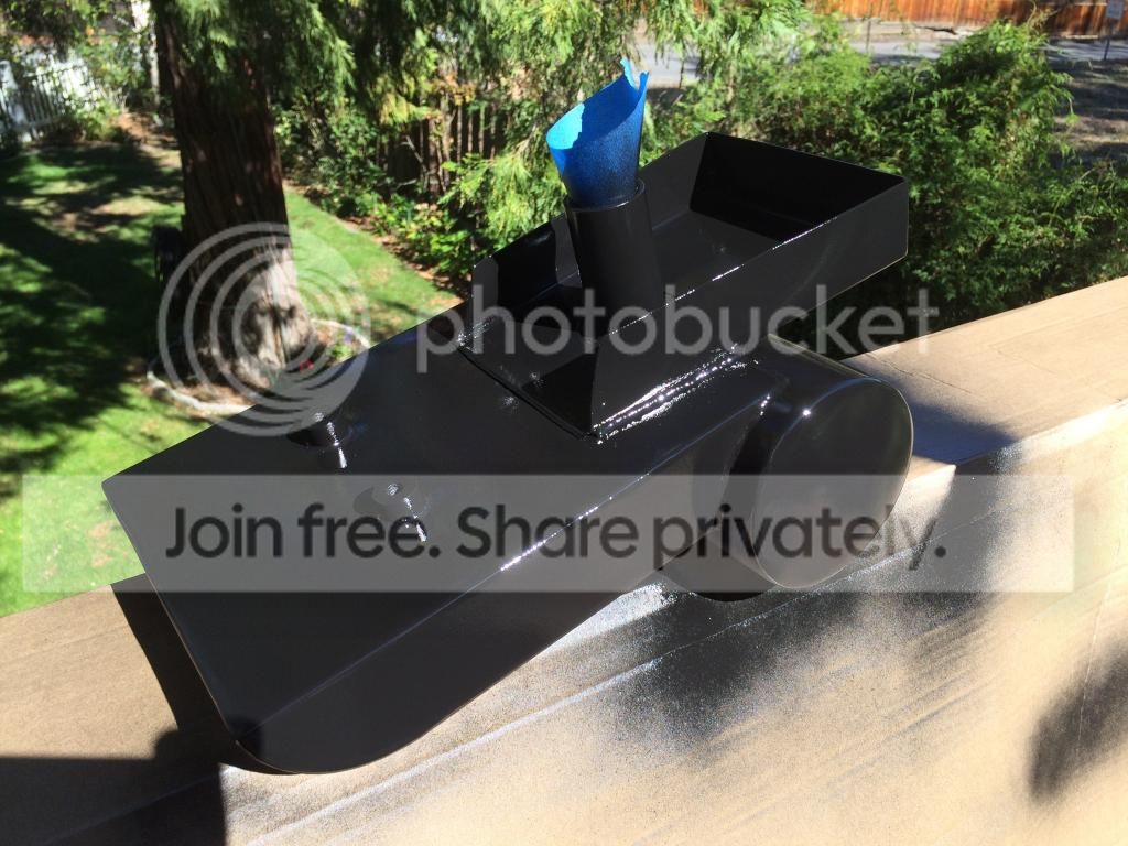

I talked to Curt Owen (http://www.anythinggoes74.com/About.html) who fabricated the very cool oil tank who advised me that the exit thread of his tank is likely 1/8" NPT. Any suggestions regarding where to get an oil line that will screw in to the 1/8" NPT on one end and connect to my stock oil intake on the engine would be most appreciated. I've got my Loctite out and am getting ready to start finalizing all accessories and components. I'm getting all the electrical locations finalized as well so I can get a schematic figured out for connecting the new electronic ignition to all components.

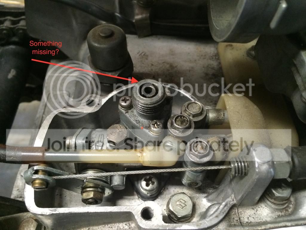

I'm pretty sure the "something missing" item is the tachometer connection. Since I will not be running a mechanical tach, should I cap this off?

Nice project! Yes that is the tach connection coming up through the oil pump. Not quite sure what you are trying to do with that one new oil line is it going to go from the oil tank to the pump?

Thanks! Do I need to cap off the tach take off? Any idea where such a cap might be found? Sorry about all the newbie questions. Yes, I'm planning to either cut and connect to existing oil line of preferably purchase a custom line with the stock Suzuki style fitting at the oil pump end and a .125 NPT fitting on the other. Something like 18" or so would work perfect. That item and a short clutch cable that will bolt up to my clip on bars are my only snags at this time.

The oil tank is lookin' good with a coat of paint on it.
I am thinking you could get an oil line made at a hose shop. The one in the link below advertises custom hoses while you wait. I would take the tank and the old line to show them and maybe even that picture of the old line connected to the pump just to avoid errors. Hope this helps. http://www.hoseandfittingsetc.com/hose-assemblies-while-you-wait/?utm_campaign=MS-HydraulicHoses&utm_source=Yahoo

It's not essential to cap off the tacho drive, unless for cosmetic purposes, and on extending the oil line.....we have done just that, cut it, insert a piece, and use the original ends. Works fine. On the jetting...I increased the main jets from 97.5 to 115, and went for 2 sizes up on the pilots in my own bike, and it runs good without melting anything. Mikuni jets are readily available on-line easily......ps, thank you for the high praise on our pipes...glad you like them !
Thanks guys. It's really coming together nicely. I still need a shortened clutch cable but I'm ready to blaze ahead on ordering some new jets and finalize the oil connect. I'll go with cutting the old oil line about an inch from the pump cover and clamp a new line over the O.D. of the old line. Some line with stainless steel braid would be a good choice. Looks like I can get it made locally.

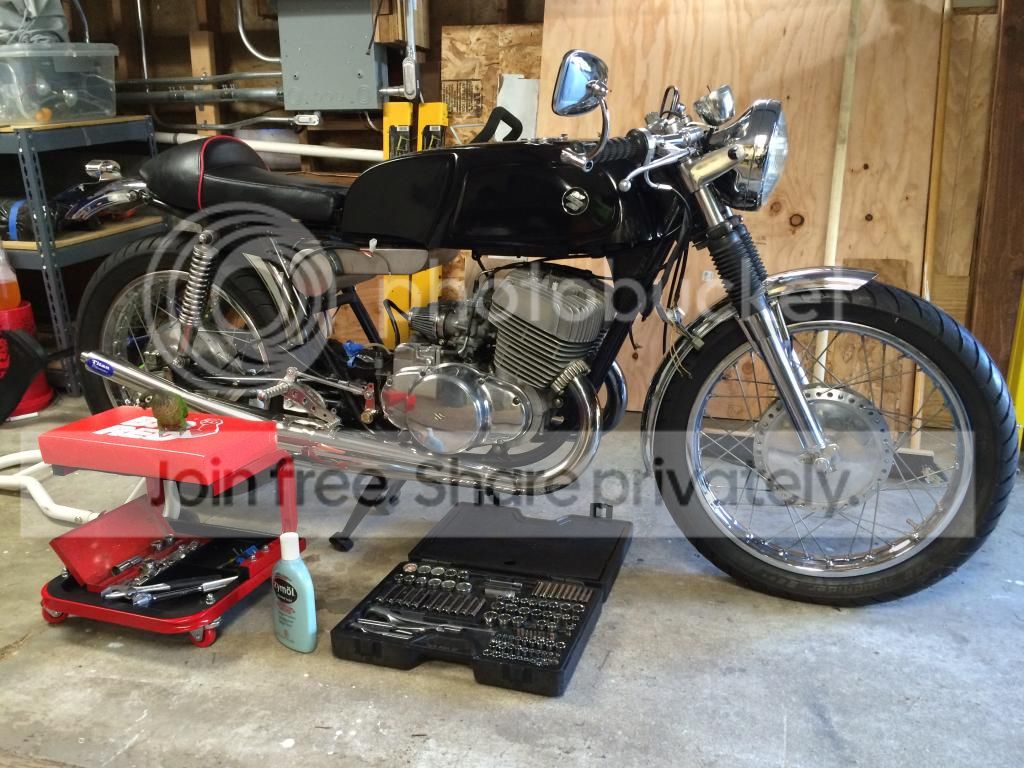

Will do Brad. I'm hot to get the major components into their final locations this week and post some more pics. I'm pulling the carbs and replacing the main and pilot jets as Titan Performance crew suggests. It's been 42 years since I kicked over a two stroke of my own!
Last night I found a new clutch cable in the box that Reddy gave me with the bike. It hooked up and works perfect. Wow, that clutch is a bit of a bear. My guess is that with some use it will loosen some. I love the double shoe drum brakes in the front. They are in excellent condition and the wheels just look fabulous. I wonderful mix of new and old on this one.

Got Oil! Got my new oil line today. Fit perfect! The Parker Store in Fremont, CA did a great job for a fair price.

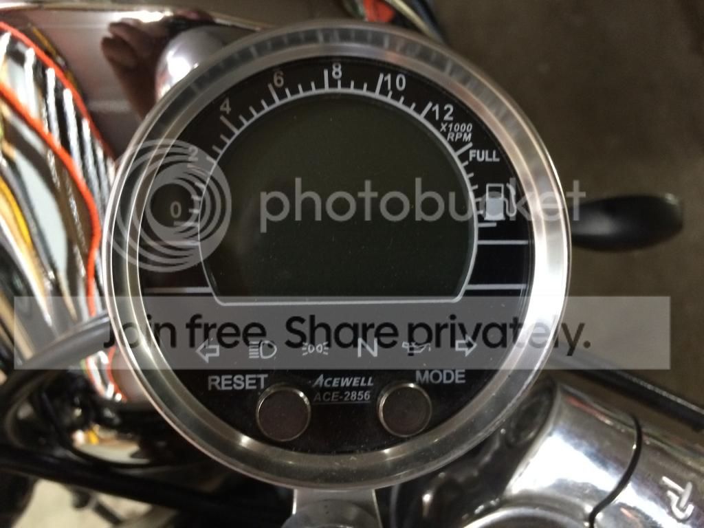

Also, This speedo is pretty hot.....Edit update: Got a line on a "Spoke magnet" that will work in the absence of a disc to mount it to.
