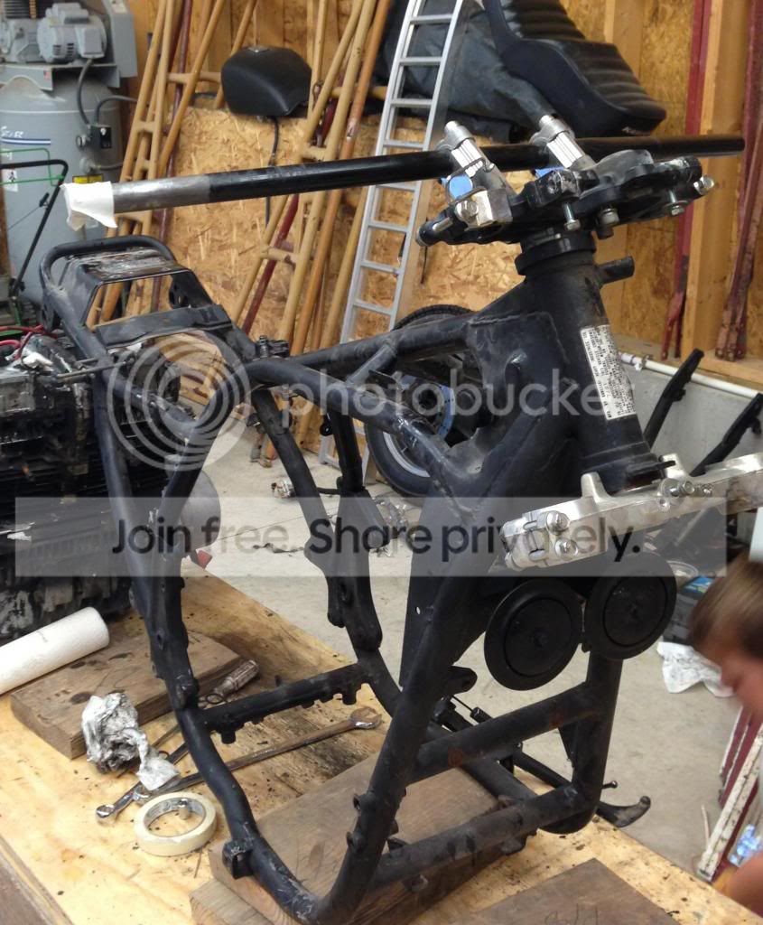

Wed. i got home and ate and rolled the bike onto the lift.
after about 4 hrs and lots of sweat, heres what i have.
I have some parts and am waiting on some to come. Lots of cleaning and polishing to do.
With that tubing welded to the shift lever, you are going to burn up
some shift forks in short order. Just telling ya you'll be scratching
up that new paint in a couple months when you have to pull the engine
and split the cases.
