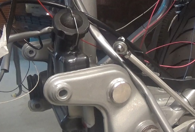

For anyone who cares.
Here is the bike, my own personal hunk of junk,  pretty much in its final form. I would still like to build a better exhaust but this will do for now. This thing is actually pretty quick on the back roads! It's a blast to ride. It is not pretty by no means, but it is certainly an accomplishment.
In the first photo of me riding down the drive way, you see me.. a happy individual going to terrorize the gravel roads.
In the second photo, you see me, a dog tired individual pushing a 300lb motorcycle up a 3000ft driveway to the farm (distance, not elevation) after pushing down said gravel roads because I forgot to check fuel levels. And we don't have cell service in the middle of nowhere TN.
Note that the second two photos were taken by the driveway security cameras, which promptly sends every photo to my brothers, both of which quickly laughed at me.

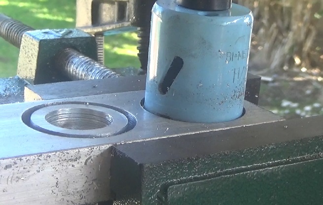

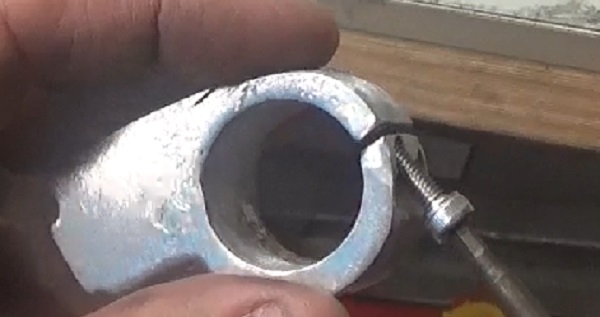

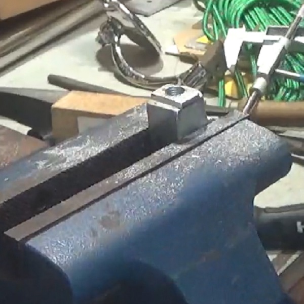

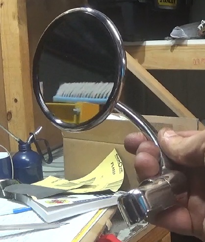

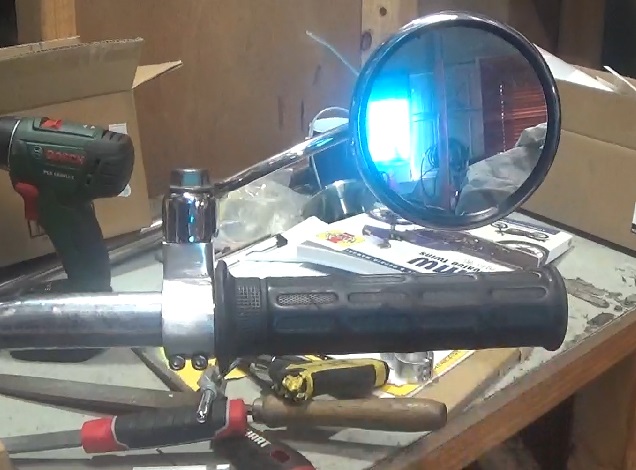

Had some Halcyon 830 mirrors on the Triumph, which I removed when I sold it. I really want to fit them on the CX500 but...
...they are designed to be fitted inside the handle bar via the usual bar end arrangement. I have some turn signals inside the bar end so I can't fit the mirrors in the conventional way. I decided to make a bracket to mount them on the bars from a 20mm block of aluminium.....
A 10mm threaded hole to mount the mirror...
...and 2 x M4 threded holes with a slit to tighten around bar.
Mounted on my spare handlebar and everything works. I like these mirrors. Just need to fill in small voids, finish sanding, and paint black to match everything else.

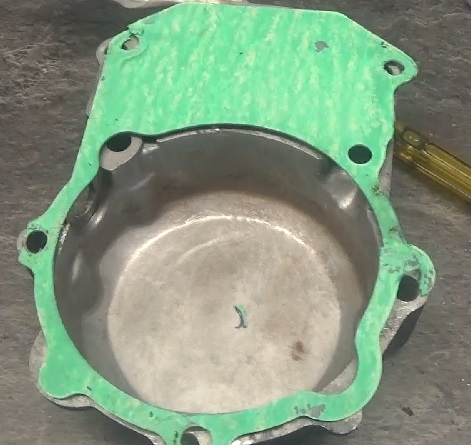

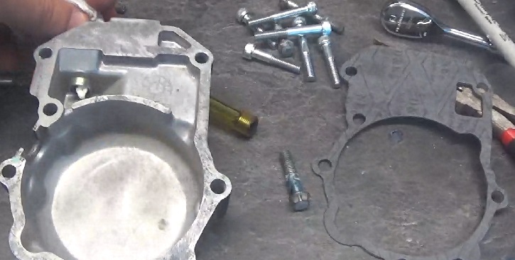

Was going to have an aluminium water bottle for overflow, but changed my mind and decided to replace the original specimen bottle. Had to pull engine out....
....and while I was there, I replaced the pulser cover gasket after a youtuber commented that the one I had placed did not have the slot for the breather vent.
Now it does. Engine back on.
