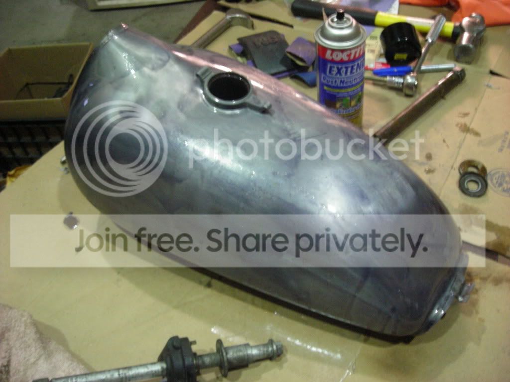

Here are pictures of the tank in various states of bondo and prepwork. Going to prime tomorrow, and hopefully paint shortly after.
Tank, right after being stripped of paint
http://s870.photobucket.com/albums/ab263/MatthewPMenze/cafe%20racer/?action=view&current=DSCN0325.jpg
What I stopped at tonight - will prime tomorrow
http://s870.photobucket.com/albums/ab263/MatthewPMenze/cafe%20racer/?action=view&current=DSCN0331.jpg
-matt

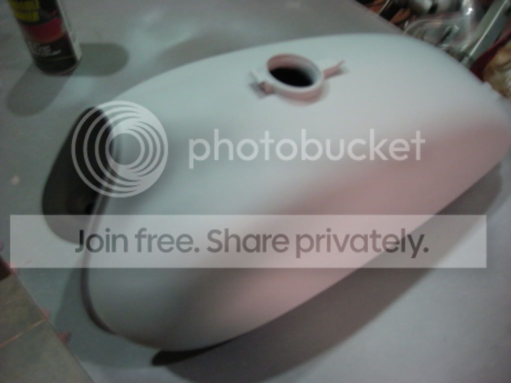

I just finished priming the tank, it turned out pretty nice...Still a few imperfections, but I think they are small enough that I am the only person who would really notice them. At any rate, I will probably eventually get a different tank, to better match the lines of the rest of the bike.
Tell me what you think:
I'll probably start painting soon, so I will have those pictures up soon.
Re: An Introduction, and a Motorcycle - Gas tank is finished priming - picture
Before you paint. hit it with one light coat of a different darker color primer then wet sand that with 1000 grit and use a soft block (a sanding sponge wrapped with the 1000 grit will work) sand it until you start to see the lighter primer come through in spots but don't necessarily sand it all the way off. This will give you a really smooth and even primer surface for the paint to go over. it only takes another 20 minutes or so and will make a big difference.
That's a good idea, I really wish I would have thought of that before I had bought my paint supplies. Oh well, I will see what I can get like this, and if it doesn't turn out well enough, I will go buy more supplies and do it that method.
Definitely do that on the next thing I paint - Thanks for the pointer.
-Matt
You can still do it. Just shoot a mist coat of your paint color and do the same thing.
Hmm, I might give that a try then. I suppose I just need to let it dry to the touch, not cure or anything, since I will be sanding it off?
-matt
You use the darker primer as a "guide coat" it will show any imperfections in your body work and will allow for a nice even finish. Your bike should be pretty cool I wish I had a stock pile of parts and tools to build with at your age. It took me 17 years to get to the point of building a bike. Albeit I was too busy riding the crap out of my mx bikes to even think about another bike. But my kid will be able to build himself a hell of a bike when he wants to.
Yeah, I am real lucky my dad was insane with his bikes. Makes it a lot easier, plus I have his massive knowledge base to work off of. You should see his bike, he designed so many different things for it, for a while he was talking with Eric Buell about a few of his designs for brake rotors, and had a chance to get his bike in motorcyclist magazine, but he never quite finished the fuel injection system he made for it (he made it back in the late 80s, early 90s) but he couldn't get a good enough ecu to drive the system, along with some issues he never fully resolved with the intake manifold/throttle bodies he built. Freaked out a lot of people with his bike though, to this day, older people read my name of my debit card at a store, and will ask about his bike.
Now he says I can have his old gsxr, but frankly I am scared to drive it, so that's why I am building this, to learn with.
Anyways, I wet sanded the tank without a guide coat (place was reaking way to much of paint fumes and I was getting light headed, and it's way to cold outside to open a door) so instead I methodically sanded it by feel with 2000 grit, and it turned out pretty nice, except for one little spot I went though, but I sprayed over that, and will give it a final wet sanding in about a half hour. Whole thing is glass smooth, and I can't see any imperfections with the flat grey primer, so I am assuming that the flat black topcoat will look as close to perfect as I am going to get.
