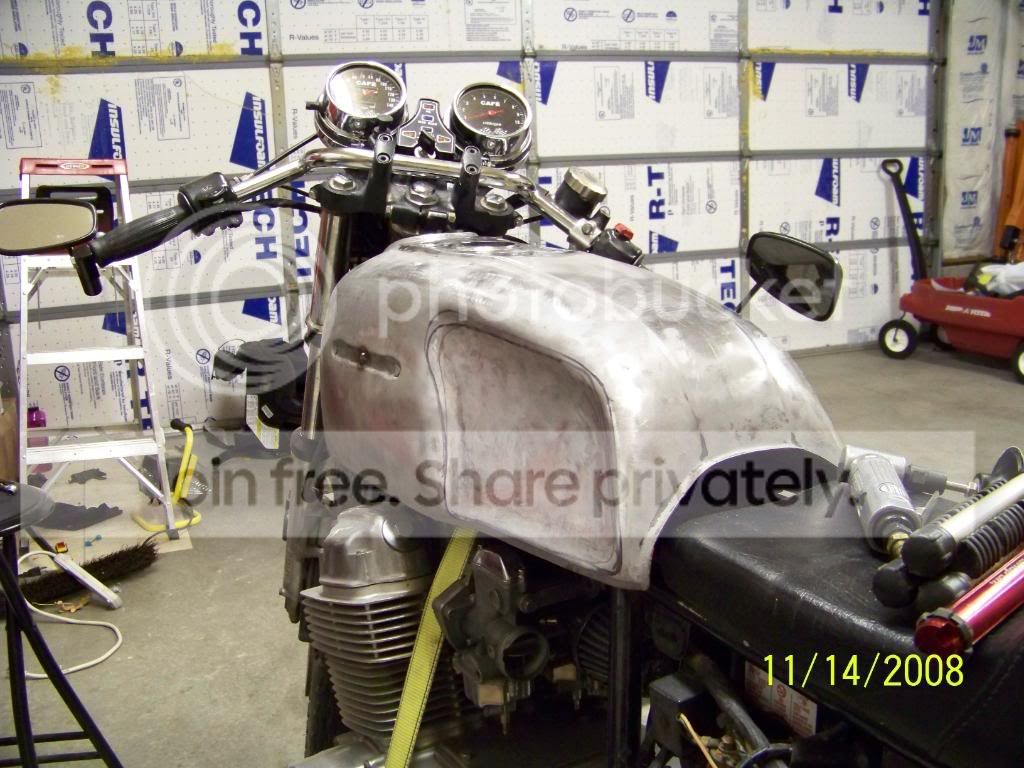

so I got this one instead and went to work:
cut out original filler port, repaired rust, and knocked in some knee dents and added bond-o:

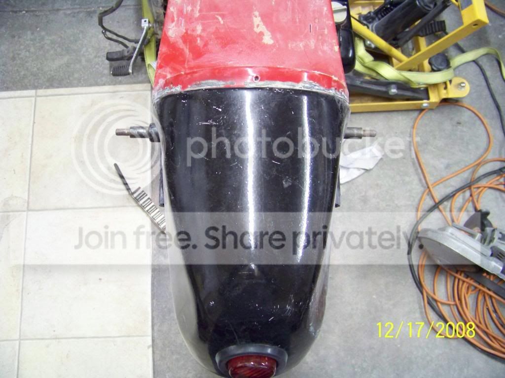

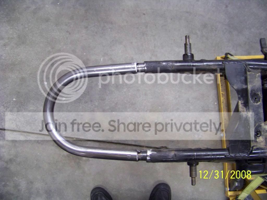

Chopped off tabs and the factory seat frame ends and fab-ed a radius to fit the seat :
made a seat pan for the seat:

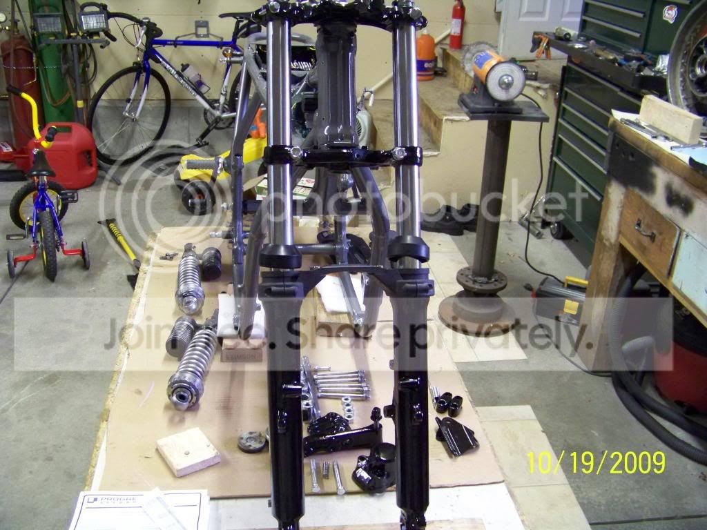

Hand polishing as many original bits as possible:
First re-assembly:
oil tank clearance issues: (since resolved)

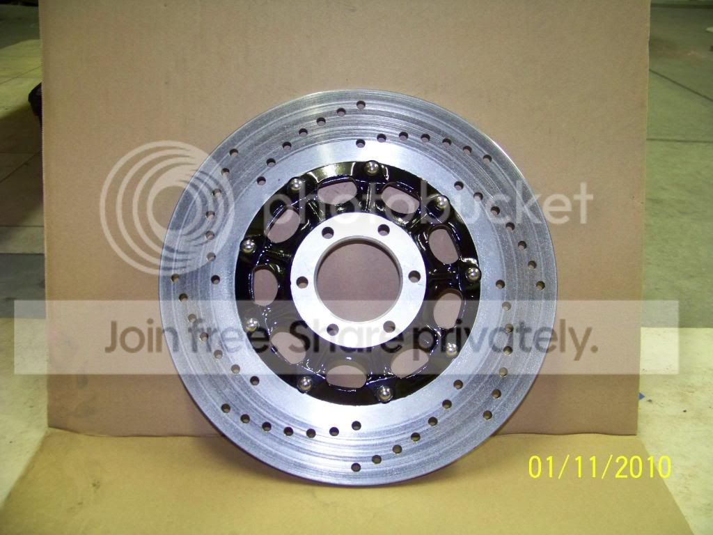

Freshly spoked rims and rotor drilling:
Coming together:

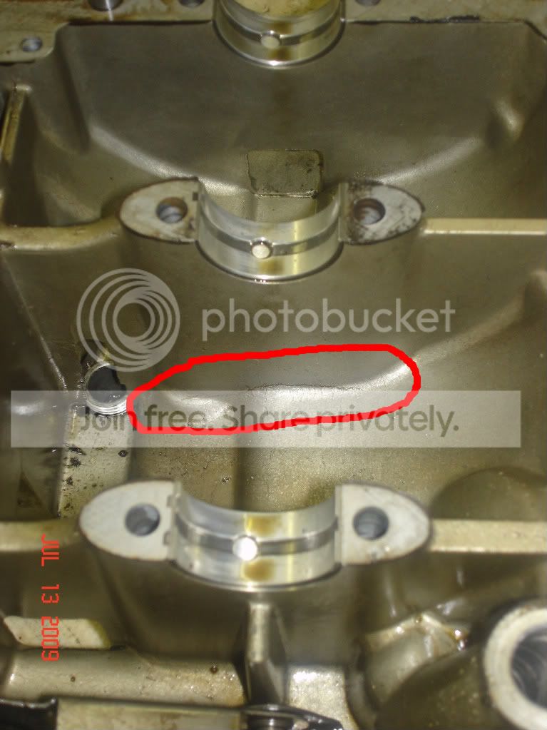

With this project, the motor is one of the last things to get done - here is one reason why - a crack (stress) along one of the crankshaft towers:
I have a spare case but have heard conflicting thoughts as to whether or not I can put the internals from one case into another. Something about tolerances and such. I need to do more investigation. So anyway, that's what I have as of now.

Love the colors, the fab, the bike! Great work so far.
Re: Project "name pending"... 78 CB750 ***PIC HEAVY***
Great job! you do some excellent work. how long have you been at it on this project? Your tank come out great. too bad about the engine. you should be able to swap the parts for one engine to the other. you may need to get new bearings and you cant mix and match case halves. Keep it up

weld that case. its fine. ;D ;D

nice work for sure. Like someone has said, the main problem swapping internals will be your bearings might not fit. Honda bearings are colour-coded to the journal size, which on the DOHC models is stamped on the case in letter codes like BBBBB etc. You'd only need to replace the mains at the most, because your rods will follow the crank across.
Anyway, great job.
ian

Great work. I really love what you did to the tank.
