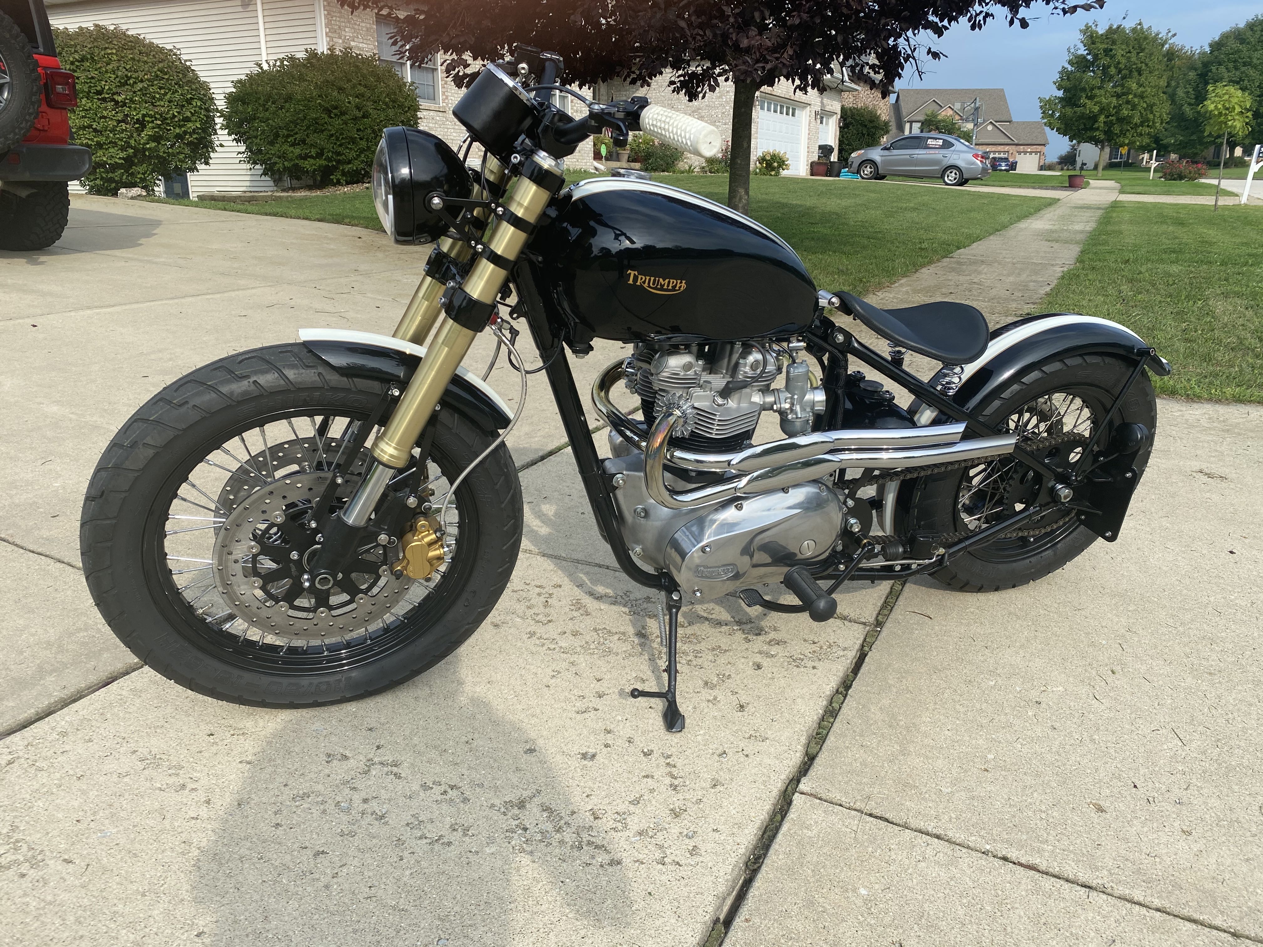

‘65 Triumph T120R Bobber - “Ticket To Ride”
An Outdoor pic or two for you today.
LowBrow posted a picture of your bike on their FB page.
Yep, they asked permission first... Todd at Lowbrow had really good things to say when I chatted with him. Love the comments on their posts, the feedback is good.
