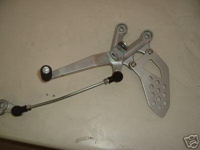

Rear sets I'll be working on, from a 2004 GSXR 600:

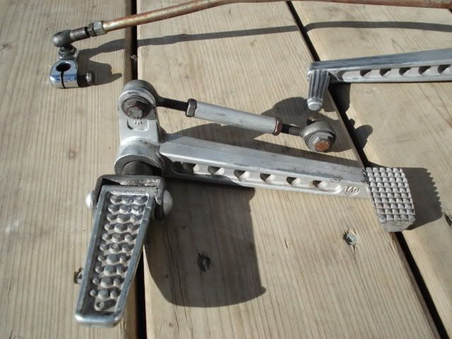

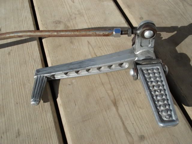

Just took some pix in the backyard:
Here on the shifter you might be able to see where I started with the wire wheel, starting from the left end to almost half way along the shifter:

Yes they are the OEM units off a '04 GSXR600. I'm sure they can be made to fit a KZ400, but the rear brake is a Drum on the 400 if I'm not mistaken, which would be a different set up altogether as the GSXR is a disk and has the master cylinder mounted on the peg bracket.
You could probably make some kind of linkages to the drum, but the design of the brake attachment makes the brake movement an upwards movement, where you would want a forward pull movement for a drum brake.
I'd search around how others have set up a drum type linkage.
The VF1000R pegs I've got showing above would work well for a drum type brake, as the brakes linkage connection is on top and pulls forward when the brake lever is applied.

The ebay add said 1984 VF1000R. I have since found on another board that they may have actually been Raask pegs.
