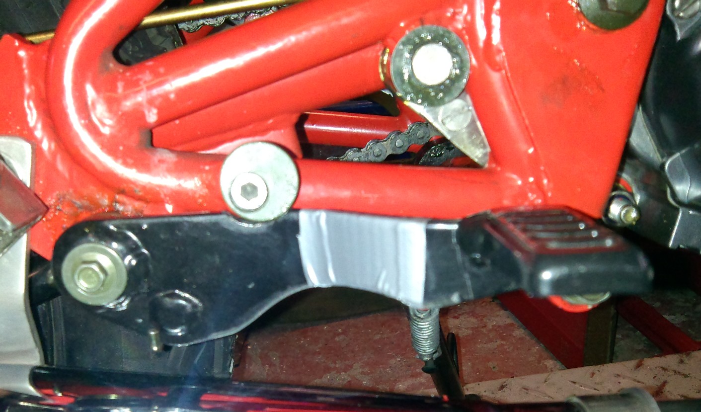

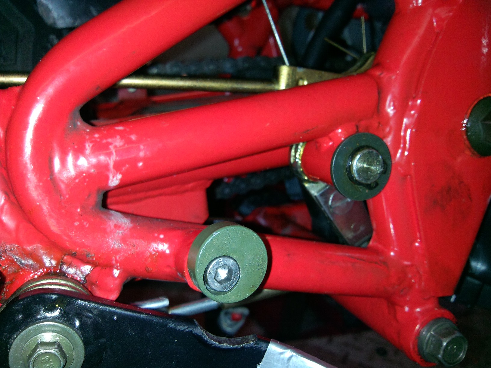

Before you get much further with your build check out the swing arm mounting plates. they are outboard of the frame and are simply two 4mm or so plates. I have my doubts about them being up to a 250 and am going to brace them with two similar plates welded inboard - There looks to be plenty of room for this and it should stiffen the whole lot up. I'll probably fully weld up the outer plates too.
The back brake is also shite in standard form but I want to keep it as a drum - I am very keen to keep the bikes looking period and fairly 'standard' - However I have modded my back brake quite heavily and it seems to have improved it to the point of being able to lock it up. The main problem, apart from the pathetic size of the drum, appears to be the mid mounted crank - the actuating arm is shorter than the actuated one making a reverse lever action. I extended the short arm, modified the rod from the brake lever to be adjustable and turned the back brake rod upside down to reduce flexing. I also had to mod the actual brake pedal to clear my silencer and to raise it up giving it more adjustment. The pics should help to see what I mean!
Oh yeah............ Don't know how I forgot this but I fitted shocks from NJB Shocks in the uk - What a revelation - unbelievable improvement and with out shrouds they are only £72 Mine were £92 with shrouds and P&P..........
Short Goldie sounds ace! Left Ooracing pipe std length, blocked end with alloy plug - drilled one 12mm hole in it and three 6mm ones, then drilled 12 off 15mm holes radially in the pipe - makes it 'reasonably' quiet (well OK 'reasonably' loud!) but lets it go...

I wondered about a rear disc but hate to beaten and have persevered with the drum - it is now good but out today and it's not a wheel locker! I am going to try drilling the sprocket mounting boss to create a fan that blows across the brake - I vented my brake plate, see earlier posts - to blow all the crap out (and heat). Every time I strip it it is full of brake dust!
