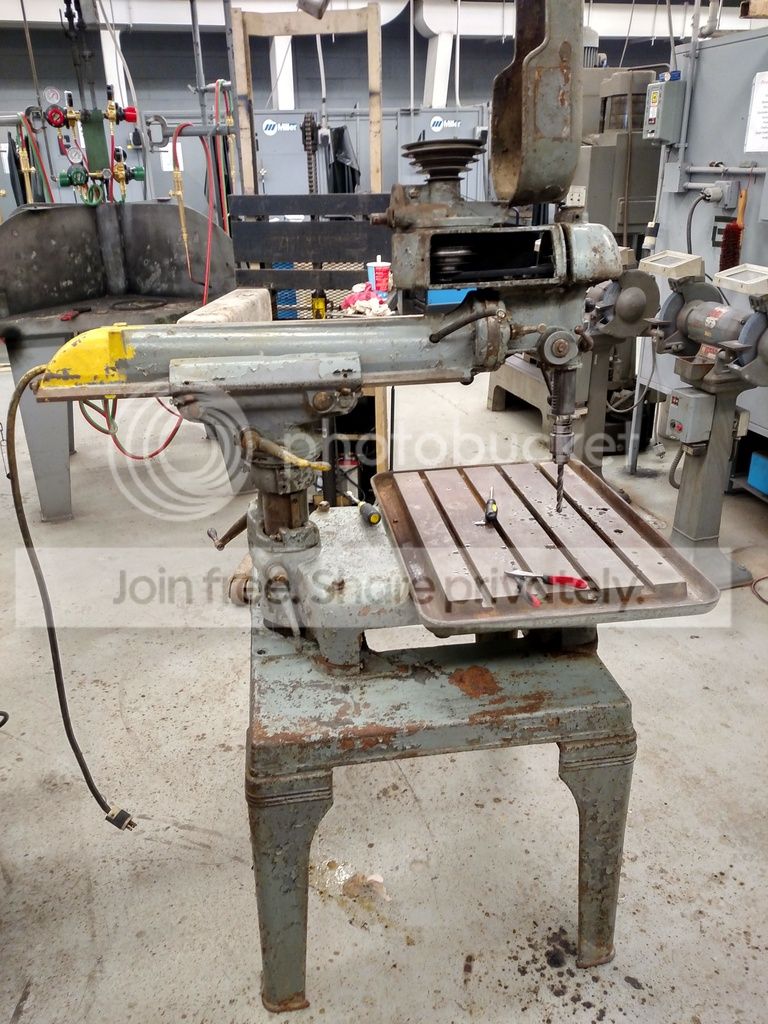

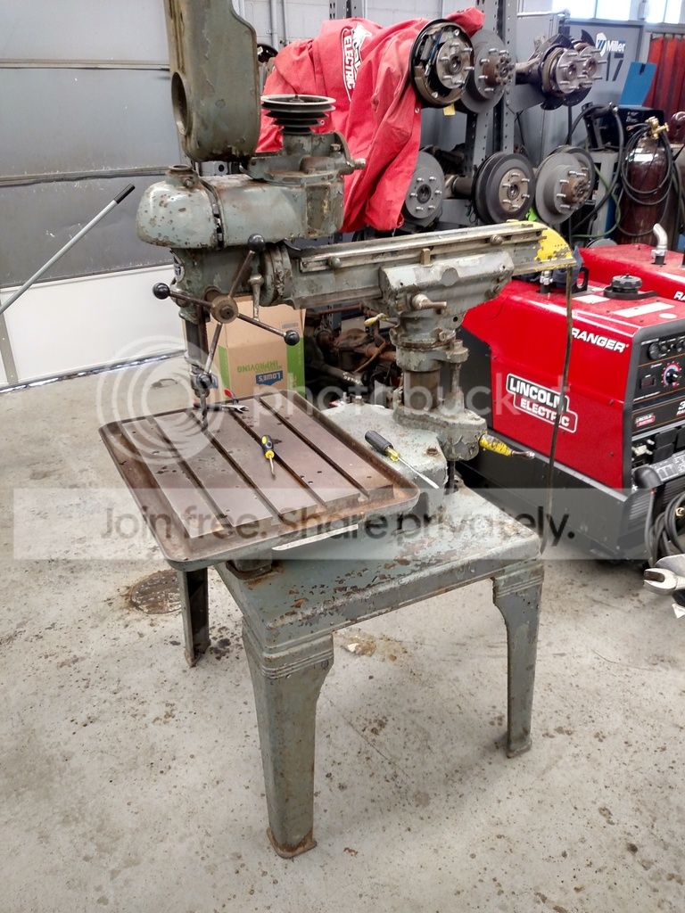

Last Firday I went to an estate auction for a man who ran a construction company and all of his tools/and equipment were for sale, most of the stuff went for crazy high prices but I was able to get a few nice things at good prices including my favorite piece! I have wanted one of these for about a year now since I saw one I craigslist for $1500. So when I found this one at the auction I knew I had to grab it up, even though I wasn't sure where I am going to put it at the moment ;D. Enter my brand new used 1945 Walker Turner radial arm drill press! This is a single phase machine (also available in 3ph) 16 speeds from 160-8300RPM, head tilts 45 degrees to either side, 18x26 inch table. My plan is a total tear down and rebuild including new paint, new wiring, new bearings (where needed) and some other things along the way.
We got the drill out of the back of the guys barn with his fork lift, and then brought it to my schools welding lab where I am gong to do the restoration on the tool.
First thing I did was wash it down and get all the grease off of it, then I started to take it apart. Next step is to start cleaning individual components and prep them for paint!
On the way from the barn to the school:
In the welding lab
Initial clean up

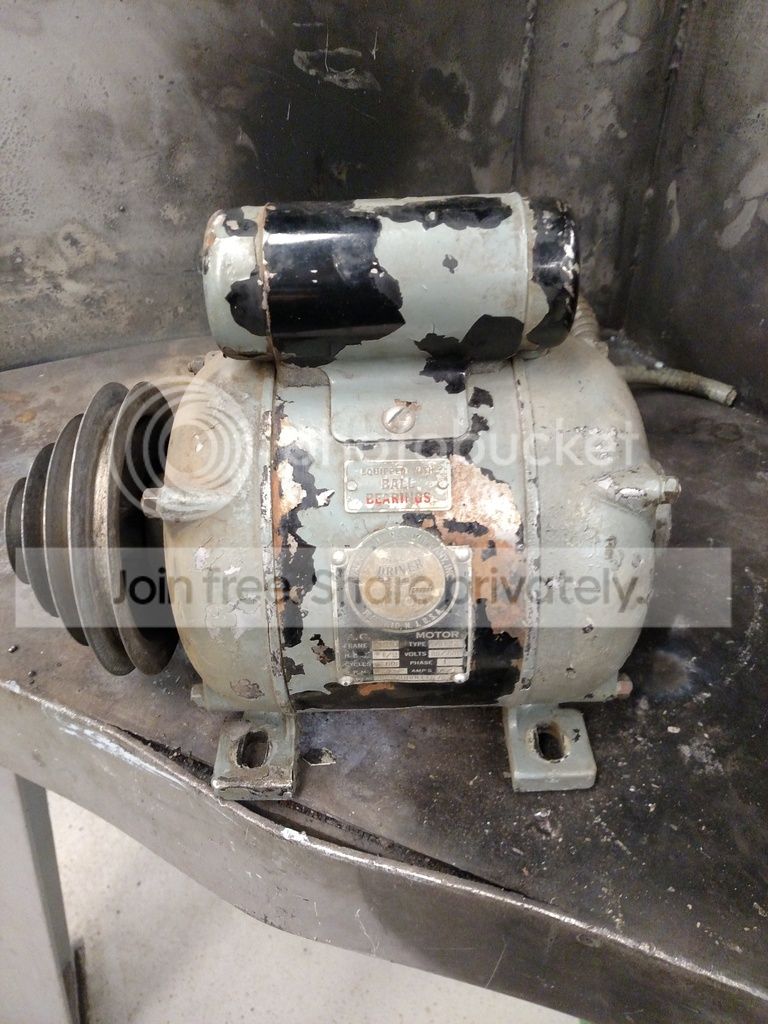

While waiting for my next paint day on the drill press, I took the motor home and decided to start rebuilding it! I don't have a ton of experience rebuilding electric motors but I have watched a few youtube videos and read through a few tutorials (including one very detailed one for my exact motor) BUt I am going to give it a shot. I havent done much on the motor yes besides stating to make sense of and removing some of the wires and switch box. I also ordered up some new SKF sealed bearings that arrived today.

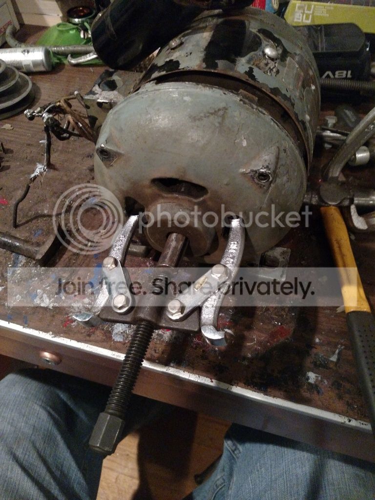

Well I got the motor torn down today, it took some doing together it to this point, including a few different gear pullers; one to remove the pulley, one to remove the front end shield, and two to remove the bearings off the shaft. I also had to figure out a way to separate the rotor, bearing and rear end shield. I noticed a 1/4-20 screw that was on the backside of the bearing near one end, it had just a simple plug in there, so i put a longer screw in there, as well as drilled and tapped a second one 180 degrees from it and did the same thing, by slowly threading the screws in, they just pushed the rotor/bearing assembly out of the end shield. When I go to assemble the motor, ill just put some 1/4-20 plugs in there.
I measured up the replacement bearings that I had purchased and compared them to the OE bearings and they are a perfect match, I had ordered an SKF 6301 and an SKF 6203

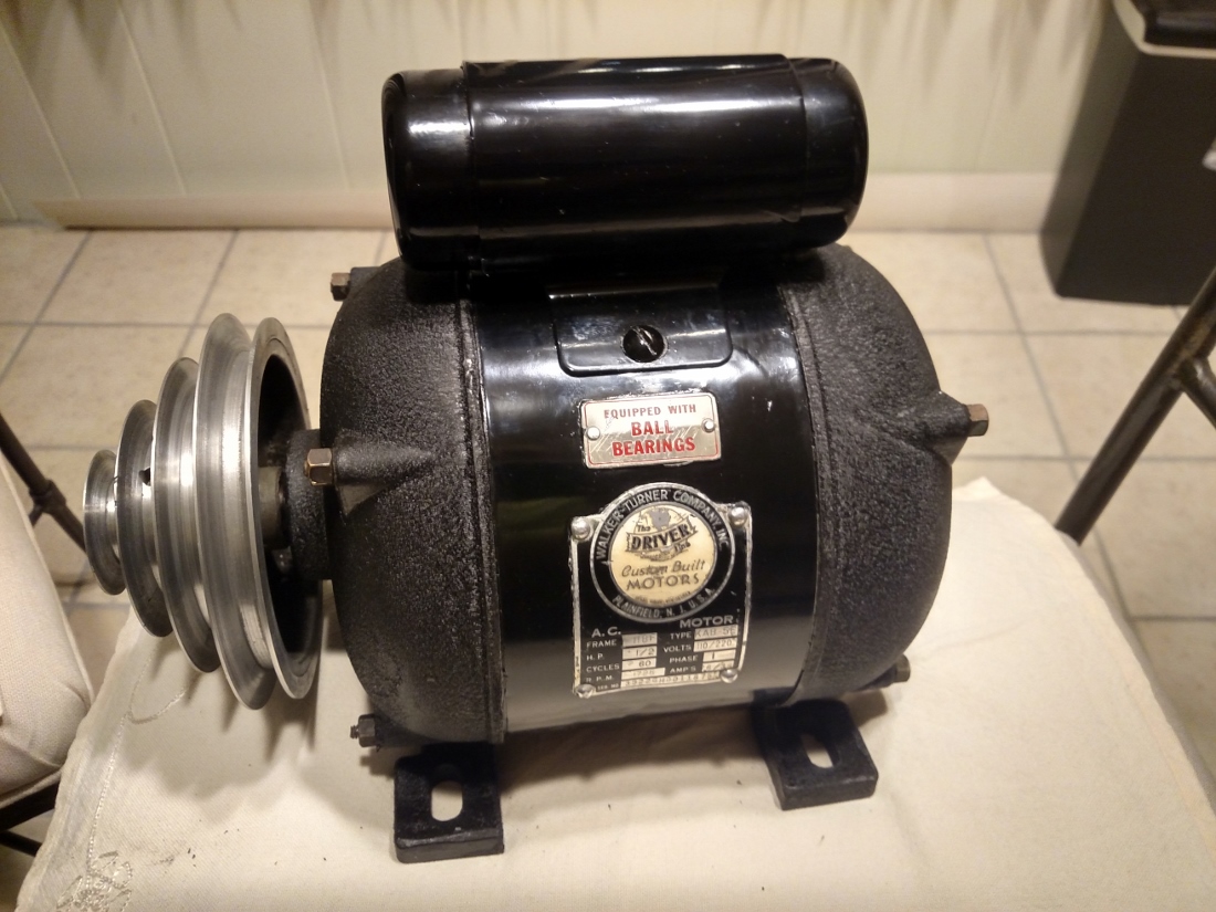

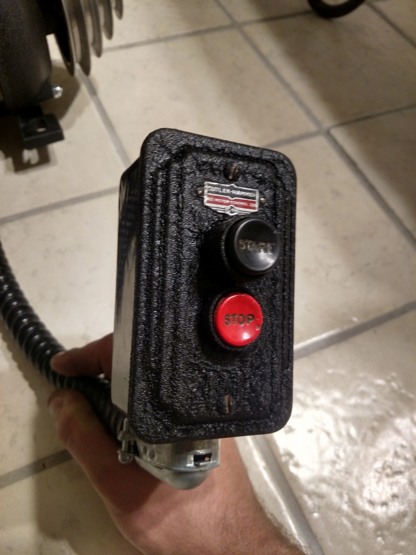

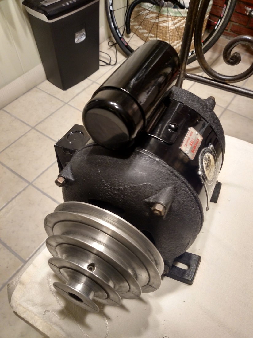

I got the motor done today! I don't have many pictures of painting or putting it back together unfortunately, most of them ended up getting deleted. The ones I do have are of throwing the rotor on my lathe and getting it cleaned up with some scotch brite. The other is starting to paint the bell housings with VHT wrinkle black. Takes at least 3 heavy coats and then let it dry for at least a day then curing it for 30 min at 200 degrees (WARNING: will stink up your kitchen if you use an oven) I painted the switch face in the same manner. Everything else got rustoleum gloss black. I stripped everything with aircraft stripper and masked off the badges, after everything got painted I carefully took a pick and chipped off all the stray paint on the badges from the PO's bad repaint and then used some rubbing compound to shine them up. I put it back together with new SKF 2RS sealed bearings (1) 6301 and (1) 6203. For all the wires that I did replace, coming from the wall socket to the switch and back to the motor, I used 10ga. It is a little overkill but..... Then today, everything buttoned down and temporarily hooked up the wiring, plugged it in, and she purred like a kitten! very smooth, quiet and no funny smells!
These are not the best pictures but it will give you a good idea!
