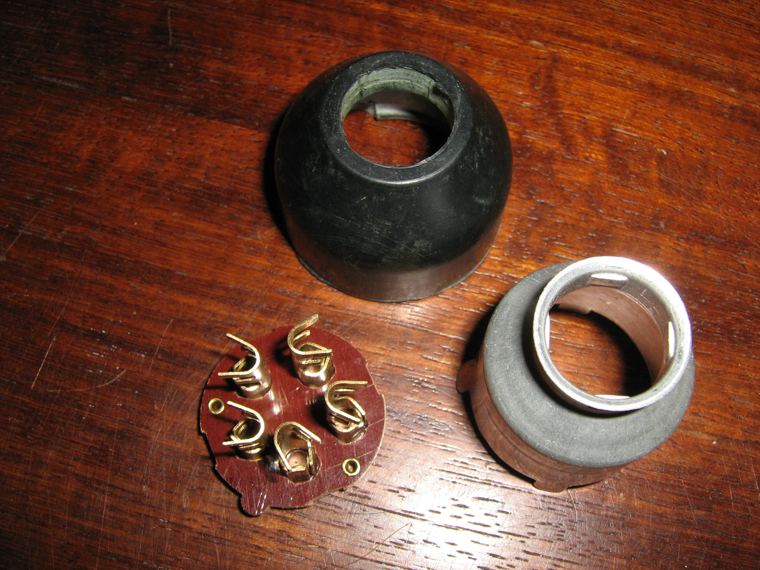

magicflemo, The male and female ends of the quick detach socket have an outward indentation and must align in order for it to match up correctly. (see third photo) Once they match up, the rubber part covers the connection.
The rubber cover is hard, thick rubber and must fit over metal "female" socket. As the hole is smaller than the flanged end of the female socket cover - how do you fit the rubber?

Wintergreen oil is the best way to soft old, hard rubber: http://forums.sohc4.net/index.php/topic,29707.0.html
http://www.dotheton.com/forum/index.php?topic=2692.msg21373#msg21373
I've used a 50/50 mix of wintergreen oil and toluene
