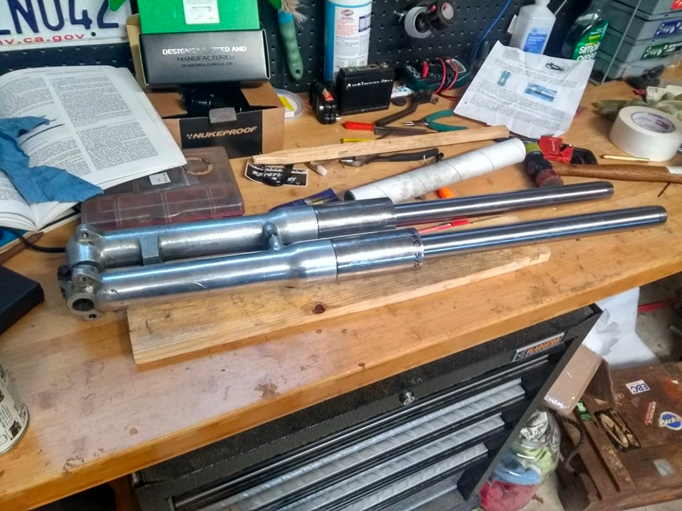

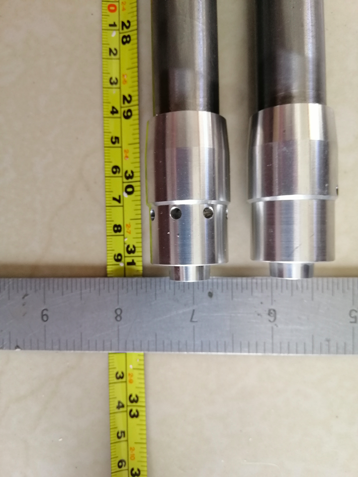

So AMC Hybrid Guru Mike of Walridge Cycles located repop damper tubes after a bunch of searching, and so today this happened:
These have the anti-top-out sleeves in, from JS Motorsport.
Not going to do the Lansdowne carts for the moment, and Racetech told me adaptation of Gold Valves to the roadholders is a no-go, having been tried several times before to their knowledge.
Now to get them re-installed and finish getting the clutch pushrod sealed up. I am still bouncing back and forth between methods of doing it...either an o-ring straight on the pushrod itself (recommended by Bob Newby, manufacturer of my dry clutch) or a common seal kit (the "Dynodave" style) that holds an o-ring against the end of the pushrod tunnel...but creates some clearance issues.
Welp, made a new one-piece clutch pushrod in the appropriate length from some drill rod which I cut, shaped and hardened as above. Works well with the new pushrod seal and another steel plate in the clutch stack for some more clearance.
Also cleaned up the top cap threads in the new stanchions. Just had to run the old top cap through using a big wrench with the stanchion held in the vise with rubber jaws to chase the slightly distorted threads clean. Now the new cap screws in easily.
Bad news is the anti-top-out fix I installed left the forks unable to extend fully; about 3/4" short. While trying to figure out what I could do to make it work, I wanted to measure the fully compressed spring length. I rigged up a pogo stick looking way to do it out of a wooden closet hanging rod and a 2x4 , and was quite proud of myself till I decided to double check my measurement, let it bounce too much underneath me, got some coils caught underneath it, and ended up bending the spring slightly. (Which seems like it might have been clapped out anyhow...perhaps it was for the best?)
Don't seem to be replacements readily available for those...just shorter ones for older Nortons and the newer, longer internal arrangements. I'm pursuing the cartridge dampers again, but at least now I have all the measurements I need to get them right.
