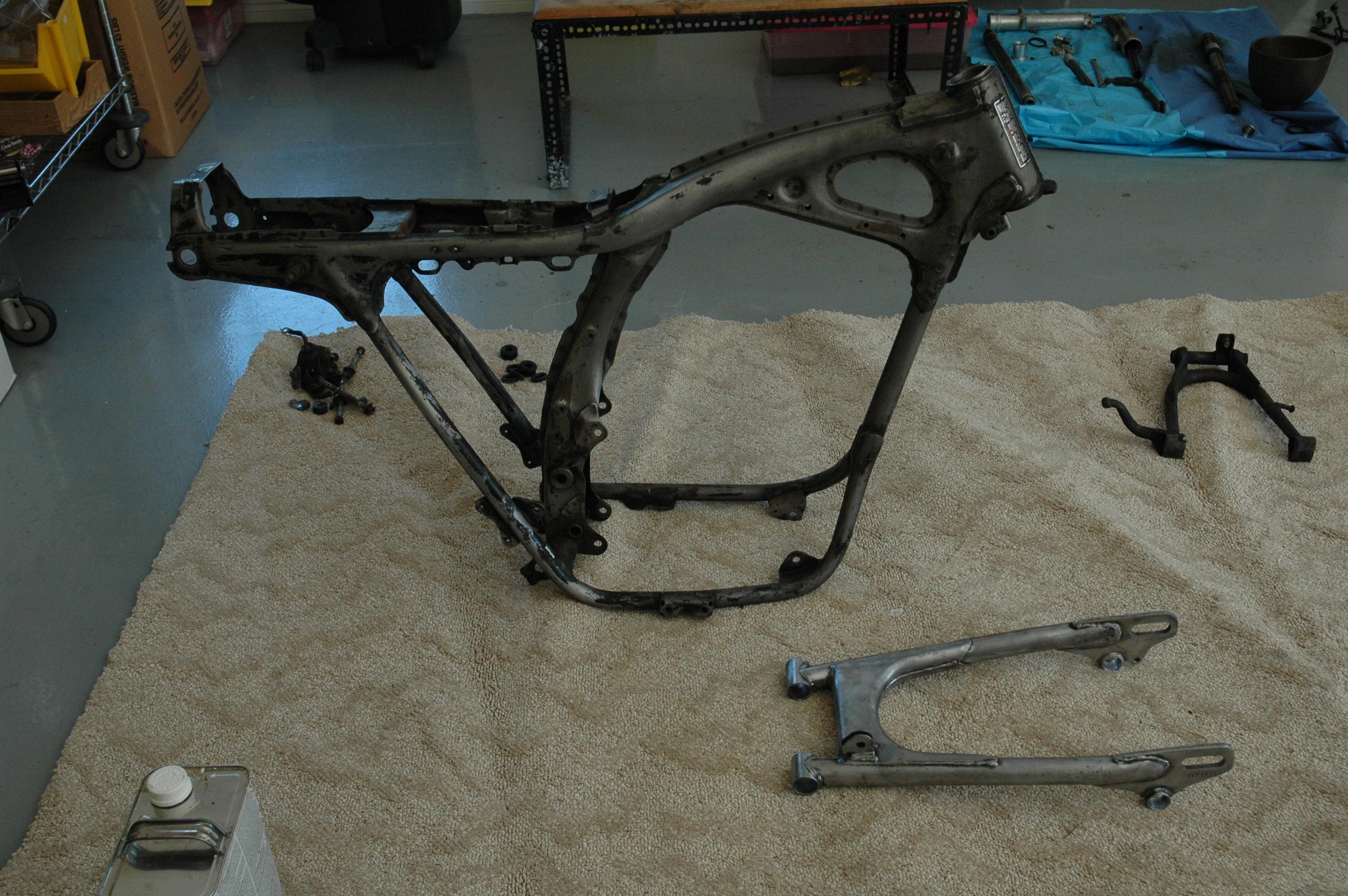

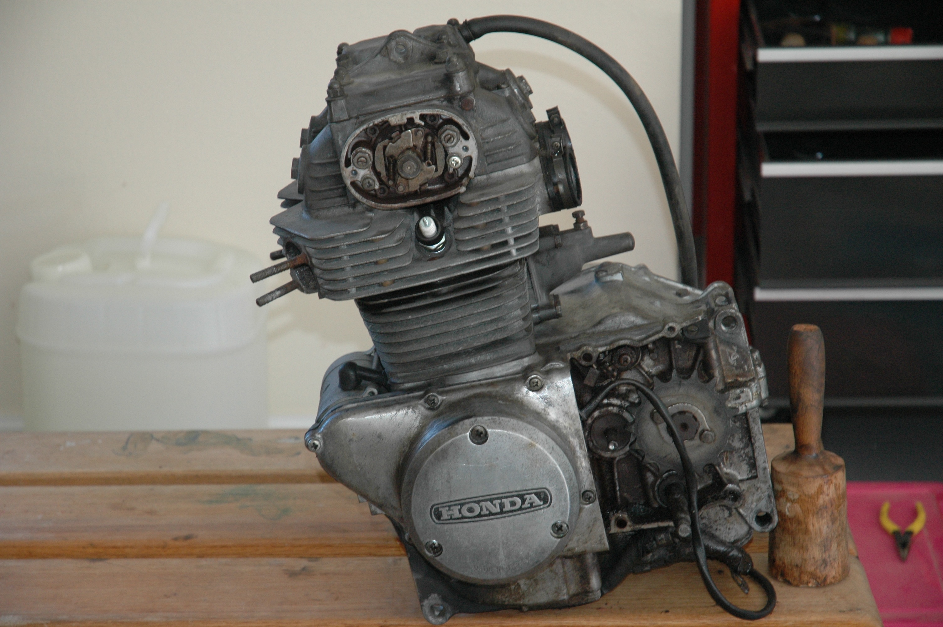

The engine is out and the frame is partially stripped

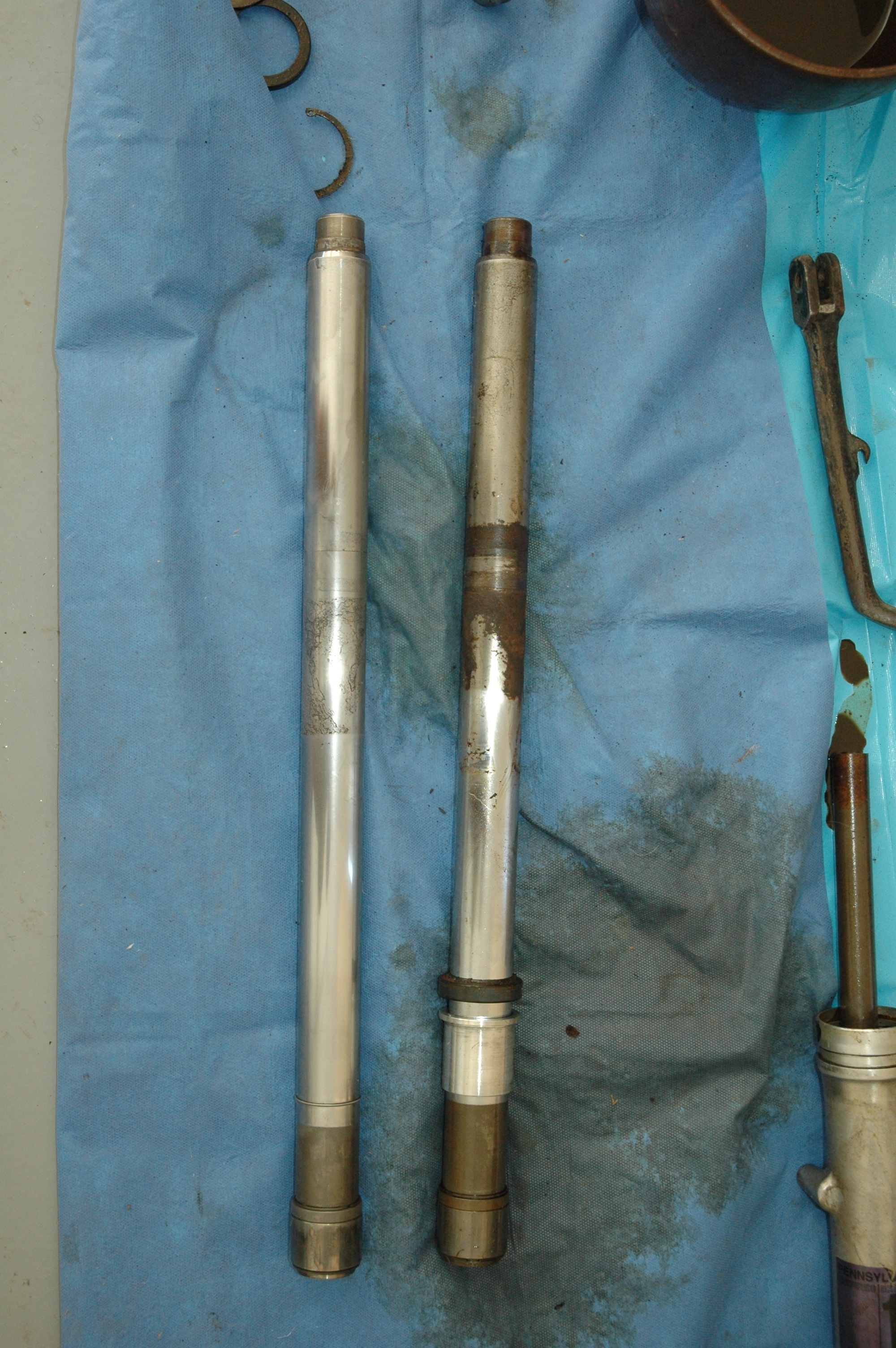

I disembled the front forks and polished the rust off one tube. There is still some etching present even though it is relatively smooth. I don't know if I need to replace them-probably

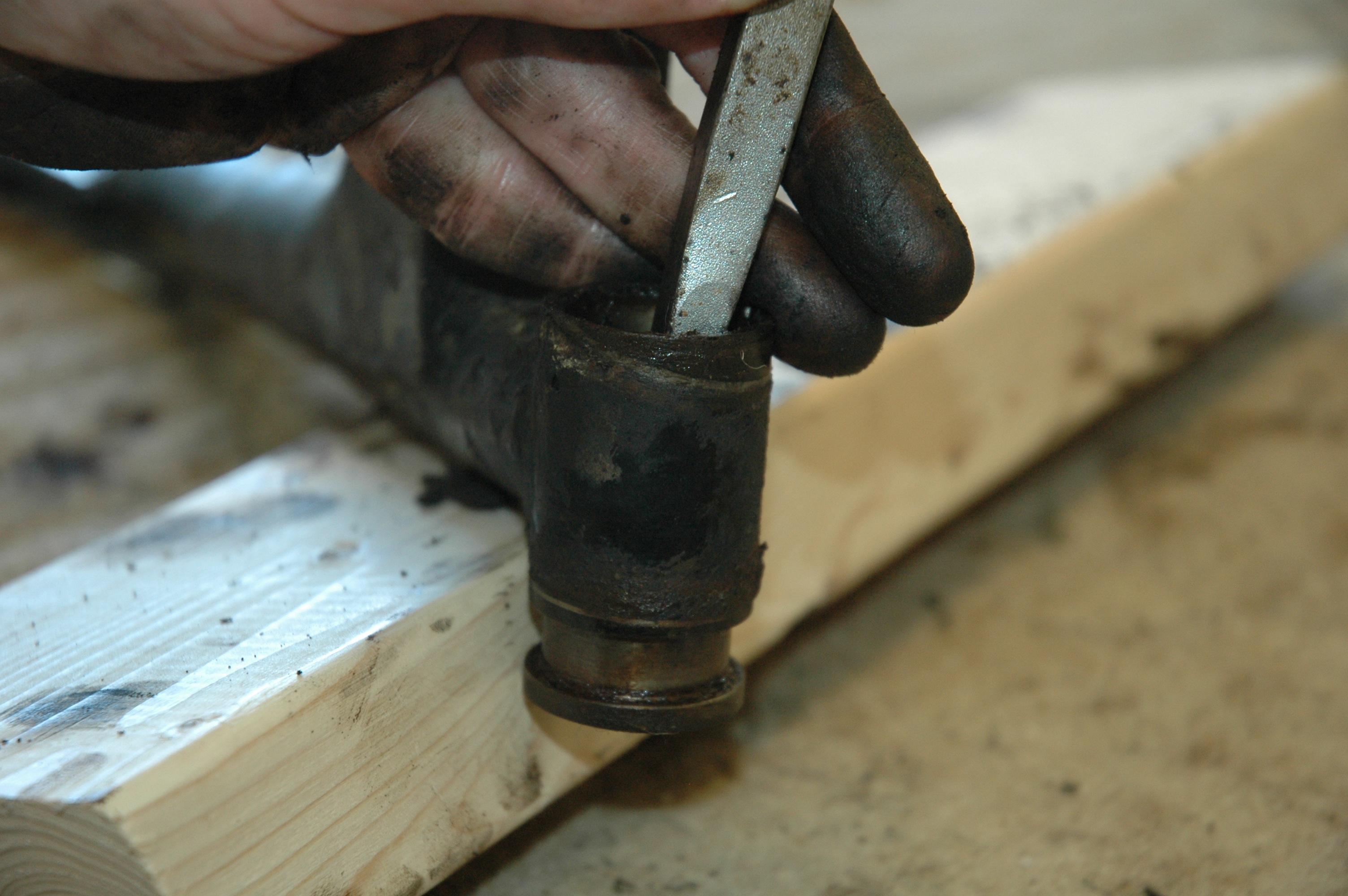

I put alot of work into the swing arm
I learned some tricks:
1. To remove the bushings-there is a 1/4" space between the bushings on each side. You can get a chisel on the edge of each and easily pound it out. You have to be careful to avoid injuring the housing.
