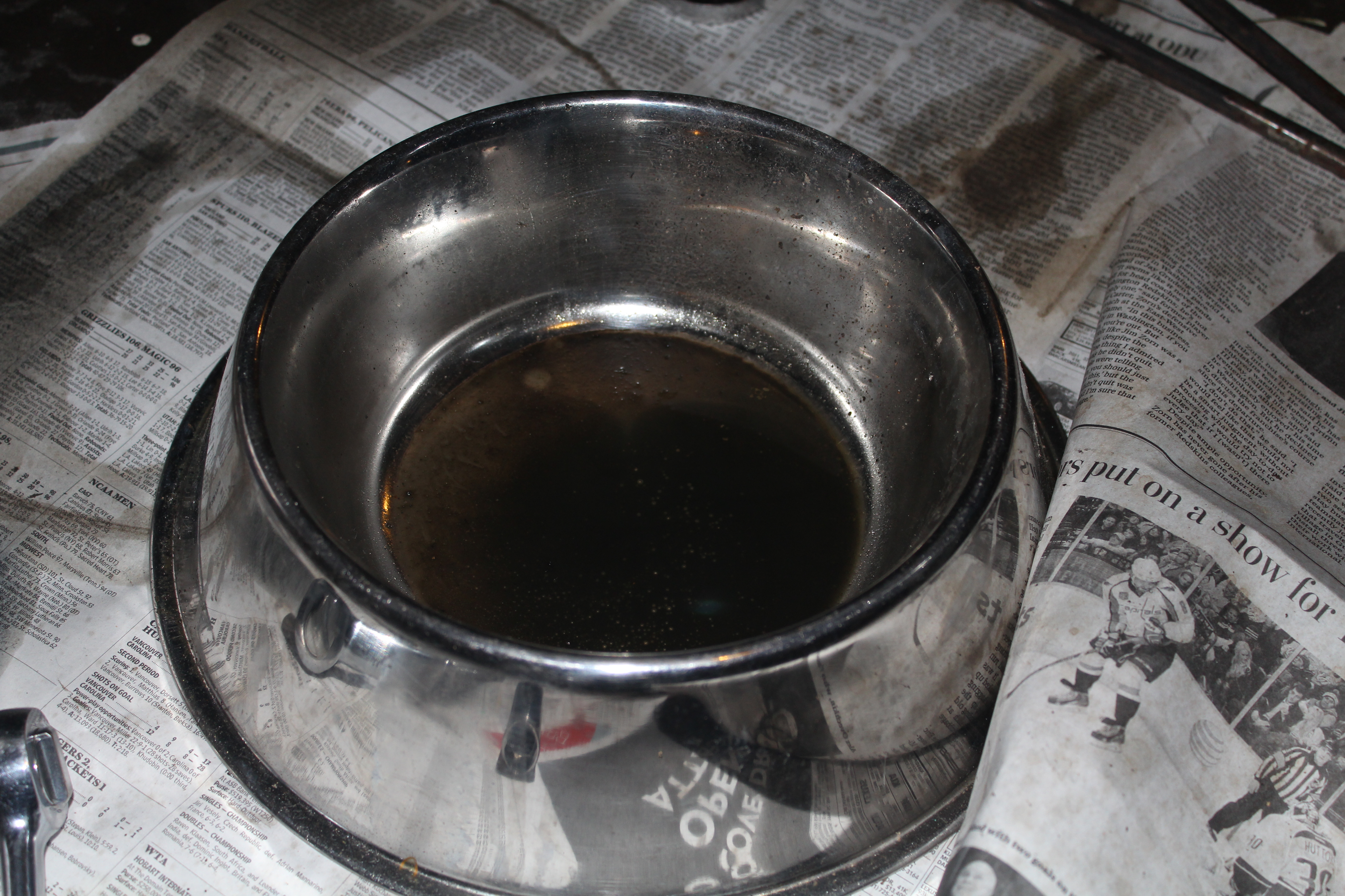

Working on trying to clean out the crankcase. I filled it up to the brim and let it sit in there for a few days to perhaps breakup and dissolve whatever solids were in there. It looks as if its worked as the color has changed to a dingy brown. Only issue is I don't know how to get it all out. I gave the kick start a few pumps to get rid of what I could, but the rest was still left. I resorted to trying to blow it out with an air compressor and that did nothing besides spray shit everywhere Including my eyes...
I'm thinking about just turning the bike upside down and hitting it with carb cleaner since that will evaporate. I'll post some photos of the bike when I get home this afternoon.
unfortunately if the crankcase was full of water and rusty you will need a new/rebuilt crankshaft assembly,there is no way around it

Thats what I thought, but upon further inspection it looks okay. I think there was enough oil in the crank to keep it from oxdidizing. That means its probably leaking somewhere... Oh well, you win some you lose some.

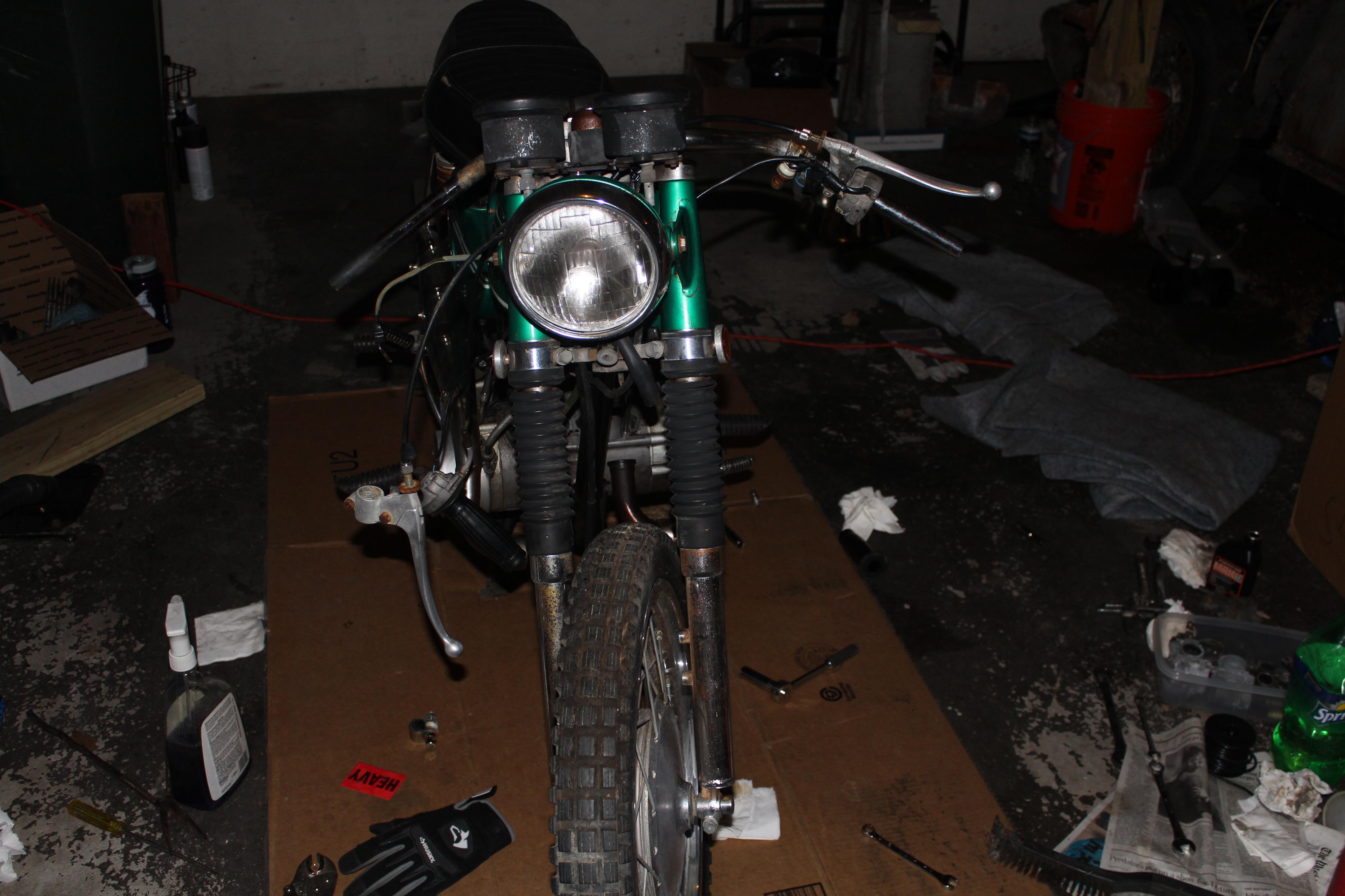

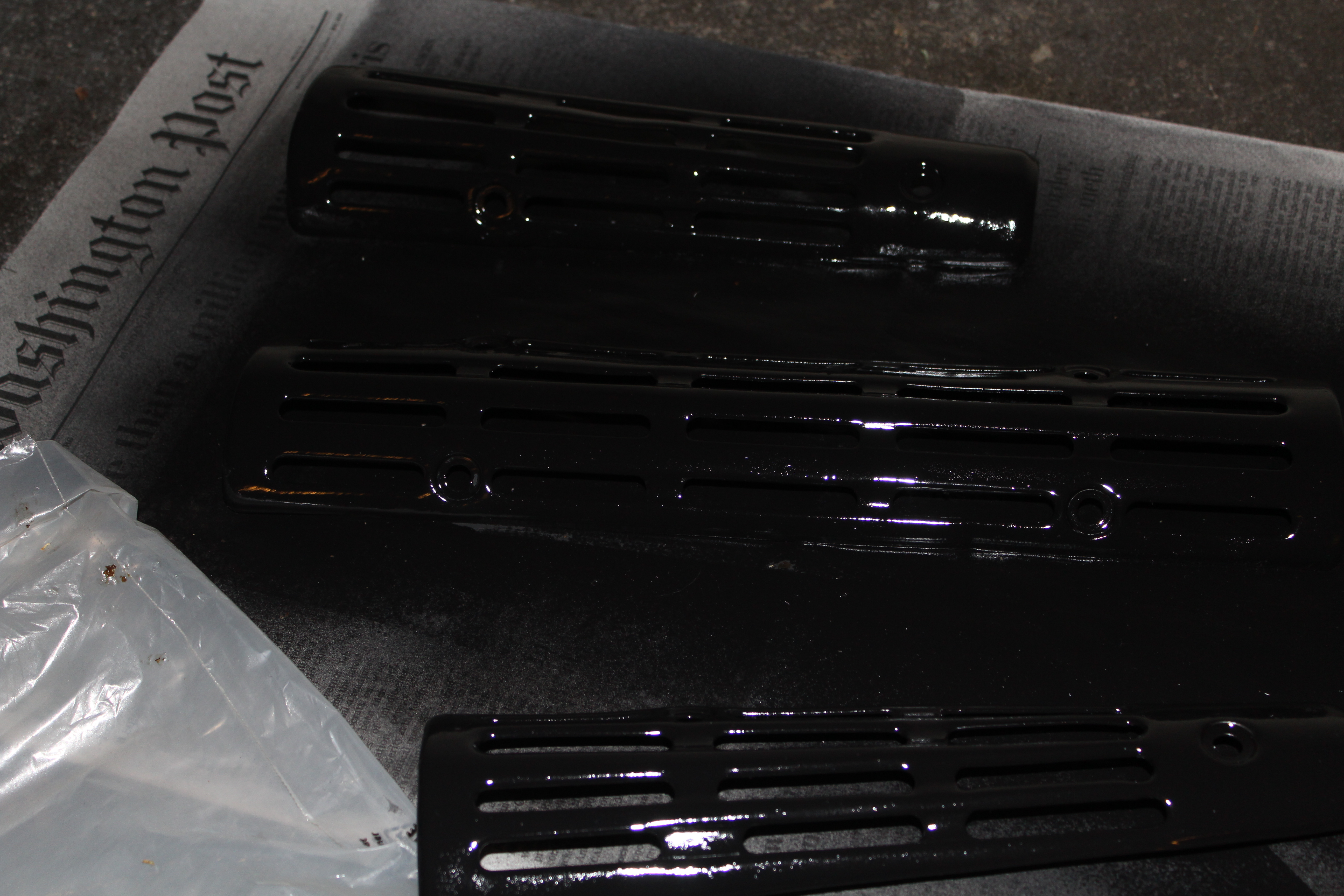

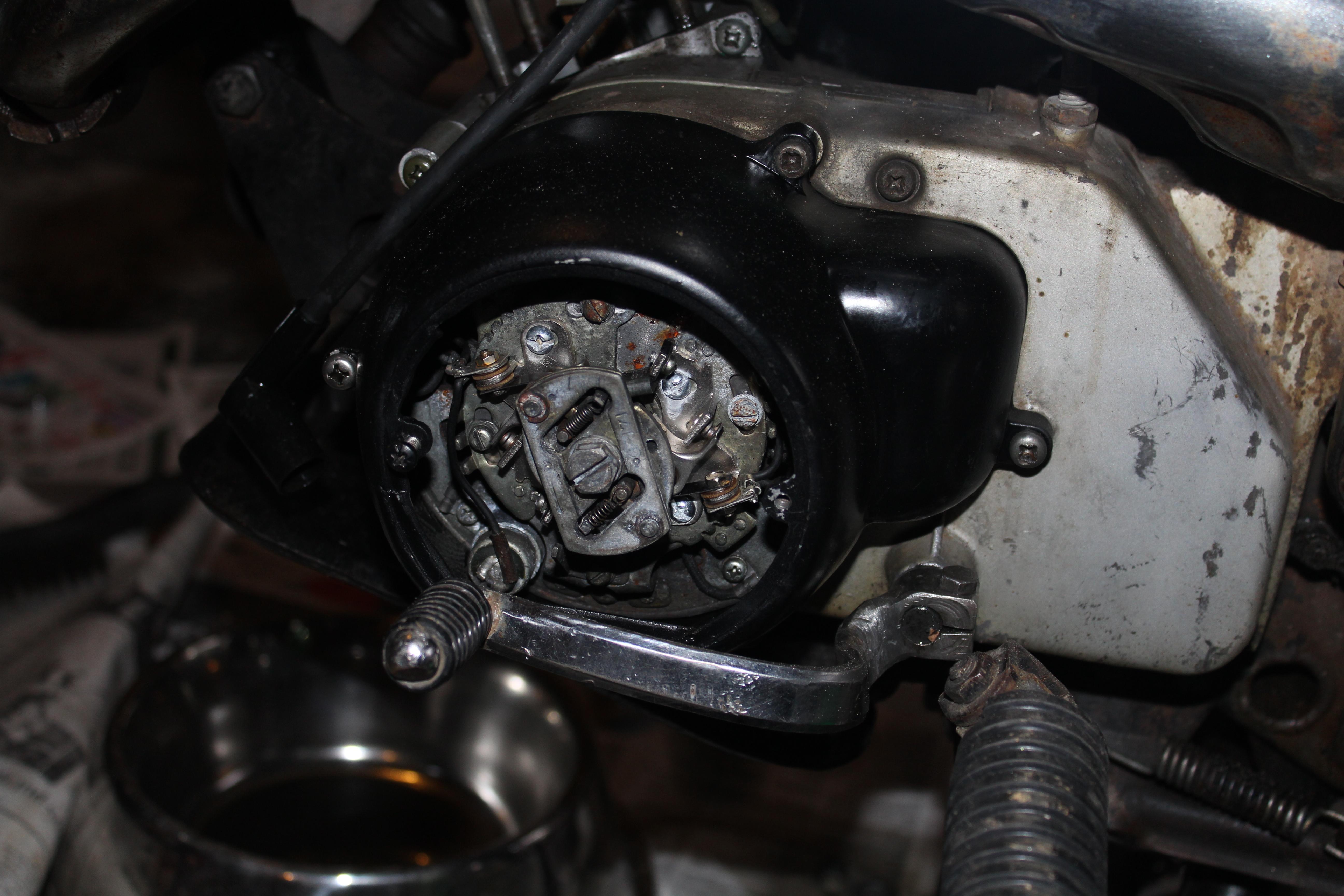

Okay as promised I'm back with photos of the progress so far. Right now I am painting the exhaust (side?) covers a glossy black because the rust was so bad. The pipe itself is actually fairly clean so I think I will keep that as is. I'm going with a Black and Chrome color scheme and am unsure if I will keep the Green or not. Let me know what Y'all think.

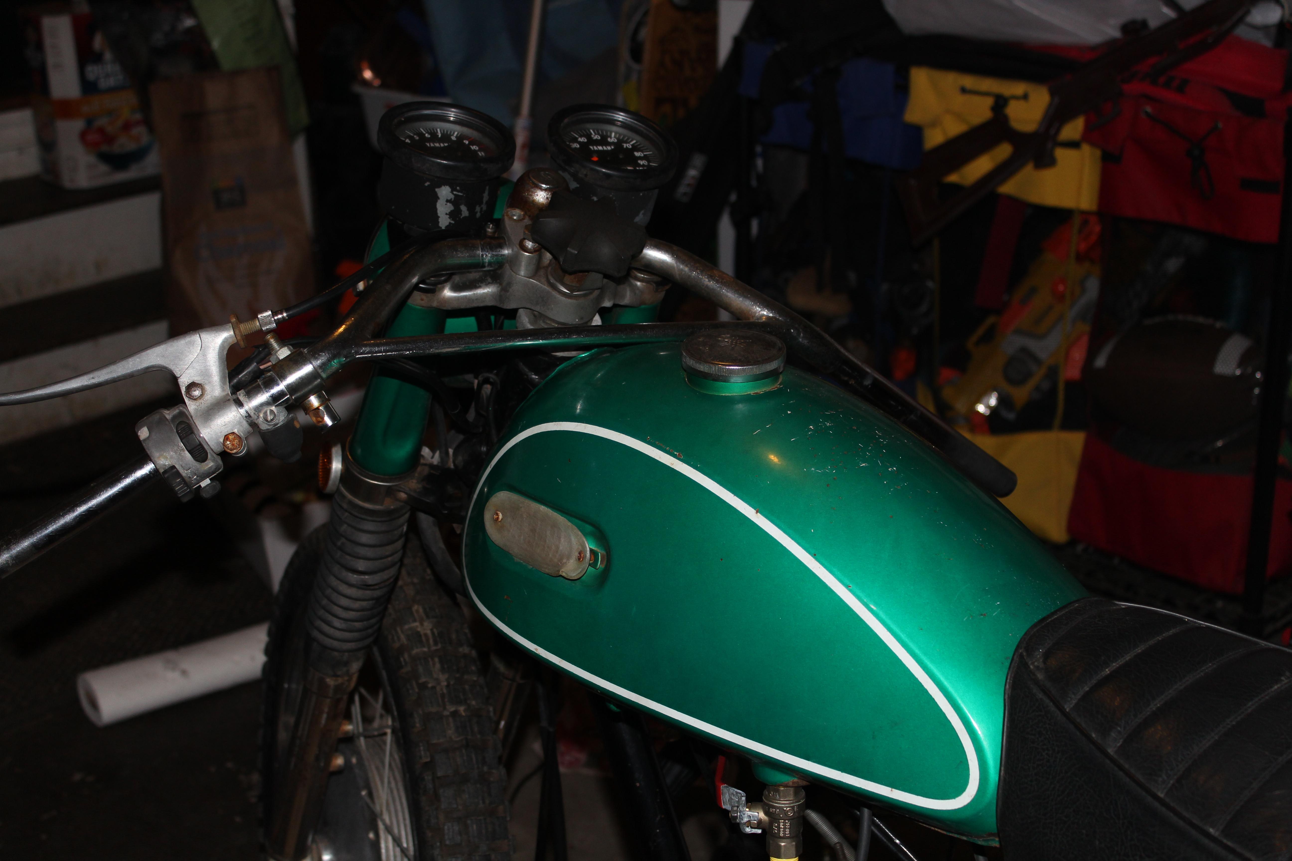

I'm thinking I'll probably keep the seat thats on there. Its got a nice brat look to it an I can fit a girl on the back.
Also I noticed that the bracket that connects the footrest to the frame was held in place with a random assortment of washers. I don't know what or how its supposed to fit but its certainly not that. The right footrest flexes quite a bit when I try to shift or use the rear brake. Normally I would just say fuckit and use the rear set of pegs but seeing how the kickstand is also attached to that bracket, I'm worried.
Congrats on your purchase - I had the identical bike right down to the colour, but it was too far gone to restore (bought it out of a lean-to in rural Ontario, where it had set for many years). I parted it out and got a lot of other guys' rides going in the process.
For a point of clarification, what you have - even though the steering head is stamped CS3, is the CS3C street scrambler version of the 200.
You've got the high pipes - very desirable (but get or make some heat shields for them if you don't have a set) - the braced handlebars and unless a DPO took it off and threw it away, the world's heaviest bash plate under the motor.
The bike was way too heavy to do anything but casual trail riding and even then, dodgey - but it made a great street bike for the day.

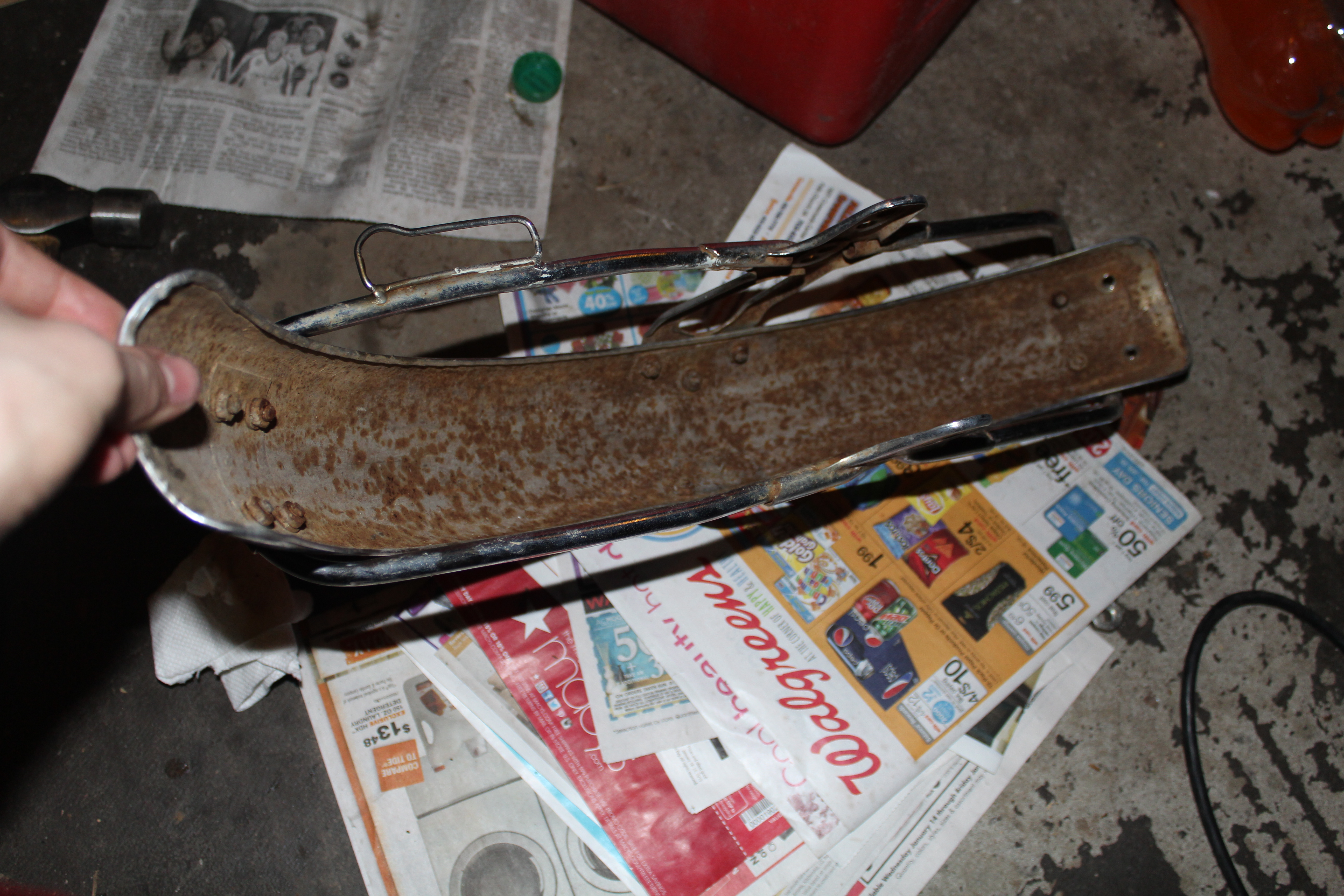

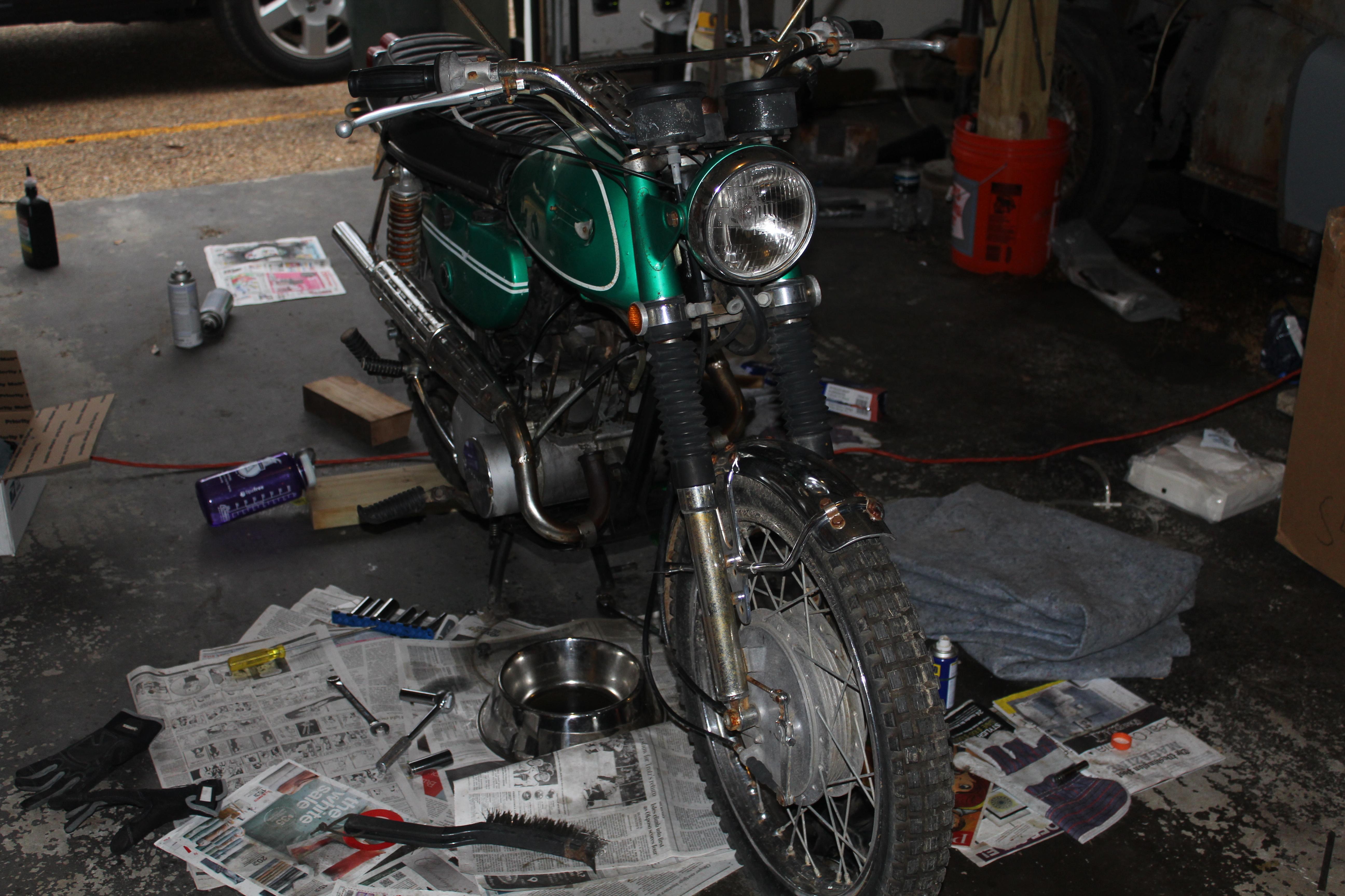

While I'm waiting ever so patiently for my gaskets to come I've begun thinking about how I am going to change this. One of the first things is to strip the bike of any unnecessary weight. Since this is a trail bike, the fenders are massive. I'm thinking that pulling the rear would really change the look and add to the cafe style. I'm not sure about the front fender though. I'm considering pulling the shield and leaving just the fender stay behind so that I don't lose stability. I'm really not digging the rust encrusted chrome and a lot of it is too far gone.
I painted the muffler side covers today to see how the gloss black finish looks against the chrome exaust. I'm going to wrap the headers anyway.

You absolutely need at least a short rear fender - from the swingarm up to at least the seat base - or else the rear tire will kick dirt and mud into the back of your motor, into the carbs, whatever. Even on road racers, we put a little fender there.
A couple of ideas - on my Baby Tracker, I used a BSA front fender for a rear and on my BS175 vintage road racer, am using a fiberglass replica '71 750 Duke front fender for a rear - I could never make sense of the no rear fender thing.
You could also look at a tire hugger but I think it would look... odd.
You should be able to find a small fiberglass front fender to fit the front, but keep the fender loop even if you get rid of the stays, as the loop will act like modest fork brace and those 30mm(?) forks need all the help they can get.
As far as weight, they were a heavy bike for a 200 and part of it was the fact it has a huge starter-generator and an equally huge battery to make the starter motor work. I looked at ridding my bike of the stock generator and using something else, but never came up with a solution..
Keep having fun with your project.

Noted. Something to act as a shield so that the motor doesnt get sandblasted. I could probably fab something up.
As for the forks im not sure as to what diameter they are, again I could always buy a real stabilizer. I don't trust this machine :P . The PO did a pretty nice job of abusing the hell out of the thing.
While doing the 3rd coat on the muffler covers I noticed that I used Hi-Temp base and a Automotive top gloss coat. So we will see what happens with that. Best case scenario is that it will not make a difference. Worst is that it cracks and explodes into my shins.

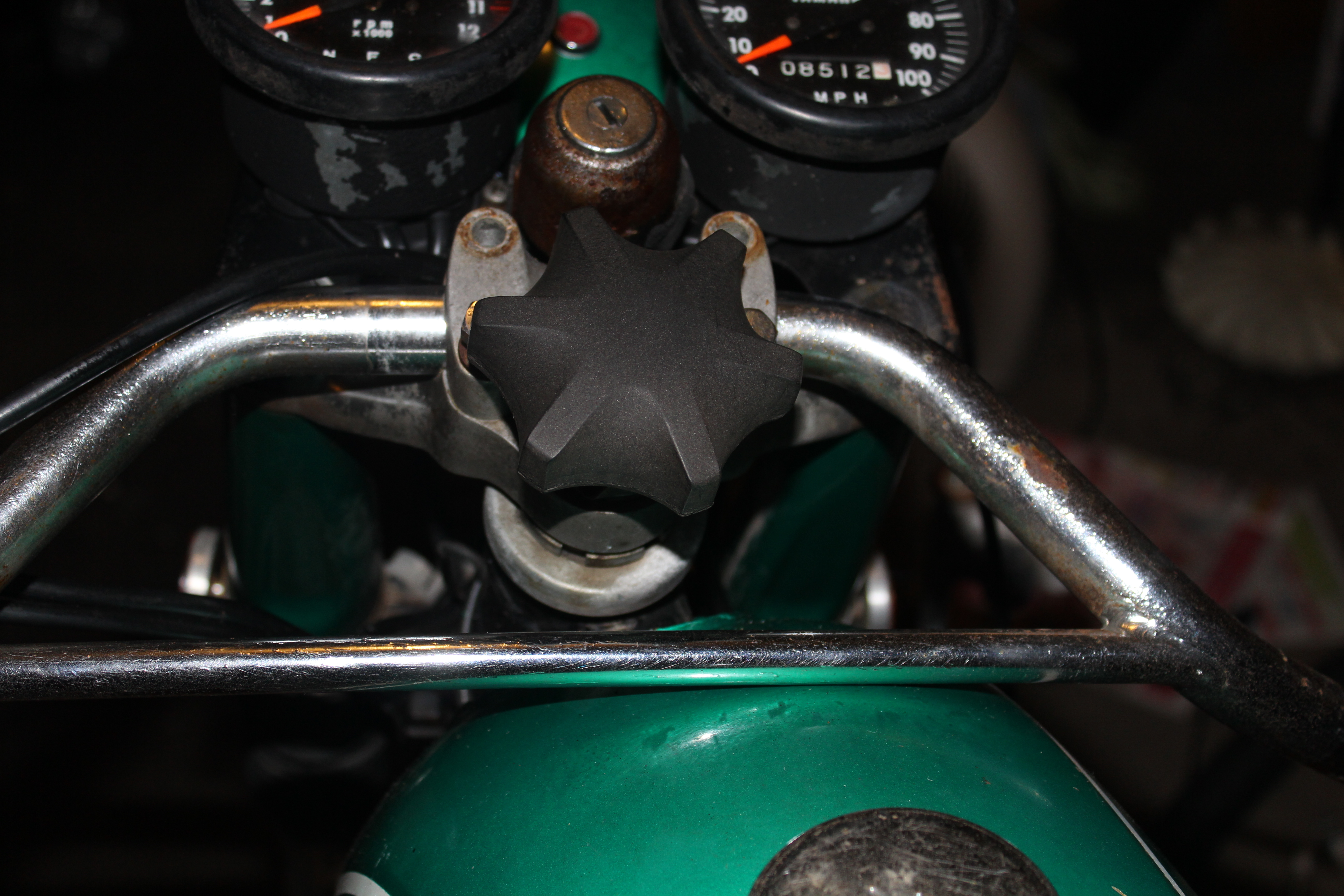

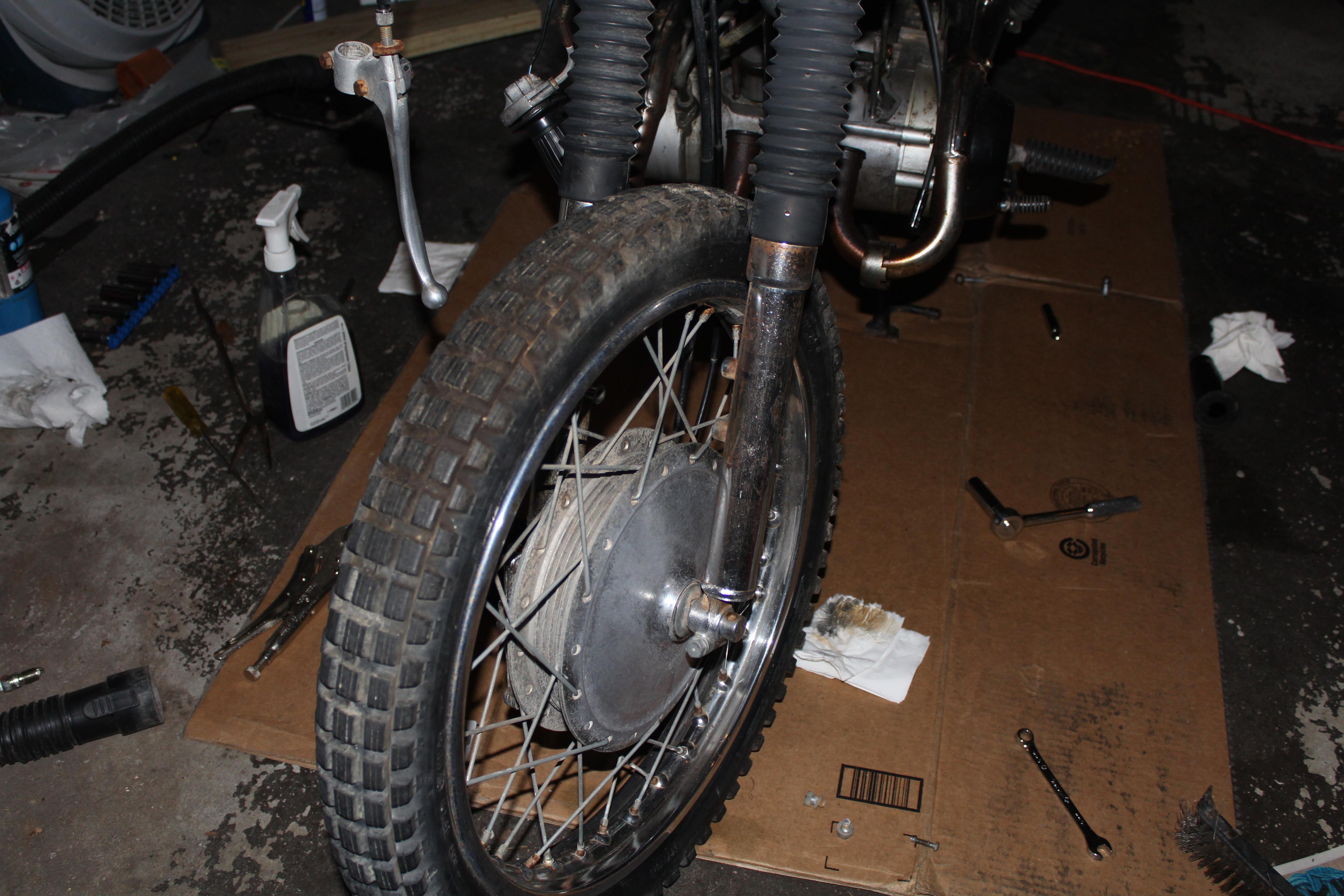

Today I pulled the front fender for cleaning and it looks rad, I also was going to pull and cut the bars but theres some sort of dampener in the way of getting the bars off. I need to figure out how to pull that damn thing. Pics in an hour or so.
A good place to look is cmsnl.com for exploded views.
Look underneath the lower fork crown. You'll see a cotter key, a nut and a couple of fiber washers. Pull the cotter key out and unthread the nut. The friction damper will eventually unthread itself and be out of the way.
Suggestion: put lots of WD40 or whatever antiseize compound you use, on the threads before trying to unthread the thing. Also expect a couple of fiber friction washers to drop out as you take it apart...
Pat
More photos, I haven't figured out how to add them into a body of text so you can just browse through them or whatever floats your goat. In this group I pulled the front fender, painted the muffler covers, cleaned the exhaust, cleaned whatever I could and am working on getting clubmans setup.
