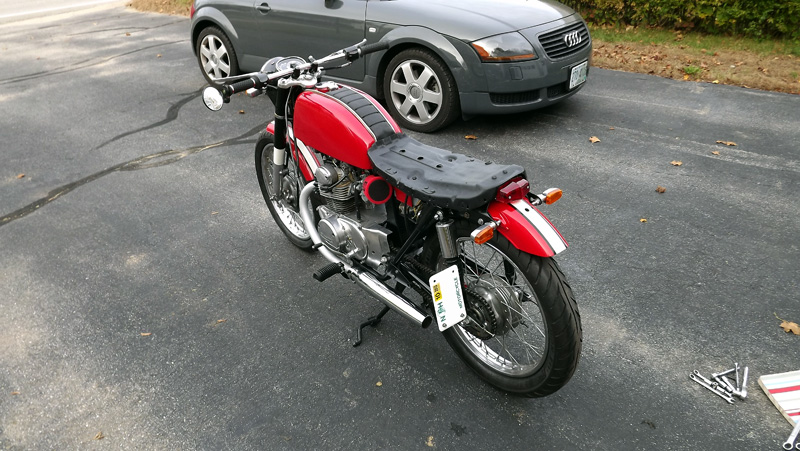

Spent most of the day riding, but got some more work done as well. Found the short in the wiring. Got the tachometer working. Straightened out the exhaust mounting. Got the new front brake cable installed. This one is even longer. Not sure how this is happening. I think I'm going to try and shorten it myself. I've found a couple of tutorials on how to do it. It doesn't look too difficult, but obviously something you don't want to screw up. Looking to relocate some of the exposed wiring.

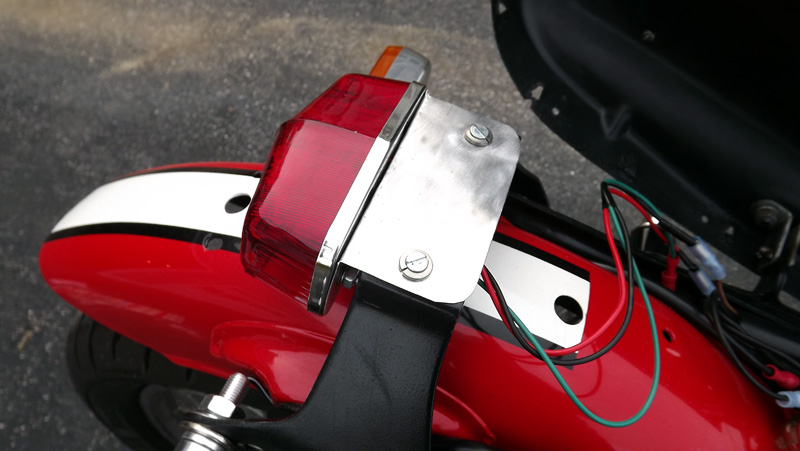

Finally took some pics. I put together a bracket for the tank. I wasn't sure if the CB200 tank strap would drop right on, and I also wanted to save some cash. It works well. Also made a bracket for the tail light.
