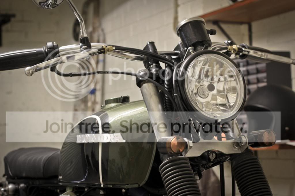

I've decided I'm going to trim the seat down. Much better flow and closer to what I planned originally
Re: Gentlemen's CB250 Brat Tracker
Hmm if you've got the time and money go for it for sure, look forward to seeing a pic with the updated seat.
Not to throw a wrench in the plans, but I think part of the problem is how high the seat sits on the frame rail. I like the weight of the bigger seat in regards to proportion. If you could take the bigger seat and sit it lower, even overhanging on the frame, I think it would be bang on.
Shamus,
The 72 CB's have stamped frame, so the seat pan is sitting on the flange rather than down on the frame. When I take the foam out I'm going to add a 8mm wire around the edge on the bottom of the seat pan to drop the "visual bottom" of the seat a bit lower.

Looking great, You decided not to change the seat, i seem to recall you saying about skirting the bottom of the pan?
Tom.
Tom, it has been changed.
I took a layer of foam out and ran a 8mm alloy tube along the bottom edge of the seat pan.
I also tidied up the leather where it is glued and riveted to the bottom of the pan to make it sit better on the frame.
It still doesn't sit perfect, but much better than what it was.
Oh I can see it now! It does tidy up the bottom edge of the pan in comparison to before, looks alot smoother.
Any chance of putting a video up, I think were all dying to see what she's like!
