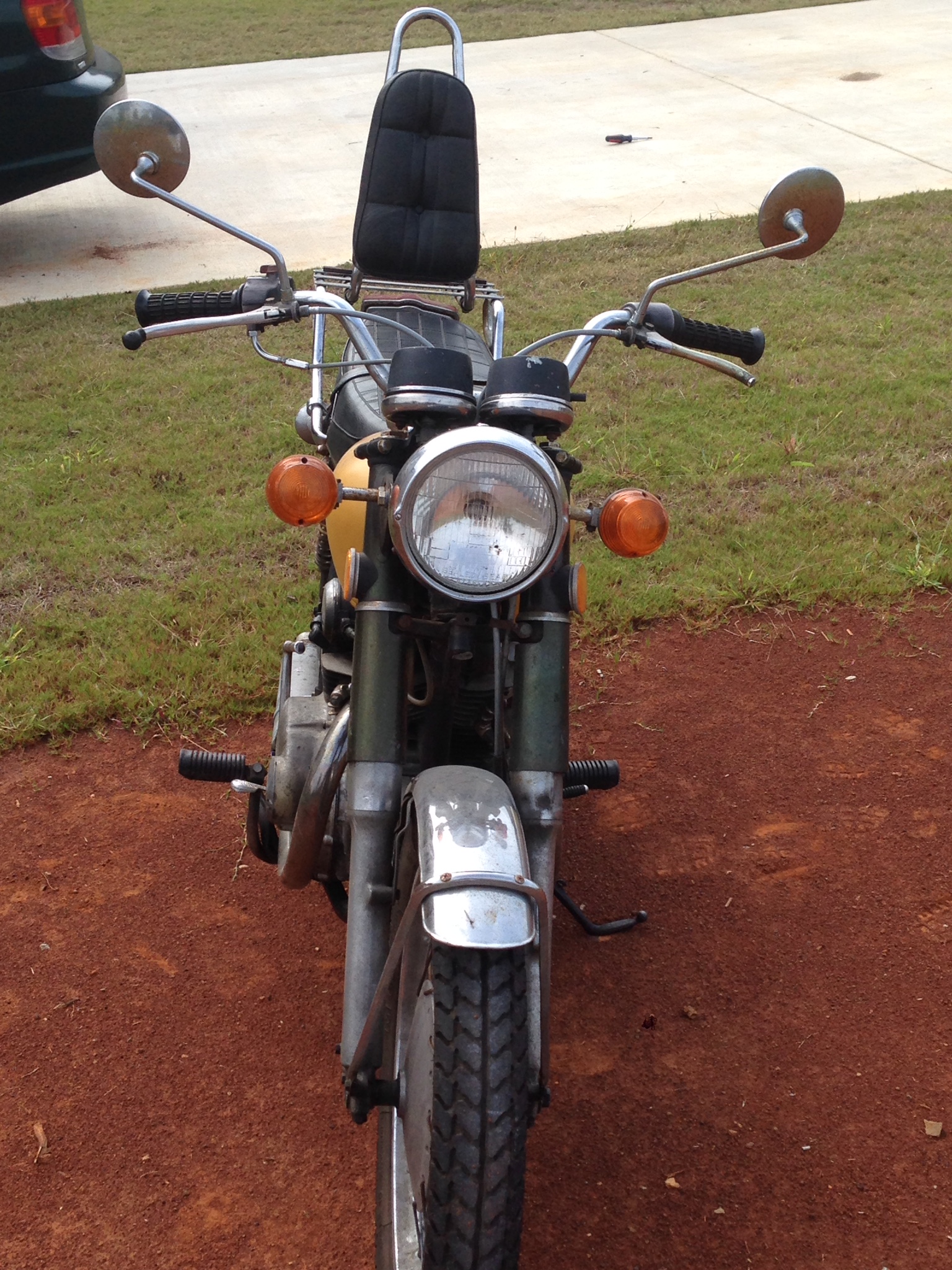

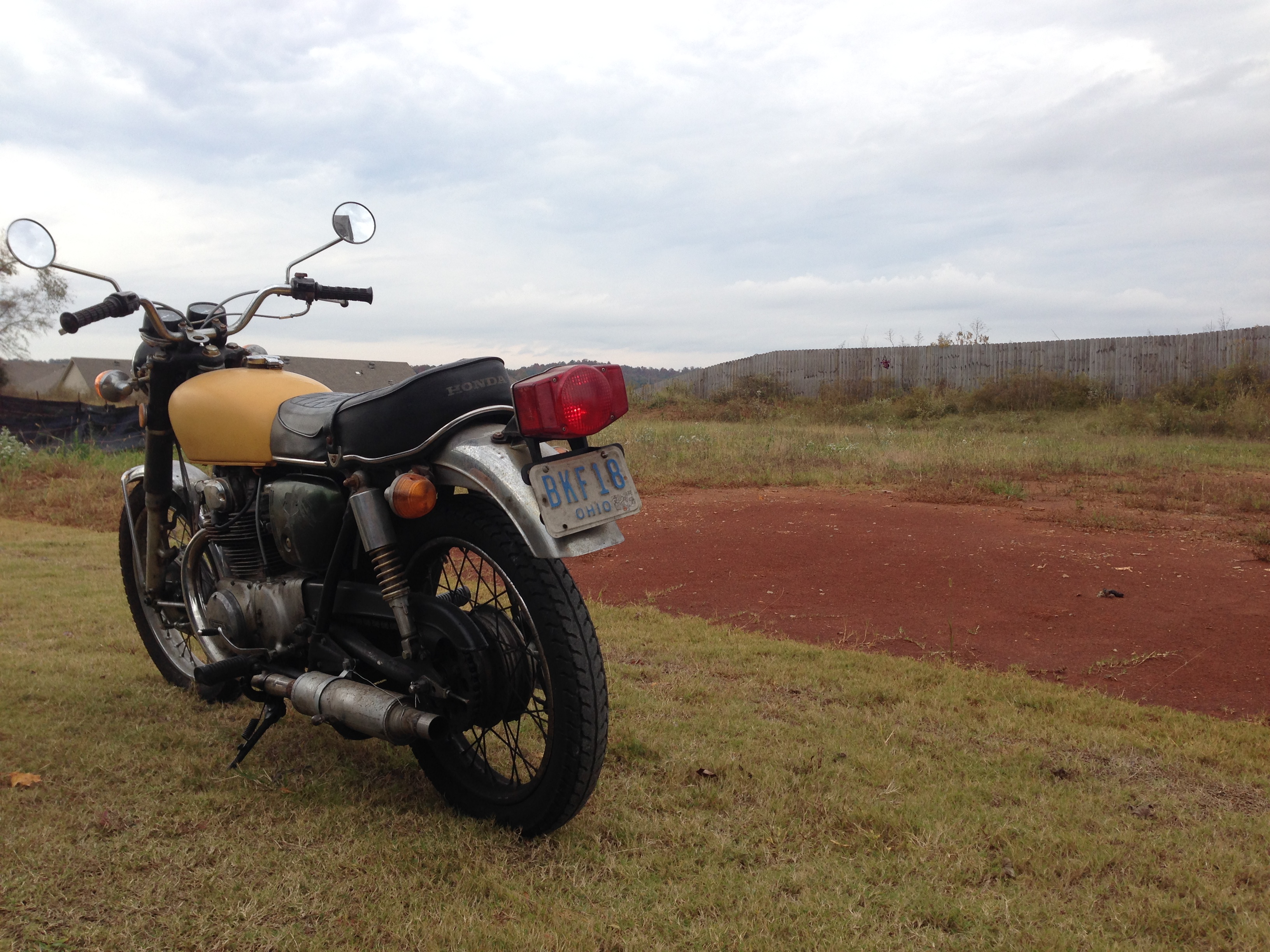

Picked up a 1972 Honda CB350 this past Friday (10/9/15). Thanks to twinsorin for bringing to me on his way to the vintage festival.
Runs, rides, and stops as it is right now. I've ridden it around a few times since it got to my house.
It needs a few things to be fixed to be completely road worthy. It's leaking oil around the shifter, low beam doesn't work, and flashers don't flash. So, nothing major.
I plan to work on it in phases. Phase 1 will be to get the few things that need fixed ironed out. Phase 2 will probably be brake and suspension upgrades. Etc......

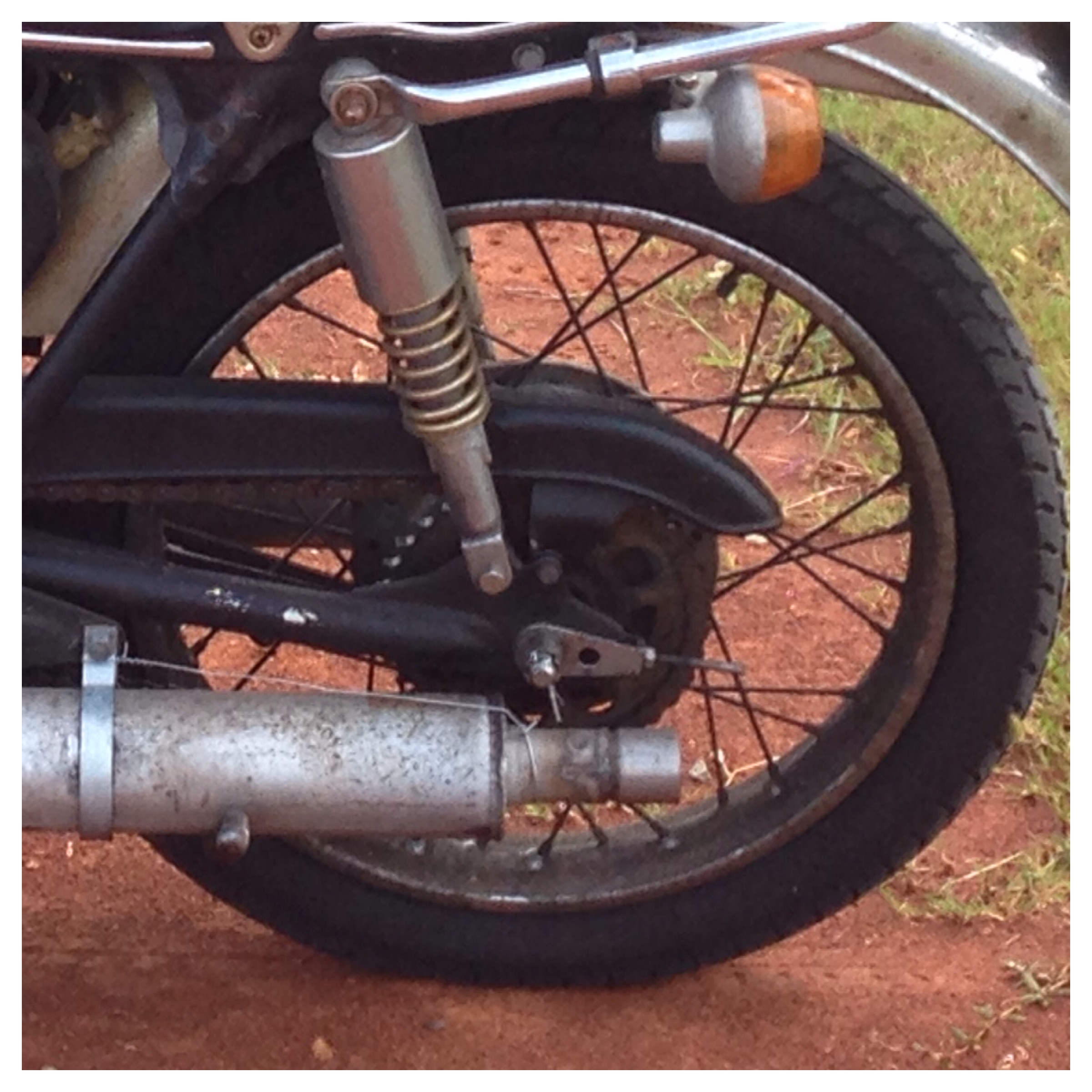

Looks like somebody made their own Kerkers.
Great bike, though. When I got my CL the flashers didn't work right. I cleaned every electrical connection on the bike and.. they still didn't work. A new relay from eBay did the trick. My low-beam doesn't work, either, but the high-beam seems to still have a few rides left in it.
Are you close to Western Hills Honda? They have a lot of vintage parts.
Re: 1972 CB350 Build
The PO said the mufflers were from tractor supply. They're on the list of things to replace. They sound surprisingly good for cheap mufflers.

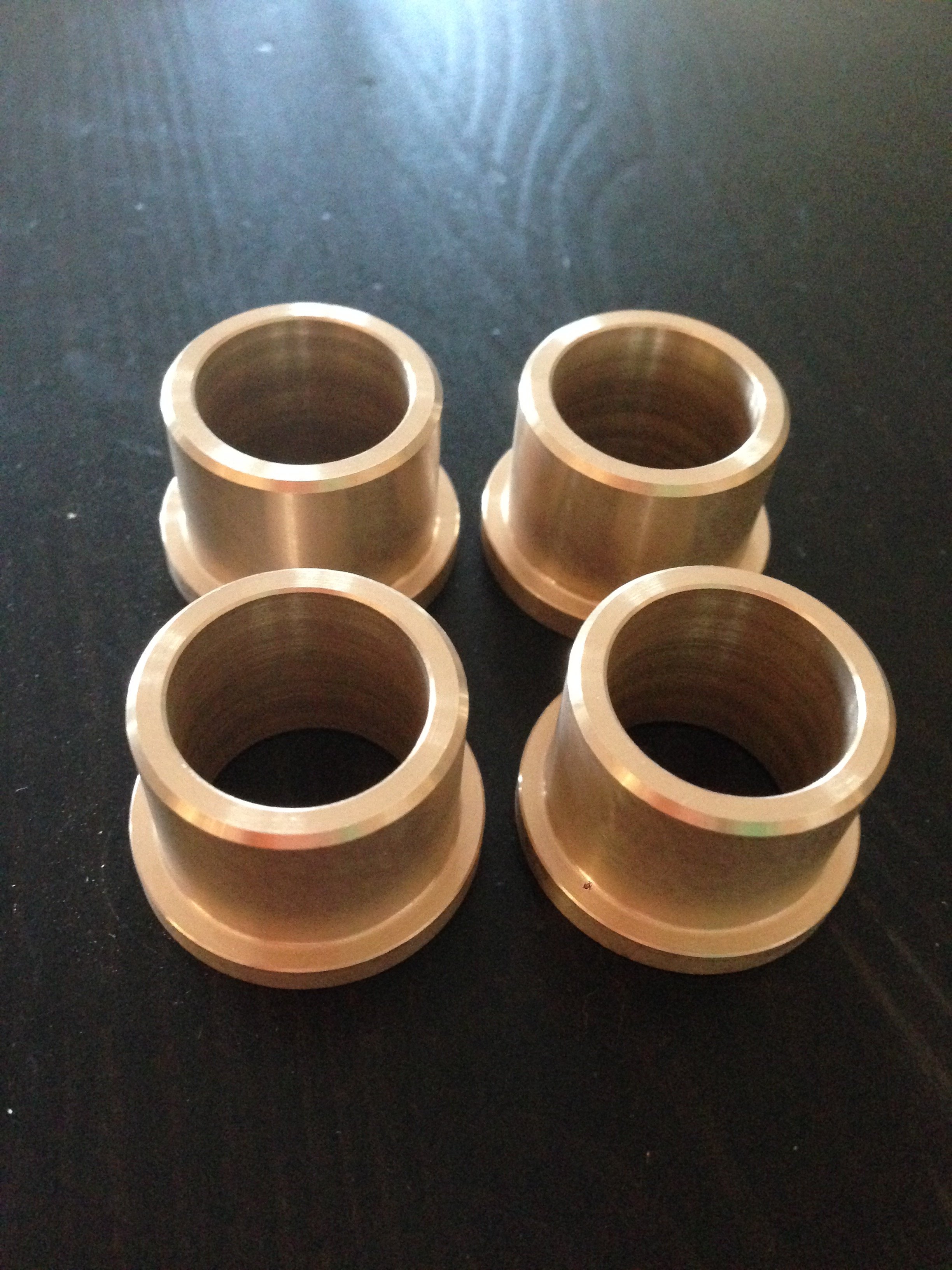

Have ordered a bunch of parts. First to show up is bronze swingarm bushings.

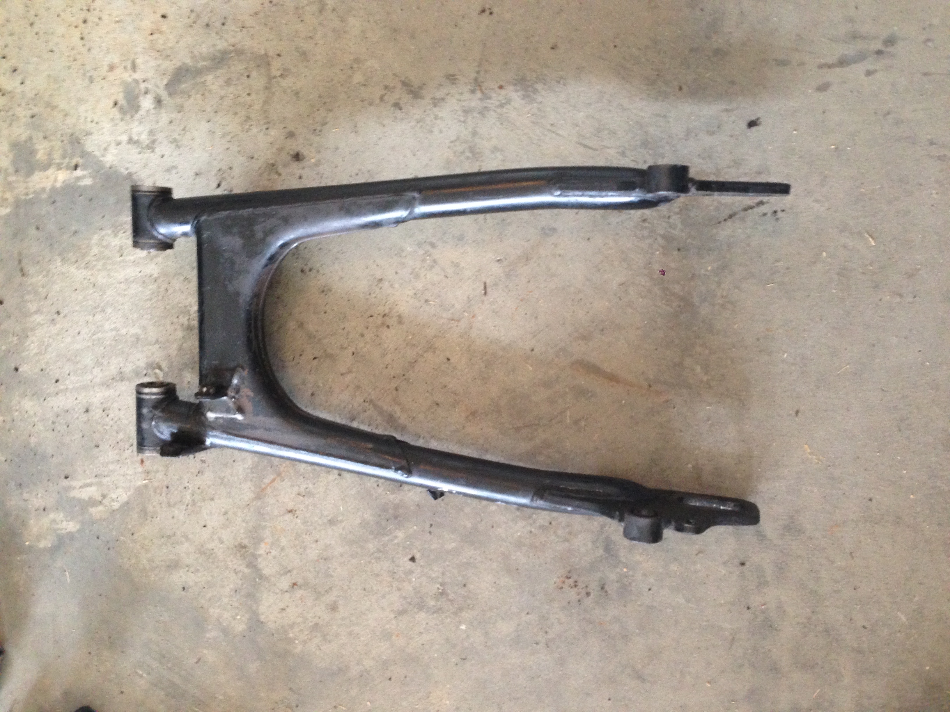

Couple quick updates.
Removed the swingarm. Knocked out the old bushings. Cleaned up the pivots. Scuffed it up with 320 grit. Waiting on things to dry out in order to hit it with a quick respray and reassemble.
Oil seal kit and chain arrived. Didn't get a chance to work on replacing oil seals yet. More parts scheduled to arrive tomorrow.

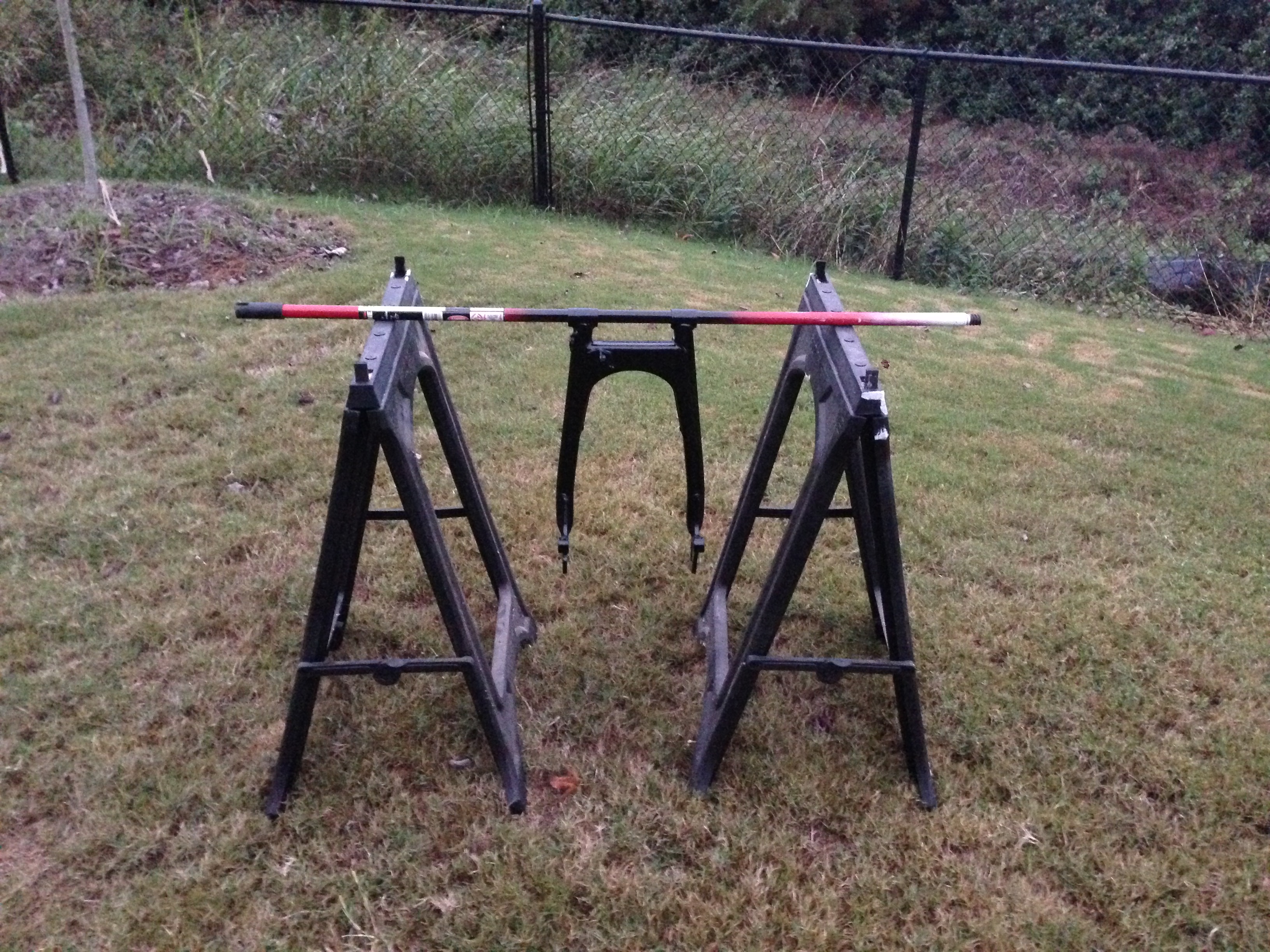

My painting jig for the swingarm. Nothing fancy. Main objective was to get the spots that had gotten knicked/scratched over the years covered.

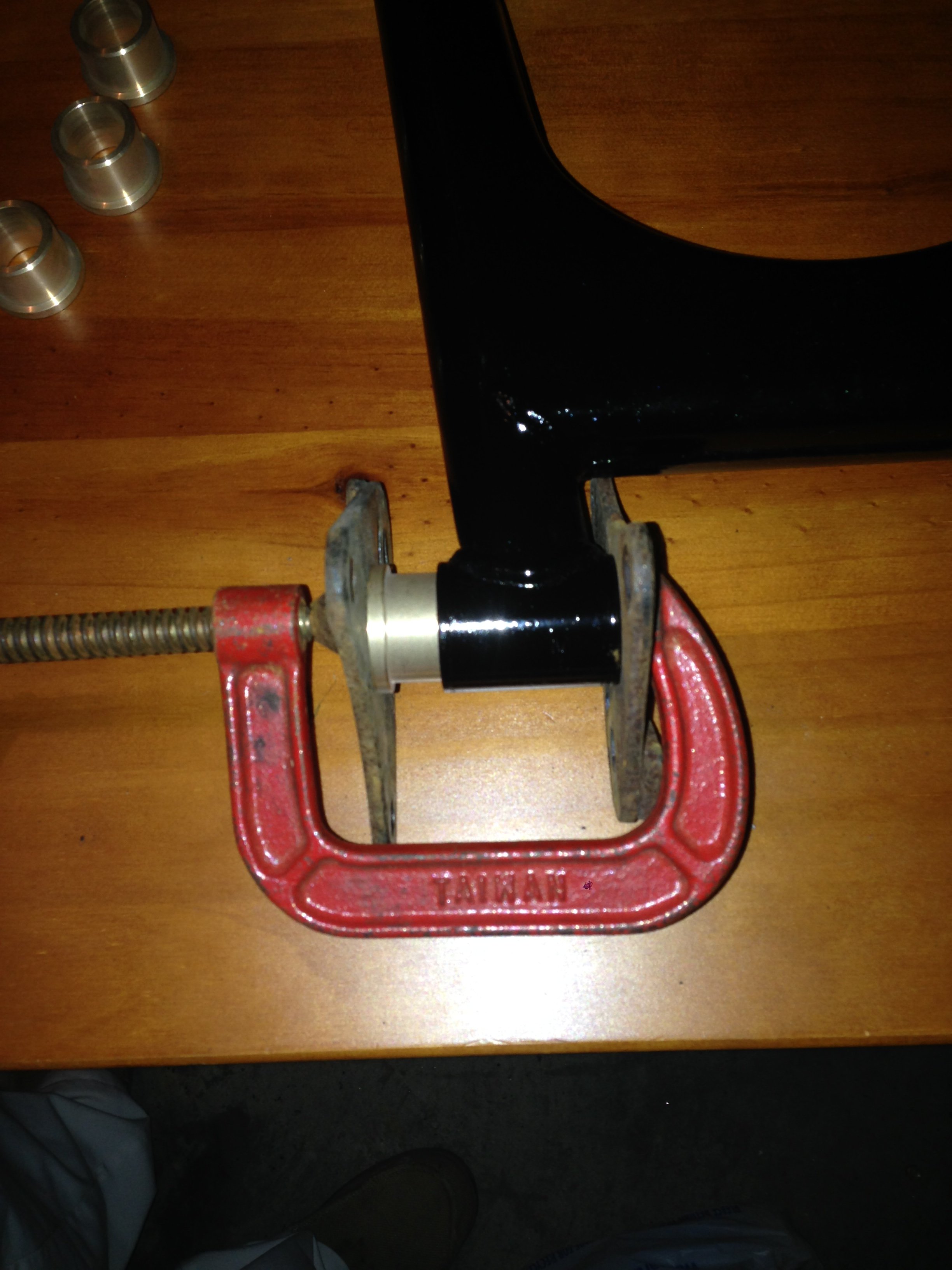

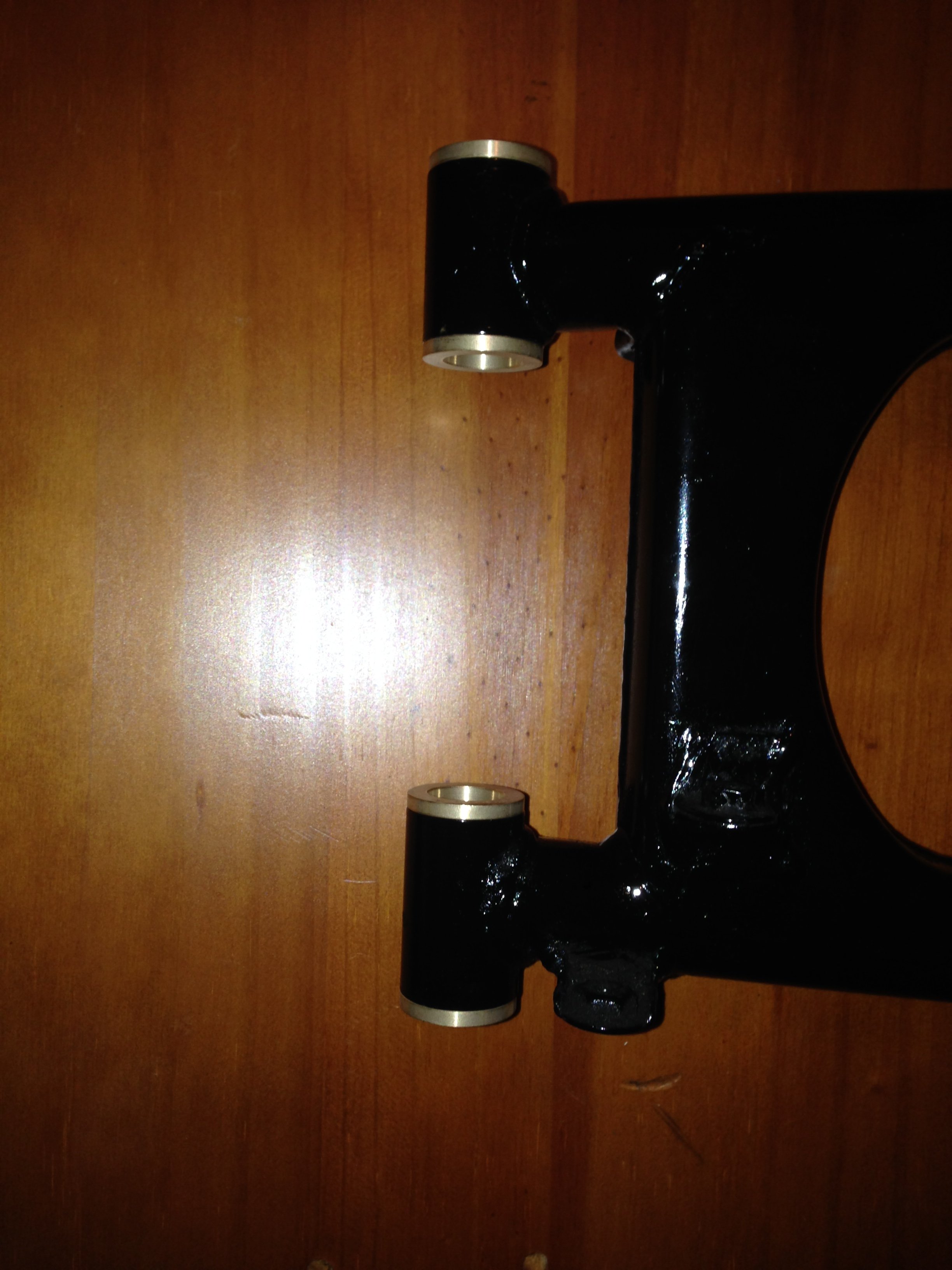

Had a couple more minutes to work while the wife was cooking dinner. Installed the new swingarm bushings. Note the fancy press.
Re: 1972 CB350 Resto-Mod

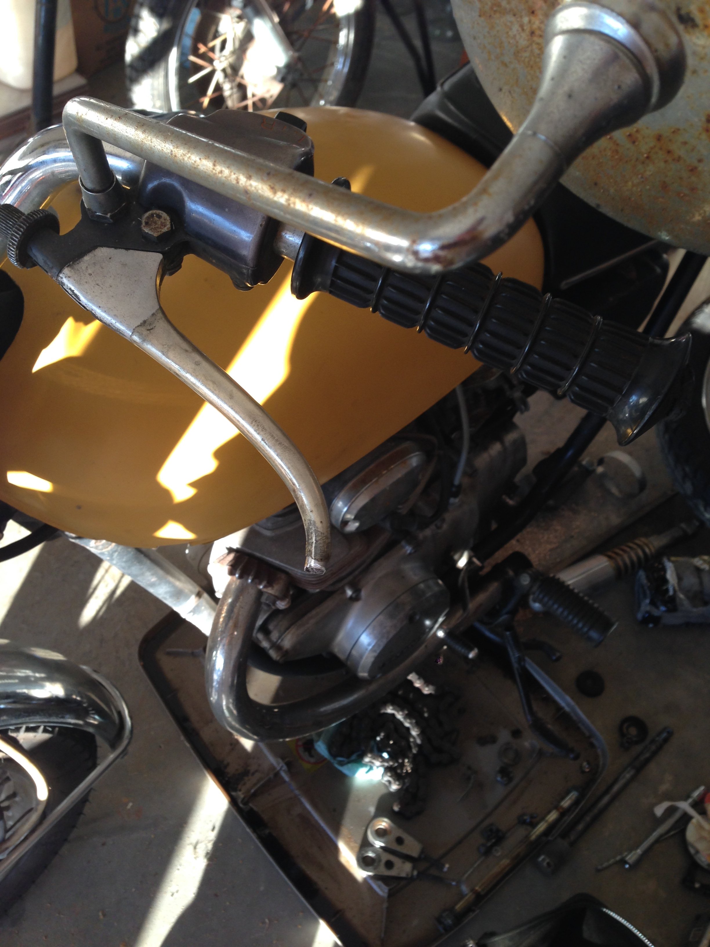

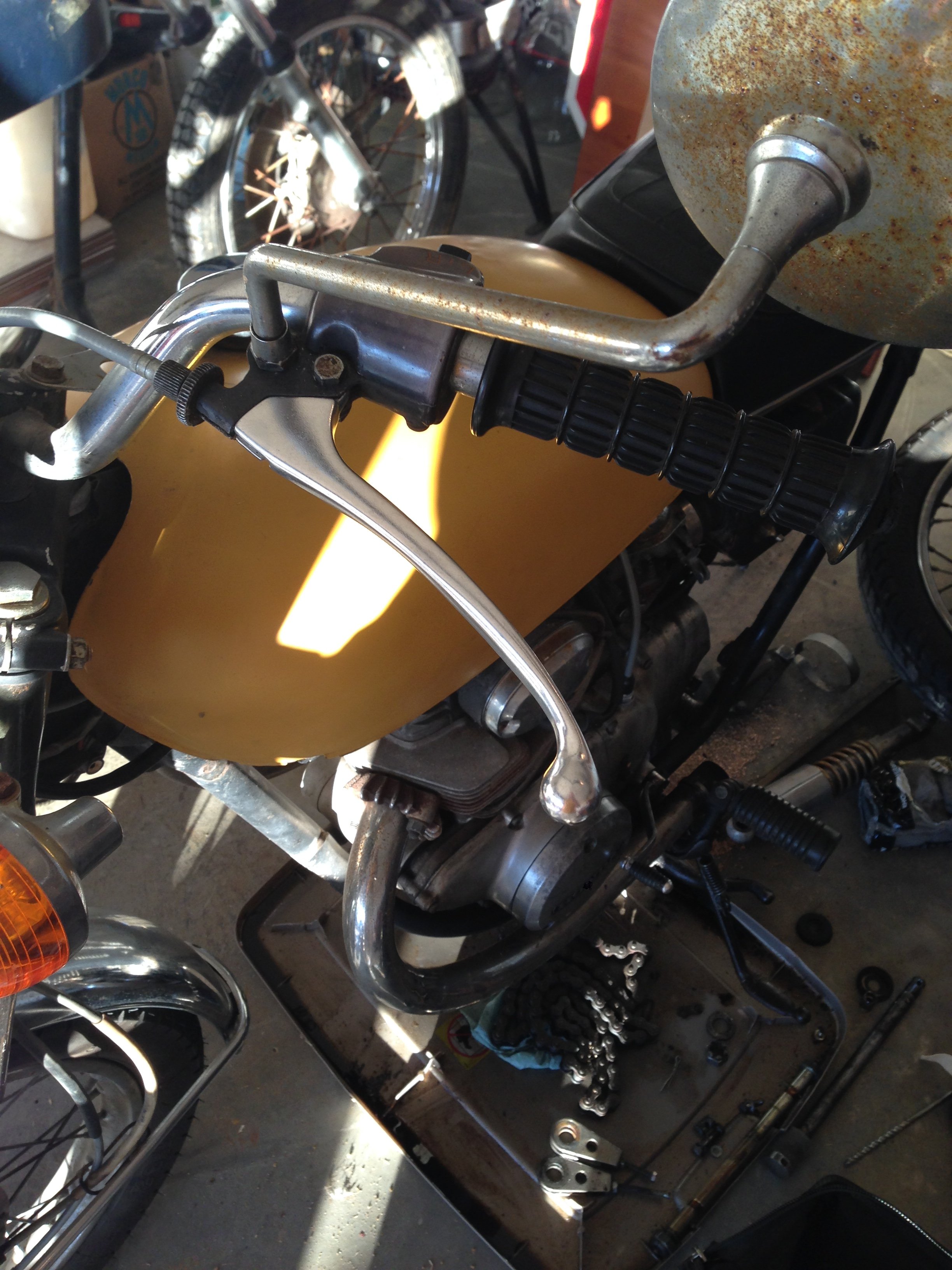

I have replaced the oil seals behind the shifter cover. Should have fixed my oil leak issues.
The swingarm is back on with the new bushings.
Have mounted a new 110 back tire with the help of Kiley Owen. Going to replace the bearings and the brake shoes before I put the wheel back on.
Working on cleaning up the back wheel. Pretty happy with how well it's cleaning up. Here's a before and during picture.
