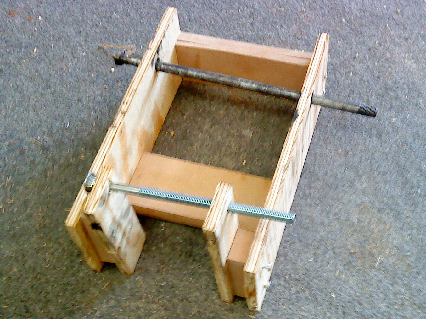

Anyone have any advice on a motor mount? Should I try to just make one out of wood or are there any reasonably priced ones out there. I don't have time to look right now.

A lot of people make an engine stand out of angle iron; I have one for the 450 engine that bolts to a larger engine stand on wheels. If you happen to be going to college in Kalamazoo you are welcome to borrow it :)
Well shit, perfect offer except I go to TTU. I guess It's back to the plan of trying to make one out of wood. Cant be too hard for a table top engine stand.
I made one out of wood I had lying around. Mine started to come apart near the end as I kept moving it around to paint the engine. Hopefully you can make a better one. It served its purpose though.
You can use 1/2" allthread if you do it that way. Forgot about that!

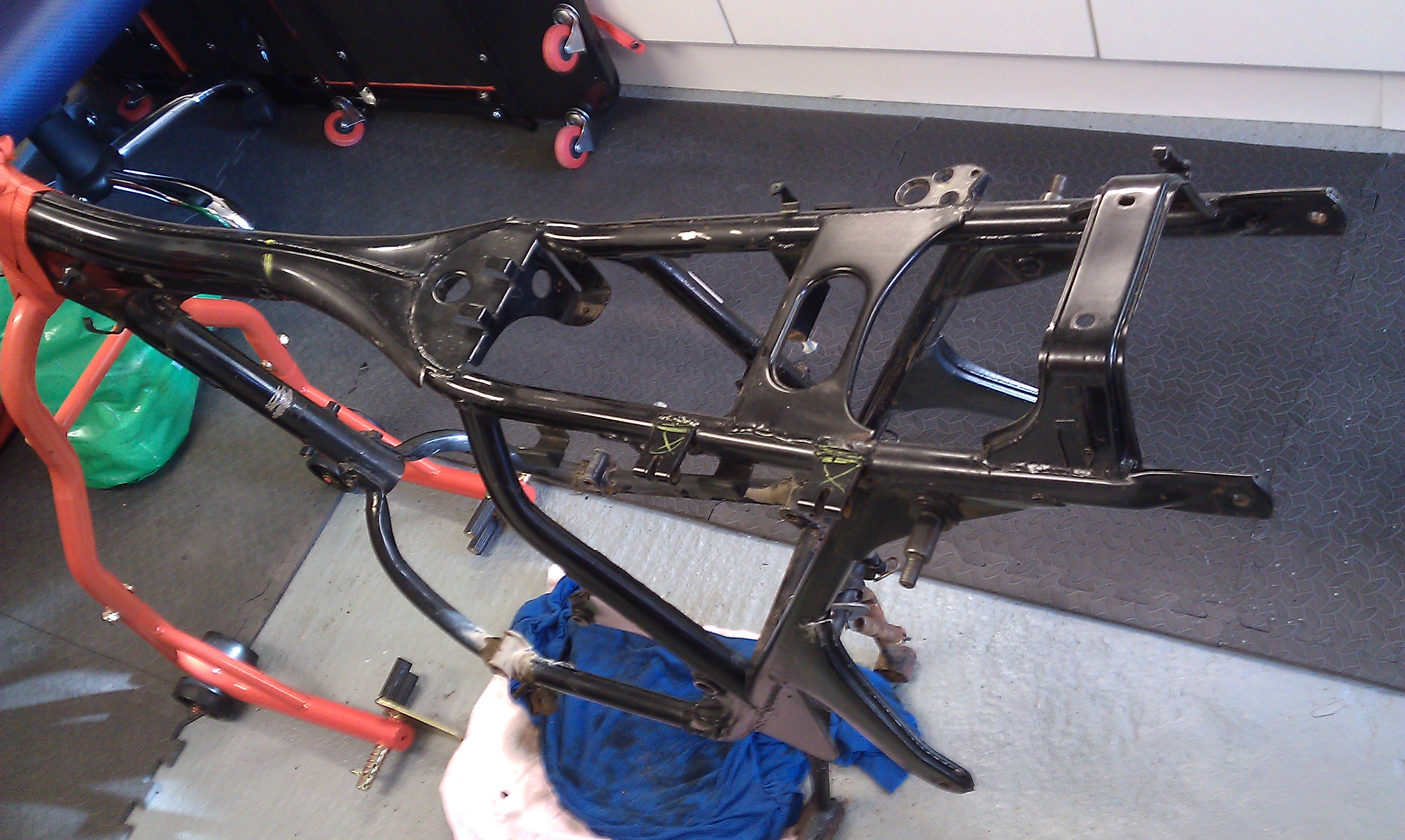

I got the rear wheel, shocks, and swing-arm off the frame today. Definitely looks like the rear drum brake is in need of some love. Anyways, what was concerning me, and the only reason I'm taking time to post now, is that I think my frame is bent slightly. Bottom two pictures show that at least where the level on the frame is is level, and then a further view unobstructed. Am I crazy or is it slightly bent? Is it a huge deal? Can I bend it back to straight or just not worry about it? I have a feeling the last person to drive it somehow bottomed it out hard and bent the frame a bit. They did have a dirt tire on the back after all.

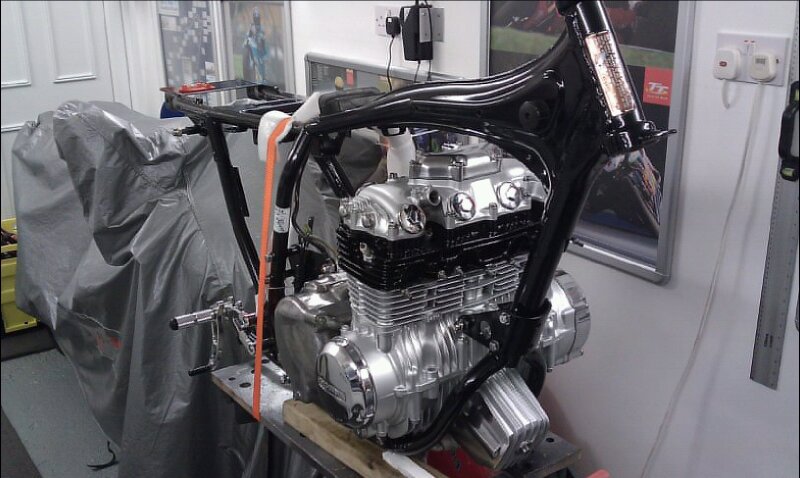

Hi mate looks like a great build thread goin on there, torn down well , the frame aint no problem so u aint gonna worry bout it thought same bout mine cb350f '72 but everything was ok it aint finished yet and its my first learnin so much as i go along the gunge in the oil is just a bit of condensate with been stud so long check inside top of oil filler plug too that collects plenty too will follw ya threadsw mate good luck if i can help answer any questions i'll give it my best shot got a bit slow here on my build British weather dark wet miserable just like the art of carb syncro haha .

Alright, Made a little more progress tonight.
Was waiting to touch the motor until I had a mount built, thing is just to wobbly otherwise. So a I decided to make a good few measurement of the motor and mock up a mount I could make out of wood. Using a 2x4 and some steel rods I was able to make a pretty decent mount for the motor. Now comes the fun part, tearing into the motor and finding what else needs to be replaced. Gonna love coming back from Japan and starting to put everything back together.
