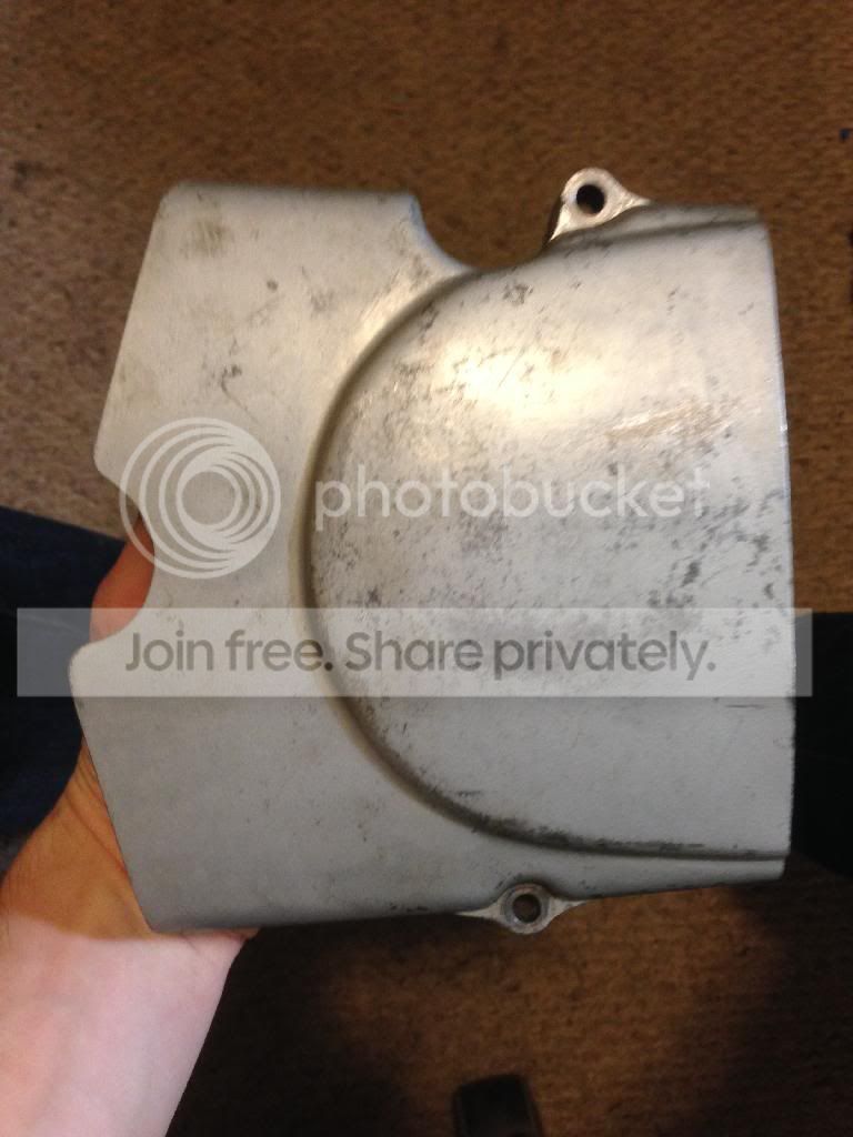

Couple days ago cleaned up another cover:
Before:
After:
Also finally got my frame where I wanted, cut off some tabs for side covers and also a helmet lock that was welded to the frame. Then got it all painted up, getting me a lot closer to starting to put the bike back together.

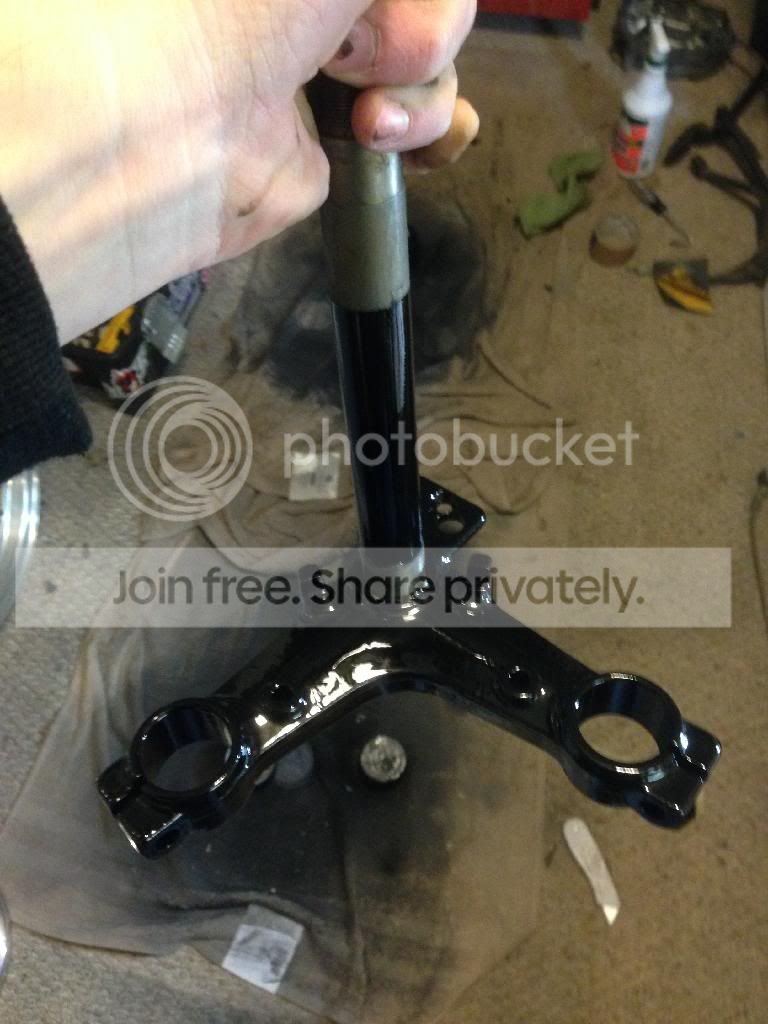

I'm not absolutely sure, but it looks like you may have painted the bearing seating surfaces on the triple tree.
Looks like you're making some pretty good progress! Your engine is going to look awesome
I did but cleaned them off and regreased everything, they were all gunked up anyways so they had to be cleaned up anyways.

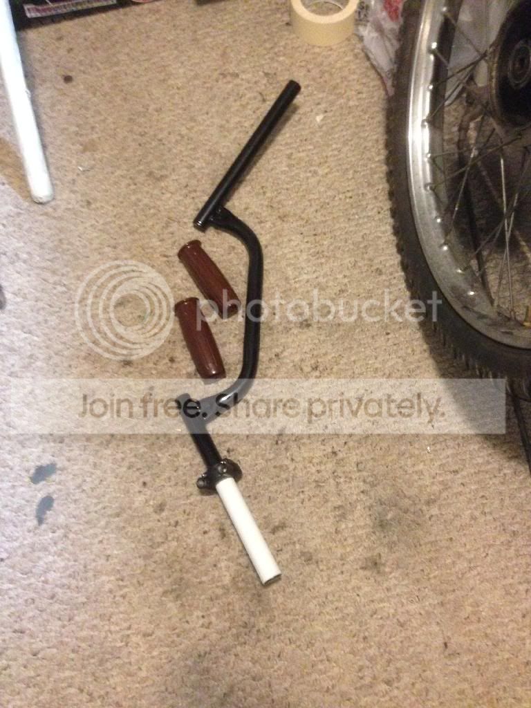

Yesterday my bolt kit, gasket kit and headlight bracket showed up and today my bars, grips and throttle came. Couldn't help myself so I put the bars on and also put my back wheel on for a temporary set up as its in pretty bad shape.

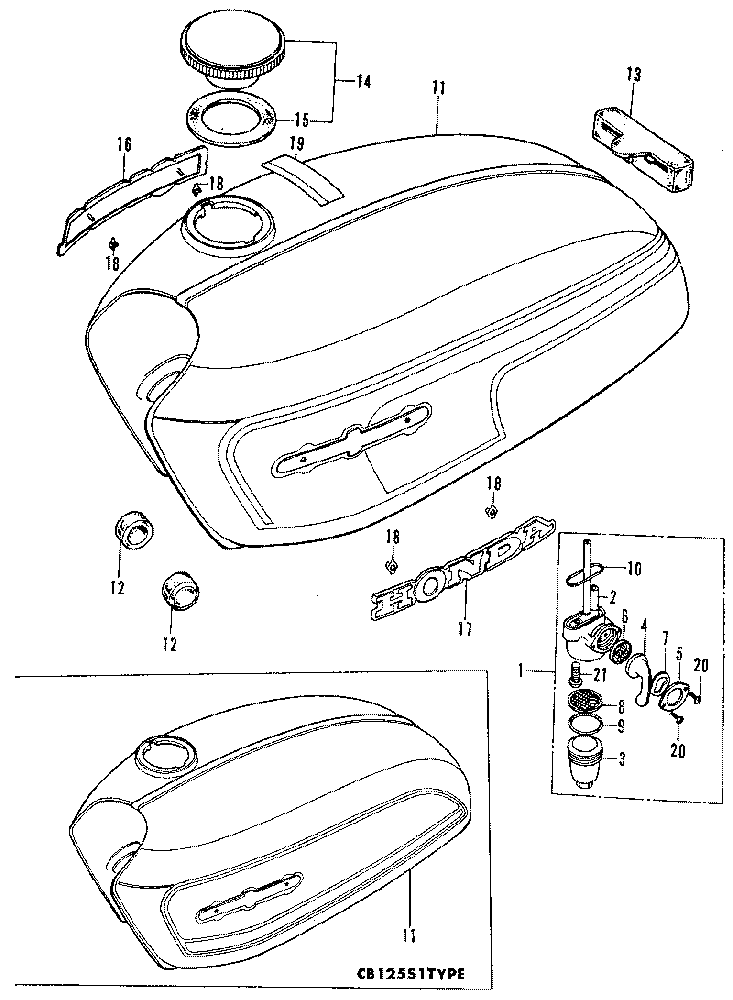

Took the decals off tonight to get ready to strip it down, noob question but how does the peacock come off? I'm not seeing any bolts on the outside of the tank to remove it?
If it's anything like the CB125S petcock you'll have to remove the bowl at the bottom of the petcock and there will be a bolt inside that. Here's a diagram which shows it. Part #21 is what you need to remove to take off the petcock.
Ah I was right there, just didn't remove the black circle, thanks, I was searching for that breakdown but couldn't find it

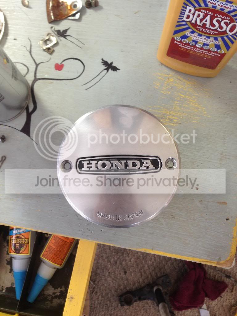

How did you get those engine parts so nicely shined up?
BryanOC6 said:
Looking good!
I am busy with a restore of a Honda xl175, looks similar to your 125
First clean them up, then wet sand with 1000 then wetsand with 2000 then polish them with a metal polish, I do it by hand but some use power tools
