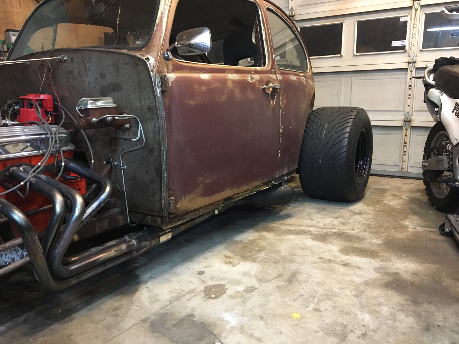

I decided to do away with the high pipes and go a bit more subtle on exhaust.
Any plans for rear guards?
To me it looks a bit naked back there. I think a nice styled guard rolling out towards the tyre from the back window but not covering it entirely would look rad.
irk miller said:
Thanks, Luugo.
I may be the odd man out, bit I like these pipes much more better
It was one of those deals where I put so much time and effort into pie cutting and building those pipes that I really wanted to make sure I was comfortable to cut them out. It was different, and for that I hung on, but I agree that the low pipes look better and make more sense. I was also afraid low pipes, especially with a can this size, would be too low. Once I put some miles on it, I knew what clearance I needed. Plus, I raised the rear end an inch, and I may go a bit higher, which will get me more clearance.
I plan to box the OG running board channels and smooth all that out in the least. With that, I also think a lot about doing a guard similar to what they run on Baja Bugs. It's still up in the air whether or not that will happen. I also think about doing some sort of fender back there.
