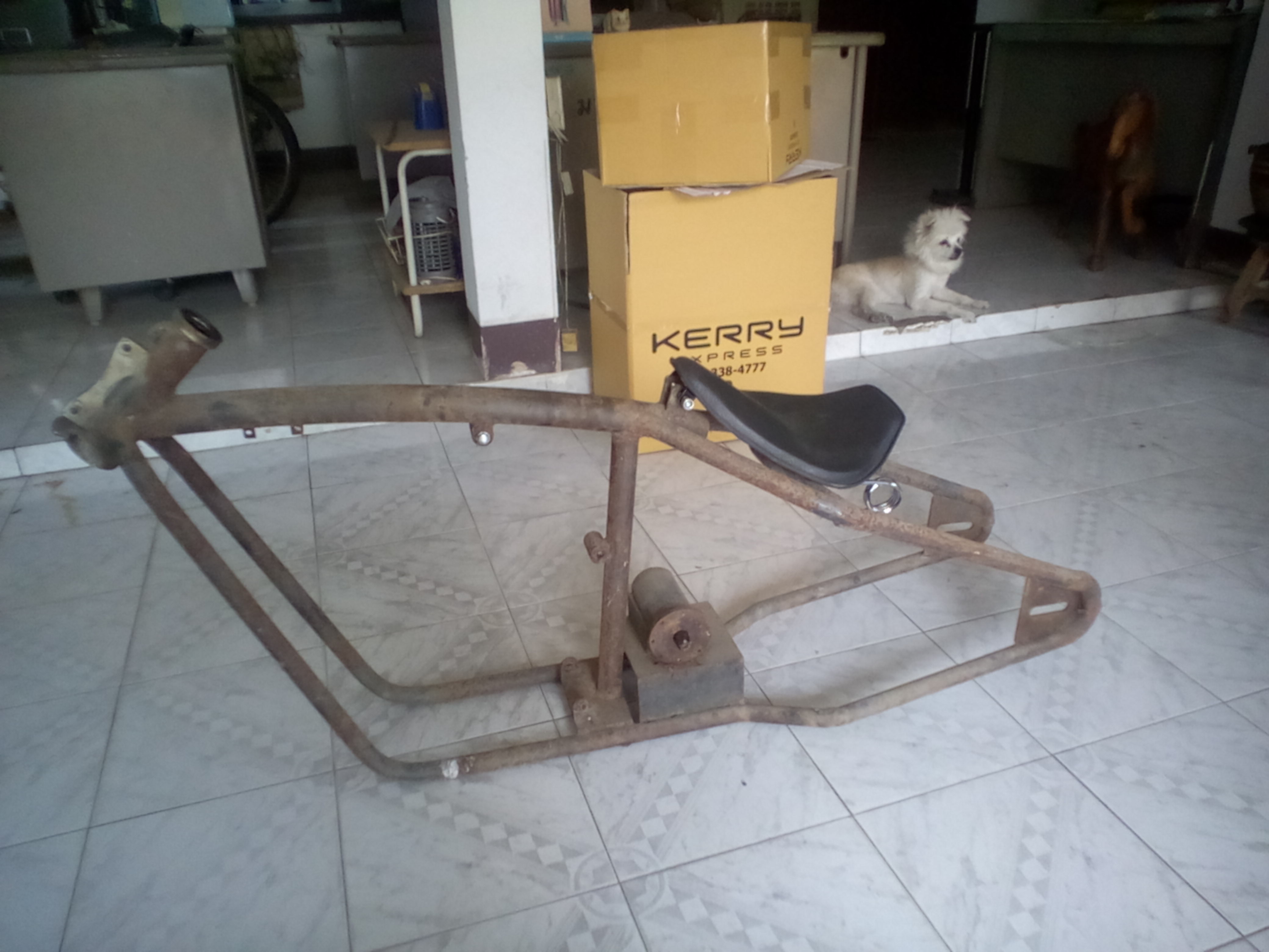

Did you ever create a top engine mount for this?? I have a Custom Hardtail frame I am putting Boxer 200cc in. Boxer is Thai version of Honda/Lifan 200cc motor.
I would also like a good picture (s) of rear and front mounts too Multiple angles would be great!!
If you are using factory mounts can you supply Model and year or part number? (s)

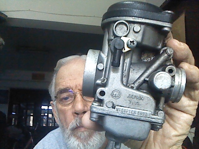

Attached photo of Carb will work / works great as it is original for 200cc engine... I have several!
