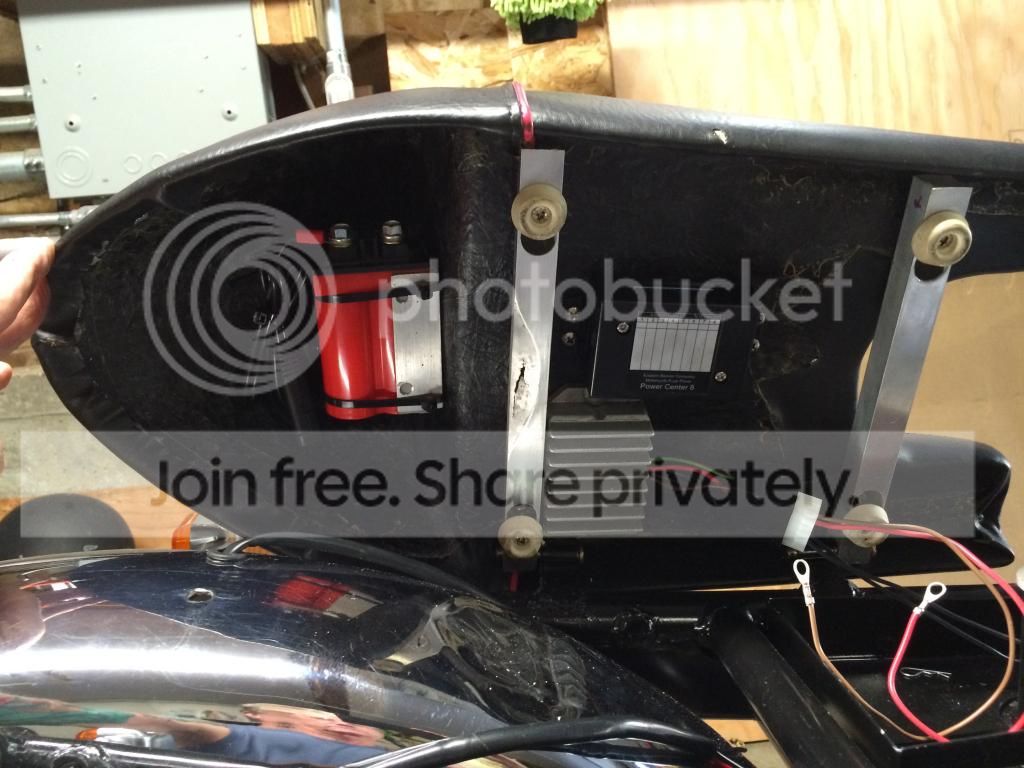

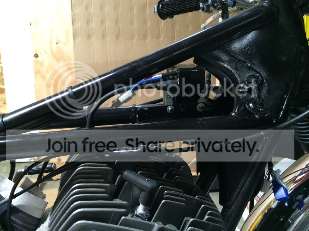

Yesterday was a good day of finalizing locations for electric components. I used a universal turn signal relay and mounted it under the seat with everything else. The main Eastern Beaver fuse box has it's own relay also located under the seat that is triggered by the ignition switch powering up the ignition and lights. I tied into the existing wiring for the handle bar switches under the gas tank. This allowed me to create my own wiring harness to bring it all together. All the existing switches including brake light switches work just fine. I've still got to tackle connecting the Acewell speedo. I'm going to try a universal spoke mount magnet for triggering the speed's sensor. I've also got to sort out my neutral light connection and tie in the speedo to the turn signals to the speedo indicators.
I drilled my polished headlight bracket to mount classic small rectangular turn signals. They barely fit behind the headlight. I'm also still doing Loctite of all new components as well as final adjustments to rear sets and locking them into place. That will be done today.
