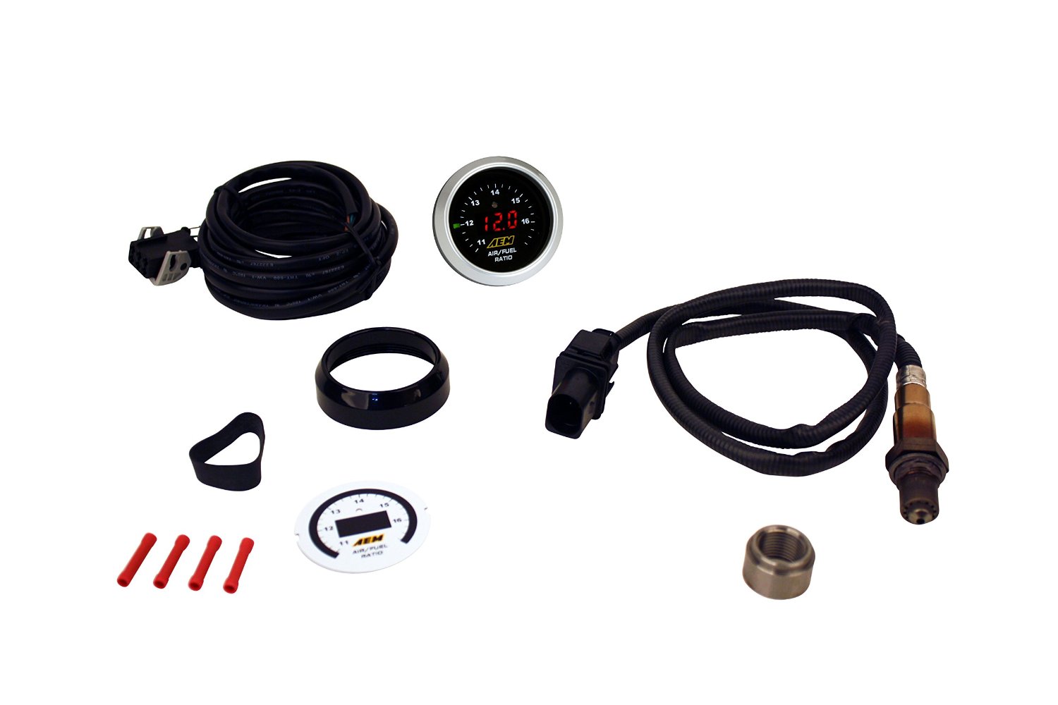

Since i'm tired of guessing with carbs, this just happened.

CarbsAndCylinders said:
Who makes this one and how expensive is it. I would like to get something like this.
It's just an AEM wideband air fuel meter, and 02 sensor. I'll weld the bung into the exhaust and tune accordingly. I think it was 180 with prime.
