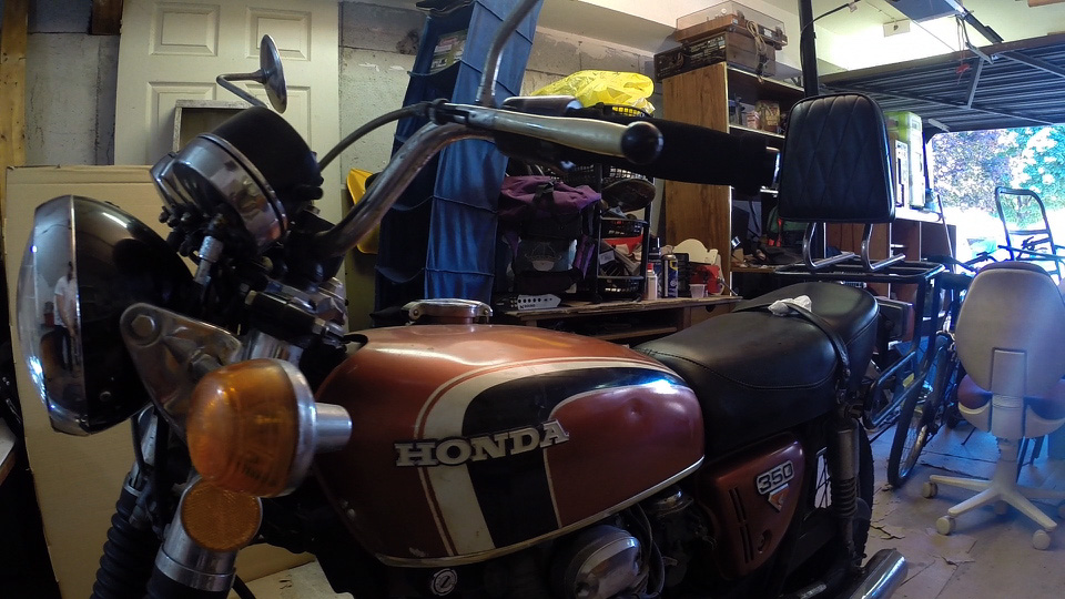

I love motorcycles. This is my 4th one and I decided it was time to take on the challenge of rebuilding a bike myself. I am not a mechanic but can be resourceful when I need to be. I love learning. I love wrenching. I respect wisdom. This is why I am posting here, to learn from others, get advice and guidance along the way. I work on a computer from Monday to Friday but just can't wait for Saturday's wrench! 8)
Here's what I'm dealing with:
It's a 1973 CB350G (the one with the front disc brake). I purchased the bike for more than I would like to admit ($1500) and it was not running ( I know, I know..). I justified the price because CB350's are in demand in the area I live in and there are not many around, especially so close to where I live. Also, he gave me a box of parts with it. I was happy. It had been buried deep in his garage for approx 3 years and was starting to get some surface rust and a whole lot of cobwebs. It has approx 33,000 miles (seems a lot but I intend to rebuild the engine), battery was dead, 3 yr old gas in the tank with rust inside the tank, engine turned over, brakes not ceased, tyres almost brand new. I came to the conclusion that the bike was well maintained and decided to go for it.
What I intend to do:

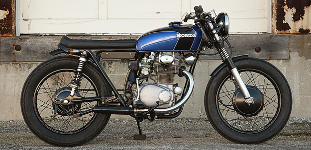

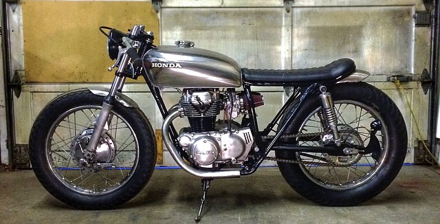

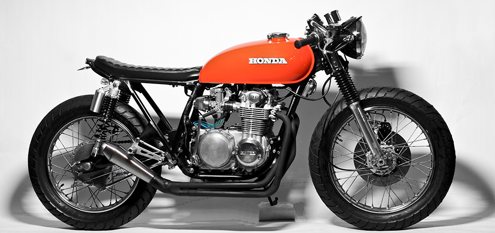

Here is some inspiration pics for now that I have gathered from just doing a little research online. I don't know if I want to go with clip-ons or clubman style. I don't think I will go with a cafe style seat but rather a more bobber style with the end kicked up slightly so it's not like a diving board.
Build progress pics/video to come. In the meantime does anyone have any advice for cleaning/shining the aluminum parts?
I would like the side covers to be nice and clean like BOTs bike (black & orange 350 below).

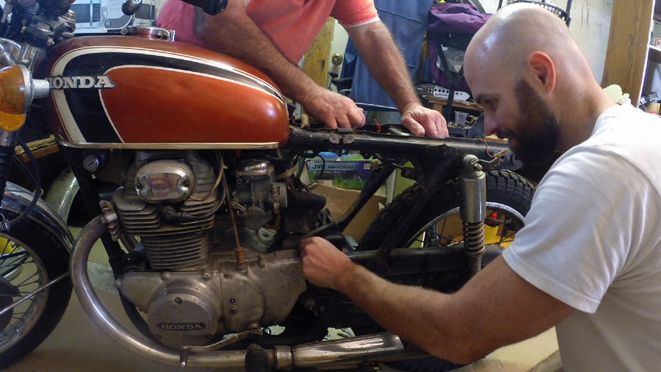

Back to the progress! My first teardown session went pretty smoothly. I am learning a lot as I go and just taking my time with it. Again, if you see or read about me doing anything out of the ordinary I would love to hear your feedback. I want to learn as much as possible.
Please excuse the mess in the background of the pictures and video. It's not my house and I don't live there but if it were up to me, 90% of the stuff would be in the junk yard! I'm working with what I have and things are getting done. I plan to organize more over the holidays.
I will be documenting this entire process on YouTube. I plan to even visit/interview some mechanics/builders/fellow riders for input down the road so it should be an interesting series to learn from and I hope you subscribe and follow along with me.

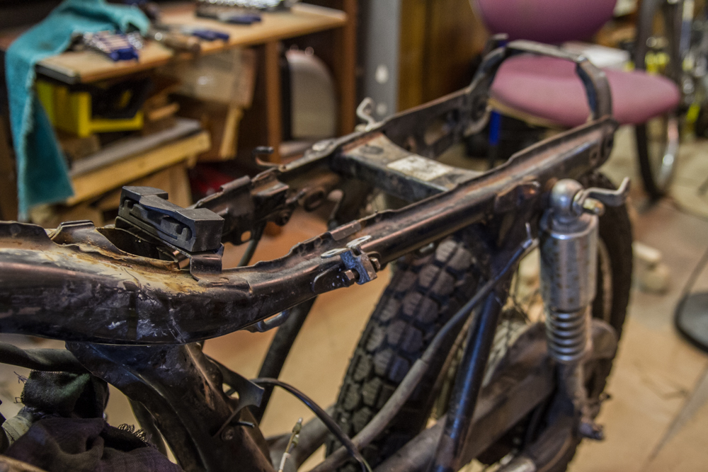

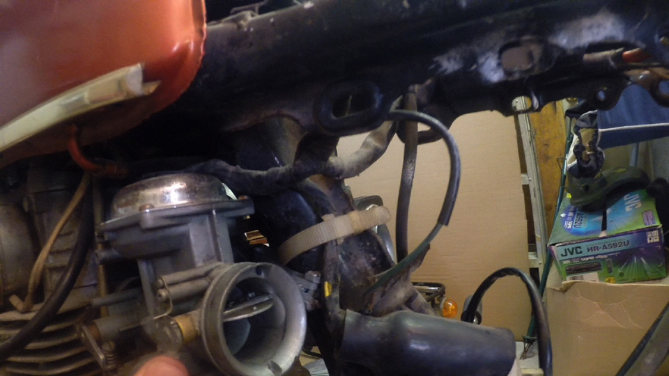

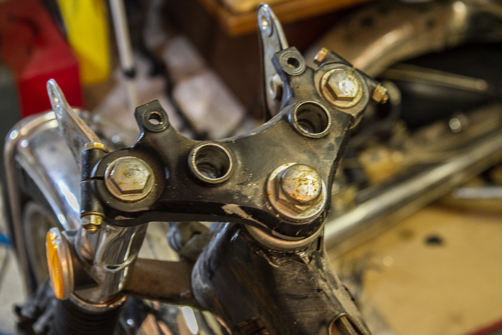

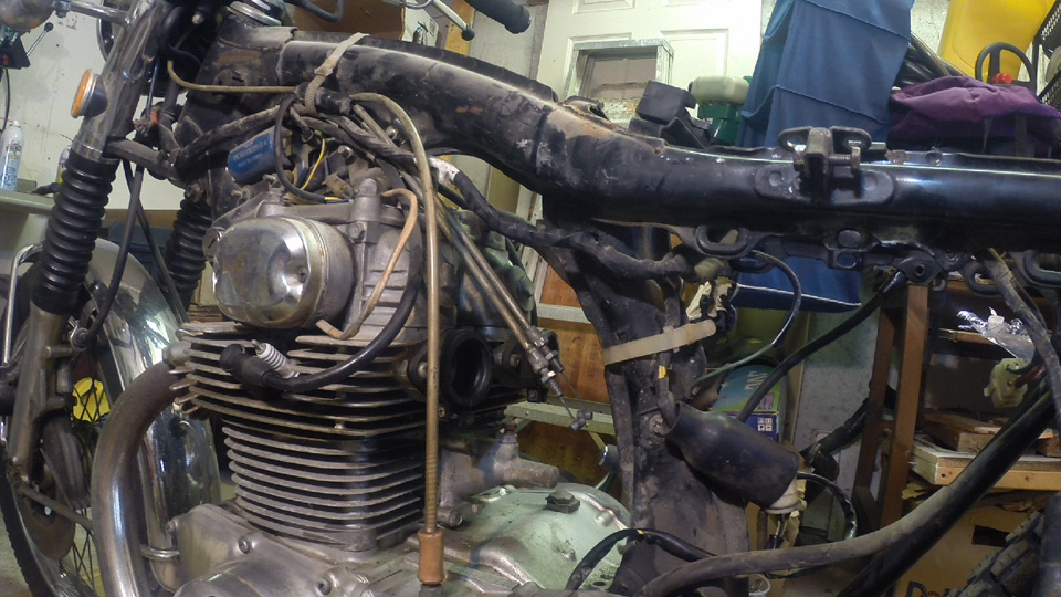

For my second session, I removed the tank, carbs, exhaust, headlight and the electrical harness. The tank is very rusted inside and will need a good wash. In my research I found that vinegar/water and some loose ball bearings or small nuts & bolts with a hefty shake and left for 24hrs is a good cheap way to clean out most of the rust from inside the tank. Can anyone attest? Have any better ideas or recommended products?
While removing the tank I spilled a bunch of gas out of that cross flow tube that's under the tank. Is this just to distribute the gas evenly in the tank? If not what is that for? What if you need to remove your tank on the road and it is full of gas, is there any way of removing the tank without spilling when detaching that cross flow tube or is this normal? The gas sat in the tank for 3 years, so it was pretty smelly. I got a good buzz emptying it though haha..
While I was taking out the harness I was making notes as to where things came and went. I have to admit I a little intimidated before exploring it, but after I took it all apart I realized there's really nothing to it at all and am looking forward to tackling the wiring myself when it comes to it.

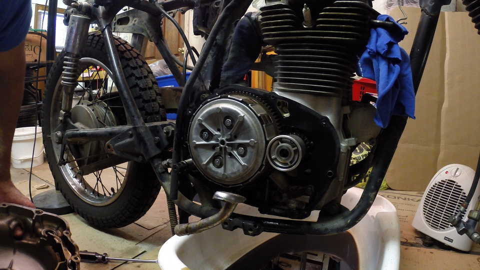

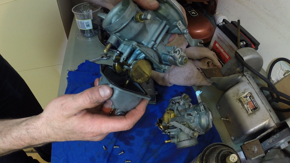

For my 3rd session, I drained the oil, dismantled the front controls and loosened my crankcase covers while the engine was bolted to the frame. I got a little ahead of myself and did not research enough about the oil filter on these bikes. I went looking for a disposable oil filter and only realized there was one built into the engine, staring me in the face after I had done some research and looked at the manual. Good lesson to be learned there.. RTFM... every time. Chalk that one up to an eager rookie mistake.
I ran into a few stripped bolts on the left side of the crankcase, so I could not get to the sprocket to remove it. I've already figured that I am going to drill into them with an 8mm drill bit. That way I can get to the sprocket and remove it so I can move on with the rear wheel. I do not have a chain breaking tool, so it's my only option for now.
No more major surprises with this wrench sesh, was cool poking through the front controls figuring out how they work. I also enjoyed peeking behind some of the crankcase covers at the clutch, stator and what I know now to be the oil filter. I'm looking forward to getting the rear wheel off so I can move on with the teardown.
I removed the old gas from the float bowls in the carbs and saw that they were in pretty great shape when I looked inside. I cleaned them up and sprayed a little WD40 in the bowls, put them back together and sealed them in a ziplock bag for storage.

I like what you're doing. You got a good spirit about it, mate.
1. Use PB Blast as a penetrant if you're buying an aerosol. Nothing else! For the really tough stuff like pistons and heavy studs, ATF or ATF thinned with acetone will work. Stuck valves is a different story. It involves making a spark plug into a grease nipple and pumping so much grease into it that it creeps through the valve guides. At least you don't have to take the top off to do it, though.
2. Why do you need a chain breaker? This has a chain with a small clip you remove to split it. The only tool you need is pliers.
3. Don't drill into the case! Just buy an Easy-out bolt extractor. It is a sort of drill bit with reversed threads, so when you are turning anti-clockwise, the threads are digging into the bolt to extract it. Read what size you will need to drill and how deep and for which size extractor. Google.
4. The sad thing is that you've gone too far, but the good news is it's not to hard to put everything back for one important first step; MAKE SURE IT TURNS AND RUNS. I know it sounds like a lot of work, but I can usually take something that's been sitting for a decade and make it run within a day or two, assuming parts are on hand. At least then you can better judge what you need and, more importantly, what you don't.
You took the side cover off. Clean the oil slinger spotless, you don't have to remove it to do so. Make sure the pump screen is clean and not broken or clogged. Clean it. Now put the cover back bone dry with maybe a hair-thin layer of gasket maker, just to avoid a mess and constantly topping it up with oil.
Put oil on, attach a SAFE external test tank for petrol, put the carbs back on without those filters, they're cardboard by now. It's ok to start just for now without a filter, just make sure nothing can get sucked in. Dust is actually gritty and can cause damage inside.
Crack the head bolts one-half turn from the outside inward in a cross pattern, then torque them to spec from the inside ones to the outside ones, working in a cross pattern.
Set your cam-chain tension of you have a manual one. The manual one will have a bolt on the top of the housing.
Set valve clearances.
Set the ignition timing as best ya can after you check that you have spark.
With new plugs, oil, and petrol, give it a go.
Check compression. These will idle with as low as 145psi but you want more than 155, 160 is recommended minimum. The cylinder pressure shouldn't be more than about 5-10psi difference between the two.
Also, GET A MANUAL!!! It is your bible. Check online for anything you're not certain about. Any terms, techniques, or inconsistencies can be cross checked. Don't make a move without consulting SOMETHING.

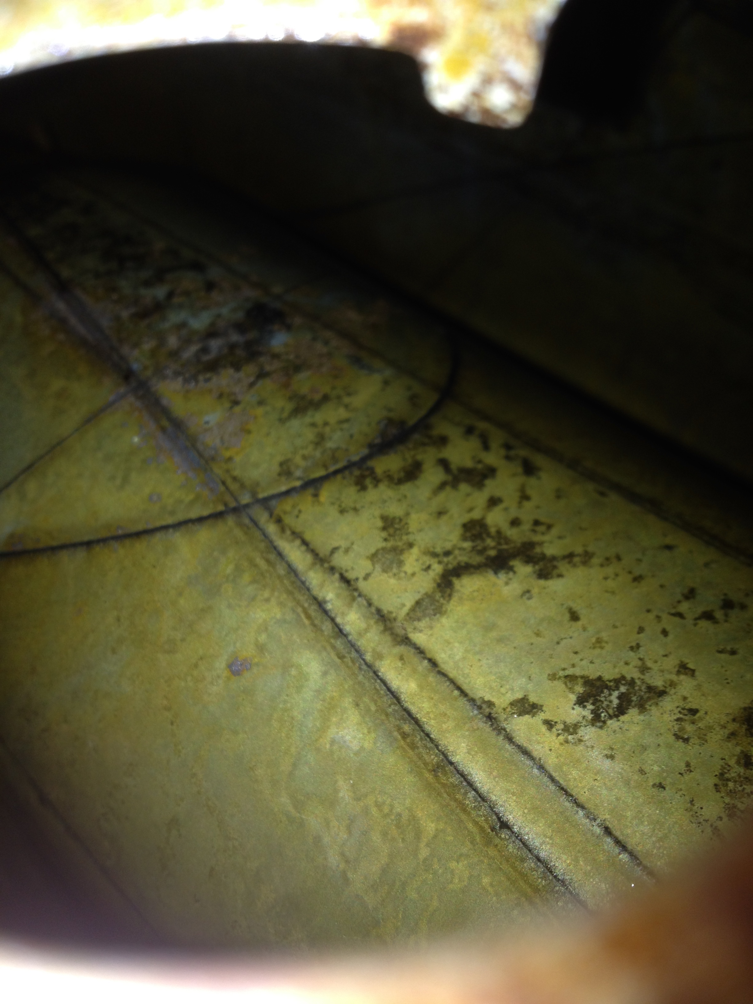

The line under the fuel tank is the crossover. It ensures you can use the petrol at the bottom of the tank opposite the petcock side. Some Triumph riders are familiar with tipping their bike to get that last drop of fuel over to the reserve-tap side.
As for disconnecting, there are quick-disconnect solutions that won't spill a drop. Google.
For the rust, do as you're doing now to remove the large rust. Wash it a few times and then fill it to the top with Metal Rescue or Evapo-rust. Glorious stuff. Once you wash it out, if you don't immediately coat it, use some 2-stroke oil mixed with petrol to slosh around and coat the inside, or it will immediately rust. Pics attached of my SL100 in progress. The line is where the Evapo-rust was filled to. I only had a gallon on hand, but when I go over it again it will be evenly cleaned and coated.

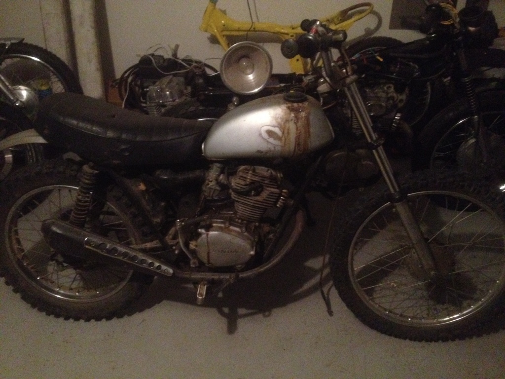

Here's an SL that say for 15 years and was running the next day! Smoked a little at first but I guess the rings freed up with some ATF. Cleaned and sold 4 days later. Never needed to split the motor! Don't ask about the tank, it's somebody else's hero's journey now. ;D
