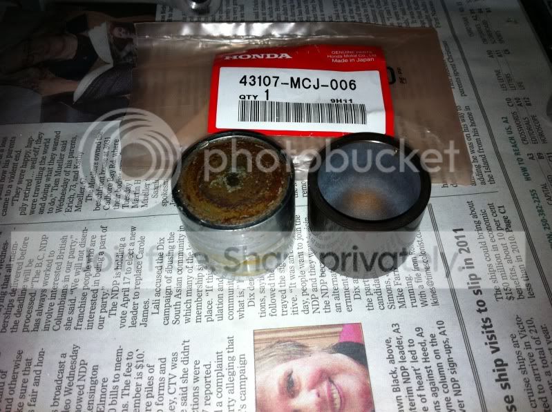

Yes the CB350G model was the only CB350 with a disc brake, but wait! It's the exact same brake caliper as a CB360 and most of the other 70's Hondas like CB450's and CB550's (except NOT the CB750). Should be easy to find if you look for those other models... some on ebay... I found mine at the wreckers... Seal kits are cheap and the rear piston from a Honda CBR600rr will work and is pretty cheap if you need to replace it.
Great Info Overdraft. Yeah I've got a 550 and 360, and they both have the same setup. And I didn't know that a CBR600rr piston would work. Do you know what years? (just for future people to see this if they need that)
Here's the part number. It's the correct bore but slightly shorter... unless you're someone who likes to run your pads right down to the metal this shouldn't matter...
and they're hollow and WAY lighter than the stock ones, as well as being coated with the latest carbonized beryllium unobtanium...
2003-06 cbr 600rr; 04 05 1000rr; 2000-03 954 and 929. Should run you about $25
