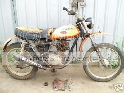

Bought this 1973 Honda xl100 a couple of years ago and its time to build it.

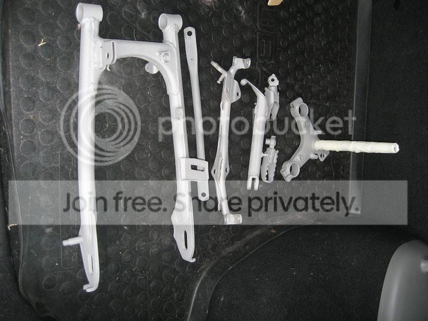

frame sandblasted and off to the powdercoater.
