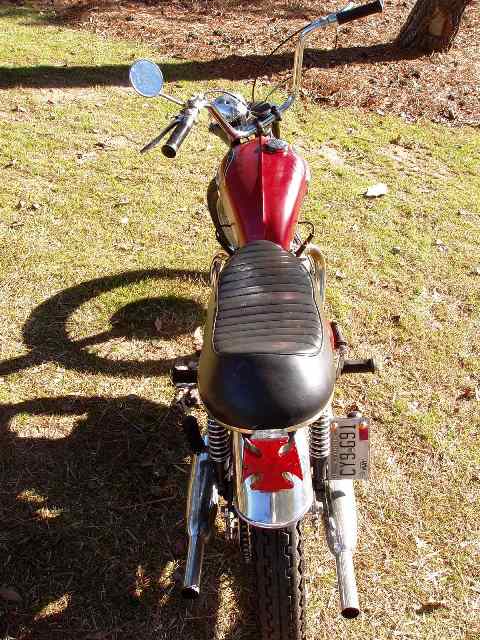

Very cool build project man! It makes me miss my old rat trump. I built it completely from parts including the motor. I'll be following too.

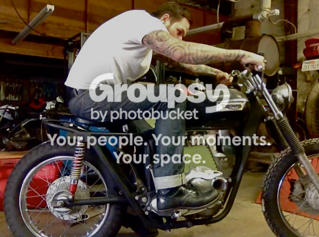

We got the frame rolling, and then I was able to fiddle with the seat placement. I'm sort of tall, so I pulled it back pretty far. My last bike had a typical cafe racer style seat, with that scoop thing, and I found myself constantly pushing myself back on the seat to be comfortable, so we made brackets for this seat to sit pretty far back. It actually ended up a good 2 inches further back than in this pic.

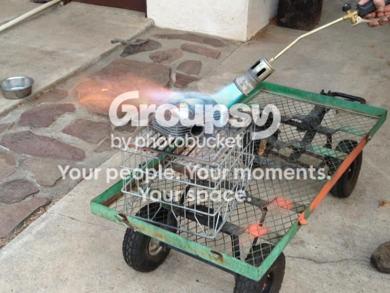

I was sent home with the top half of the engine, to clean. I learned the hard way, with the bottom half, what "clean" really meant. So I spent a very long time on these parts, and was advised to wash off all the solvents with warm soapy water afterward.
Before I cleaned the cylinders, we honed them because there was a slight lip where the pistons hit top dead center. This resulted in a .020 over bore.
