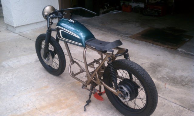

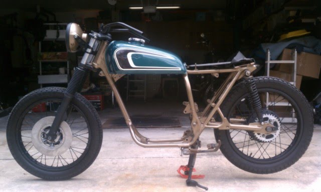

This thing came in a wreck. A half engine covers missing, spider infested barn bike to a pretty clean cikle. I've gone through 3 tanks, 3 rebuilds and it's finally aproaching something whole. Anyways here is the thread for the remainder of the build. Enjoi. Right now I am in the process of engine painting a carb rebuilding.. oh boy. Next will be an interesting and exciting leather seat upholstery done by a local san diego leather smith in Ocean Beach. At one point this bike was going to be a jockey shifter and maybe someday it will be. Please comment as much as you want!

Are those beach bars 7/8"? I dig them a lot, but more importantly, I want a set for a future project. Please do inform me a little more on those bars, great little project so gar.
Man I LOVE that frame color, I want to do something like that someday with a chop or a bob. The handle bars are pretty damn cool too, ride like a fat tire bike. ;)
i like beach bars but to make them work i have a feeling a low seat pan would be required... never know
i have this vision of like, a guy delivering milk in those super old skool white jump suits, and the vintage styling of those old side car delivery bikes... lol almost nerdy because you'd be sittin up with those beach bars coming back like that. it seems to be a bicycle inspired thing.
