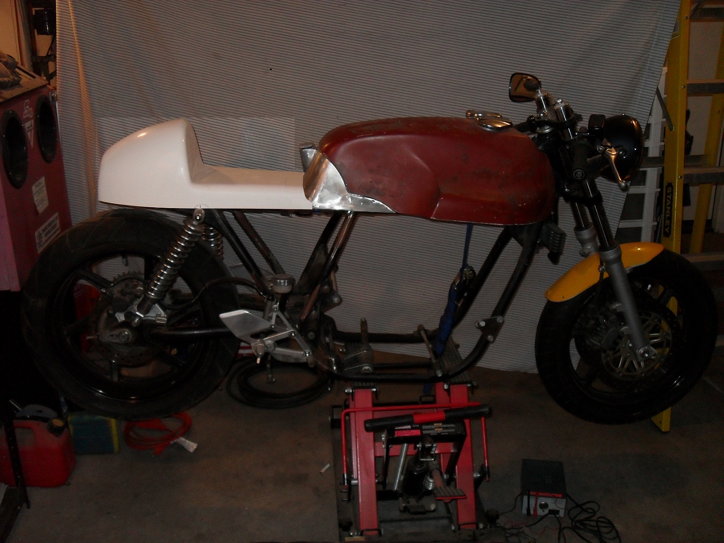

As posted earlier, the tank was a copy (by Dicks Cycle West of the 70's) of a JapAuto "Street" version of thier "Race" tank. The Street version having the pocket in the end to accept the Original Equipment Seat. I like my use for an oil tank better.
That bike has some sick parts on it
Since I am on the home stretch with my other build I should be able to get back to this one. I picked up a seat from Roc City, the "Interceptor" model.

Unfortunately I have to abandon this project.
The Fuel and Oil Tank combo $350 obo Shipped 48 States
Not because it wasn't "Doable", already had the harder issues worked out / done.......Cause I have too many projects and not enough time and money.
