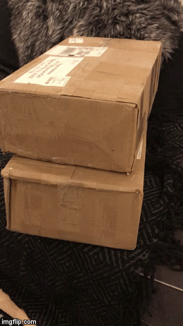

just found a big box of seals at my doorstep!
There goes the money :p
It always hurts me when you have to pay a lot of money for seals. But hey, at least you are sure your bike won't be dripping for the coming years.

More goods! It's go time!
Got something in the mail!
via Imgflip GIF Maker
