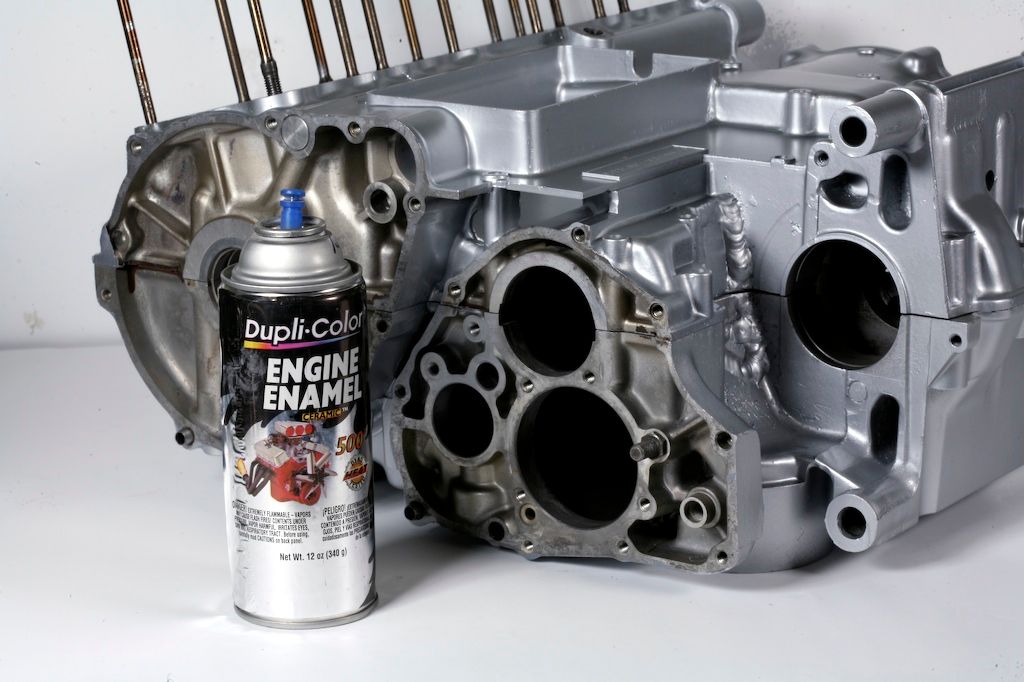

Thank you! Finished painting the crankcases and plan to bake them tonight. They look much better! The trick is to get them very clean and take the time to prep and tape everything well. Priming and painting is relatively quick. I have some travel this weekend and cannot work on my bike. No hurry, snow is here and spring is many months away... Stay tuned.
Cases heat cured, parts, gaskets, seals, tools, proper lubricants gathered, but NO time. I plan to start going clockwise on Tuesday.

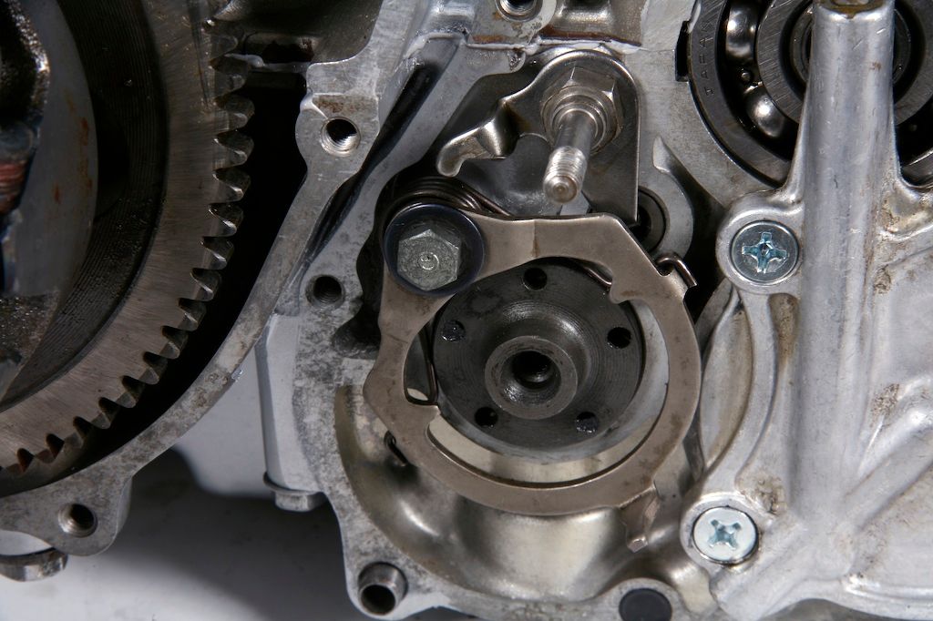

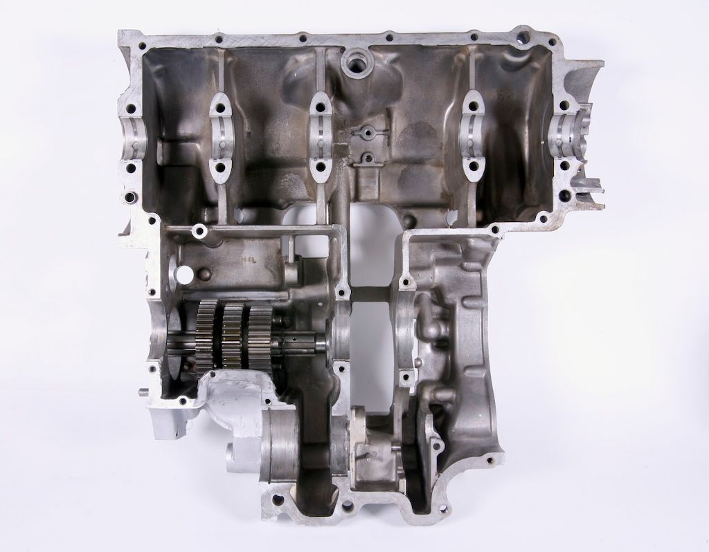

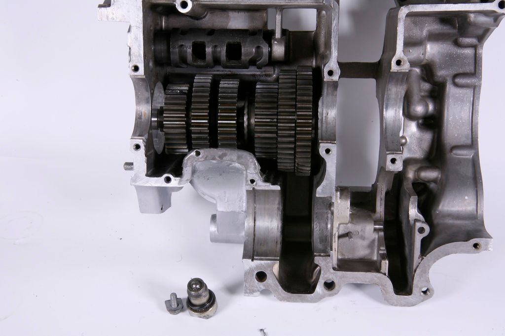

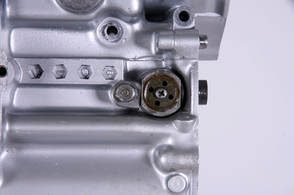

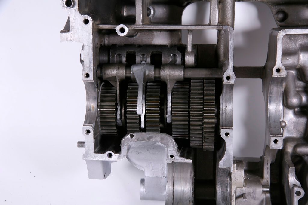

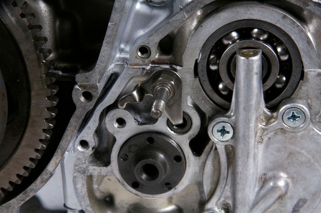

I ground the repair welds to fit the gears on the layshaft and checked to see if the drive sprocket would not hit the repair. After much grinding and test fitting, I got it right and meticulously cleaned the cases. Here we go with lots of images:
Blank canvas
Partial layshaft
Layshaft complete

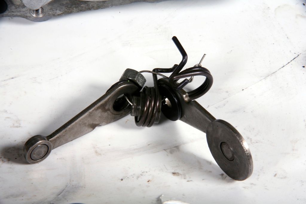

Gear selector spindle

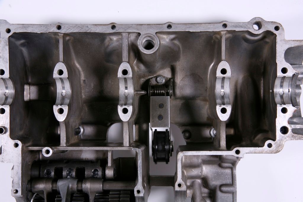

Cam chain guide
Kick start assembly

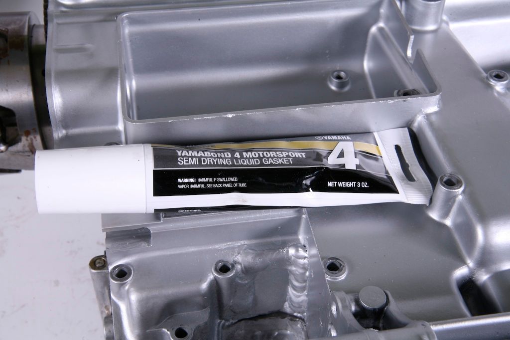

Lower end is buttoned up:
Bolts torqued to factory spec
Yamabond semi-drying gasket material between upper and lower crankcase halves

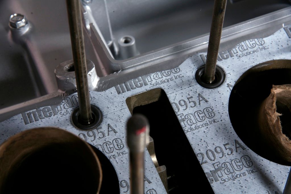

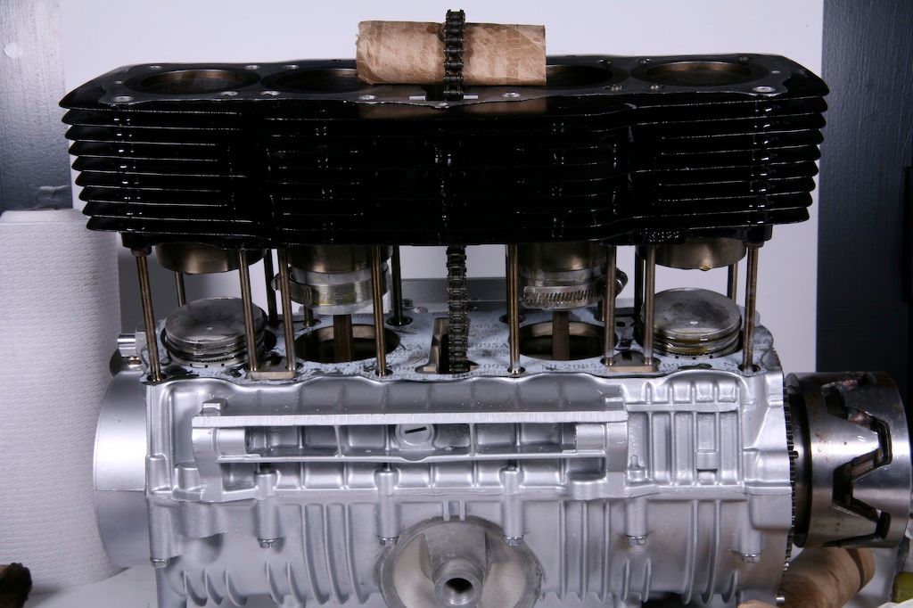

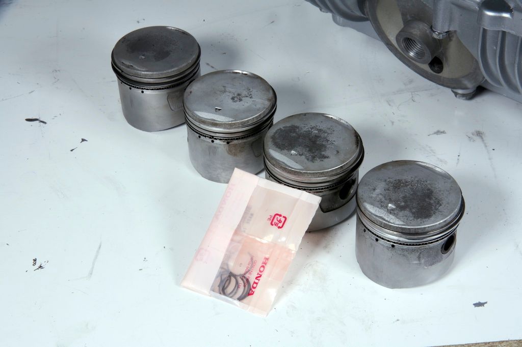

Thanks guys. Quick update with few words but lots of images for reference. The gear change mechanism is in and the tranny shifts smoothly through all the gears. Next the cylinders block went on last night and I finished, cleaning, prepping, painting and heat treating the clutch and chain covers. New circlips for the pistons and used my high tech specialty ring compressors (two hose clamps), plenty of oil and the block went on easily on the first try. Looking more like a motor. Ordered guides and valves today.
I kept them in order when removed.
All good
new gasket, o-rings and o-rings underneath the cylinders
New circlips for the piston gudgeons

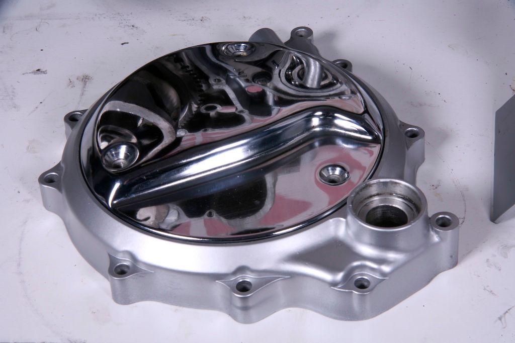

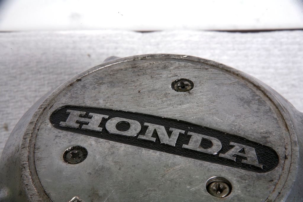

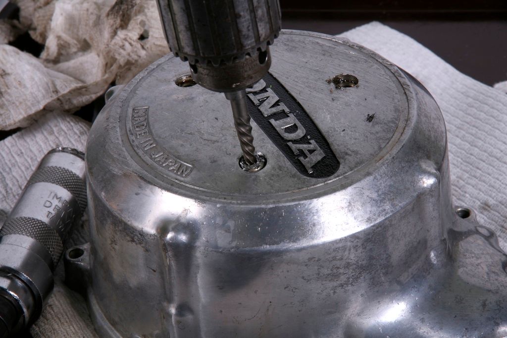

The stator rotor cover was a nightmare. The bike must have been down and the were scrapes and scratches up to 1/8" deep. None of the parts motors in our shop were any better so I washed it in my fancy new <a href="http://www.dotheton.com/forum/index.php?topic=45077.msg493647#msg493647">parts washer</a>
Then I hand filed, sanded with random orbit and bench top sanders, hand sanded from 150 to 1500 grit then buffed and polished on the grinder. I got rid of most, but not all, the scars. It is much better, but not mirror perfect, but I can live with it. I repainted the black parts with Testors black model paint and a small brush. I replaced the outer screws with allen bolts because I could not find panhead (cheese) crews with a small enough diameter to fit the cover.
That's it for now.

I have a stator cover that looks as bad as yours did. What did you fill the gouges with? Thanks.
