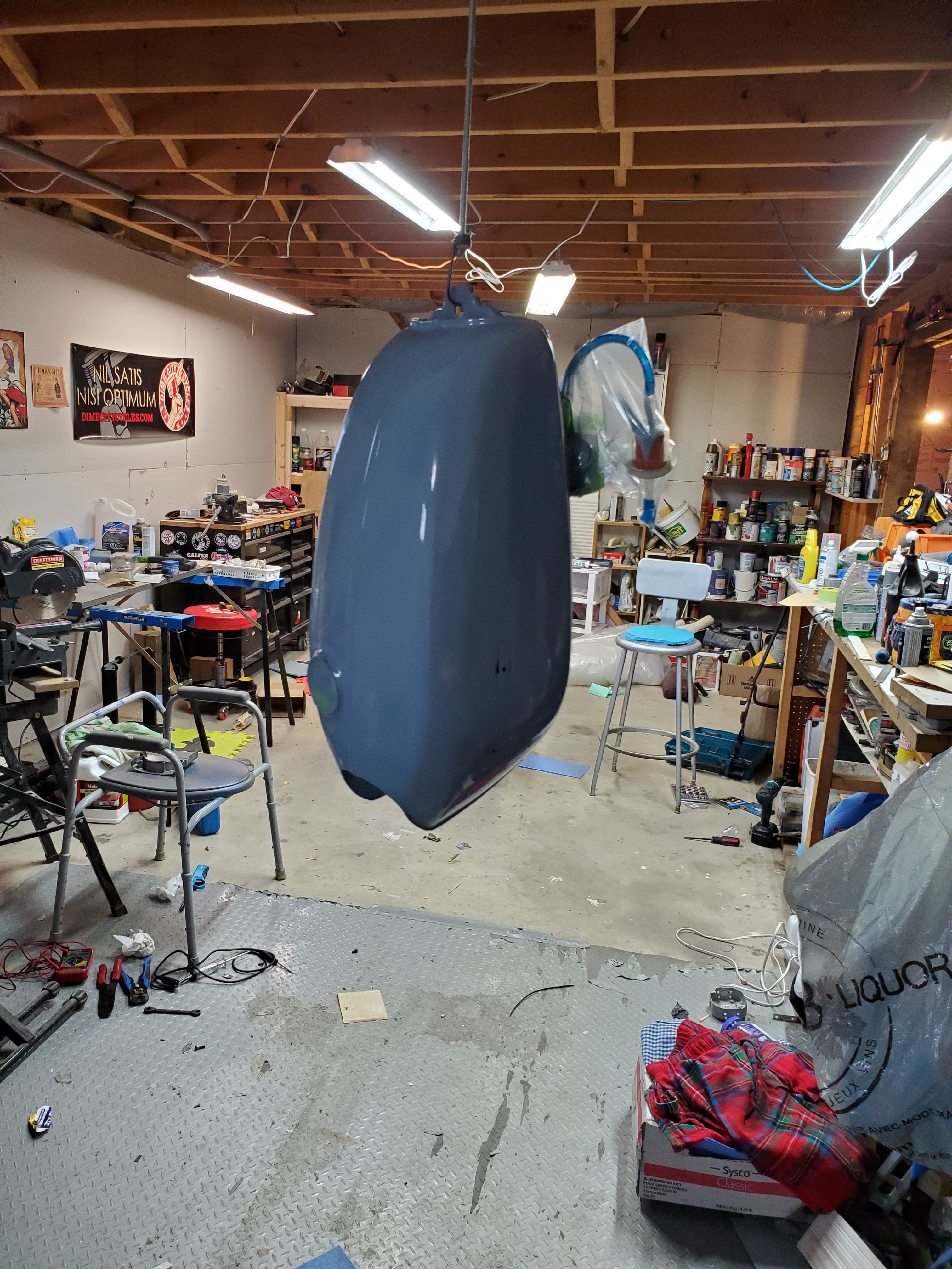

Thanks. Tanks last wetsand and paint. Hoping temps hit high enough to clear. Did a big dent repair on Pilot I'm going to use the 2k on after bike bits are done. They say 18-25C on spraymax can we're supposed to get to 16 C but hoping out of the wind and in the south sun where I setup to do it it will be good.
Checking on the parts and the tank looks perfect but the side covers have now got the filler circles showing up dammit. the clear made them pop out for some reason. I think I may redo them with regular clear as the gas proofing isn't as critical on them as the tank.
Bummer. It's a dark art is filler
Ain't that the truth?!?!?! I had a couple of spots on the Hedgehog that drove me batty(er). They looked perfect in primer and looked perfect w/ the silver color, but once the clear went on there were terribly noticeable places, couldn't miss 'em. Very frustrating.
Yep, I still have colour so I think if they bug me I will re-shoot and use standard matt clear and be done
