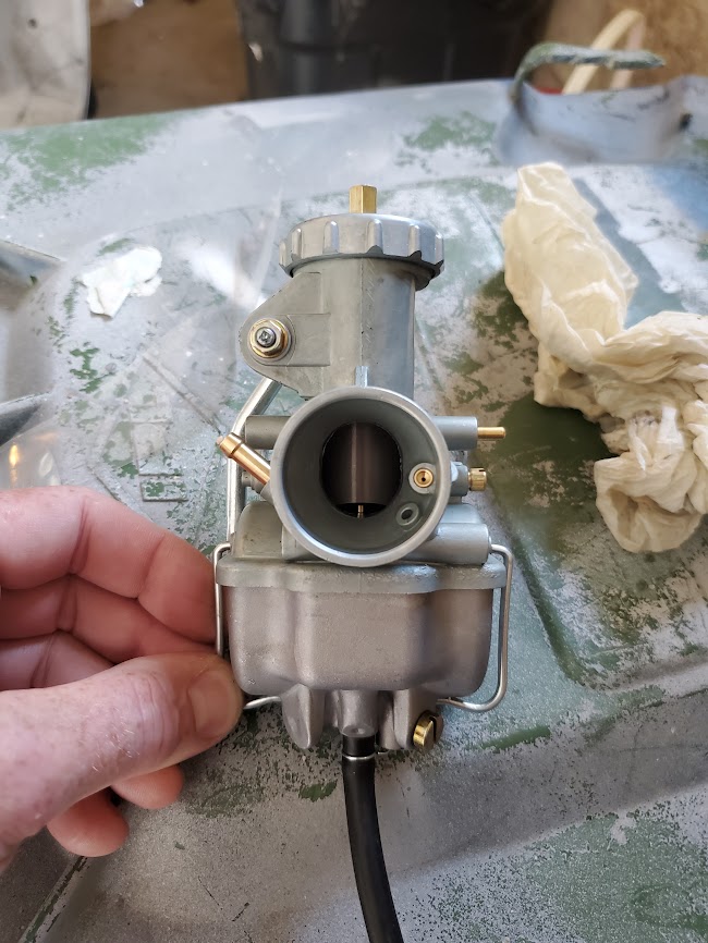

If you don't mind, please post a photo of the aftermarket carb. I'm curious.

Aftermarket Carb:
Yes, that looks just like one of my Winstar carbs. They came in black and yellow boxes labeled "OEMSTD."
