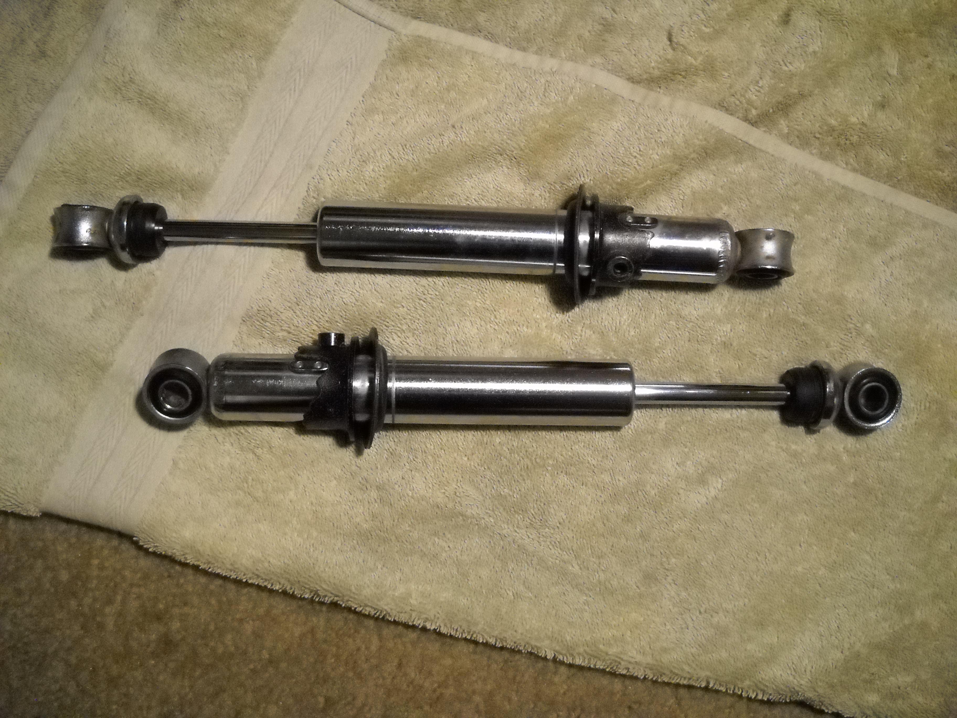

bump,I'll be doing this rear shock 're-hab'/oil change to a pr. of oem Suzuki TS185 rear shocks to install on my CB125,I hope I get the viscosity of the damper oil correct. :)
They're only a 1/4" longer eye-eye than my oem stock CB125S shocks but have much better 'feel' to the damping :)
