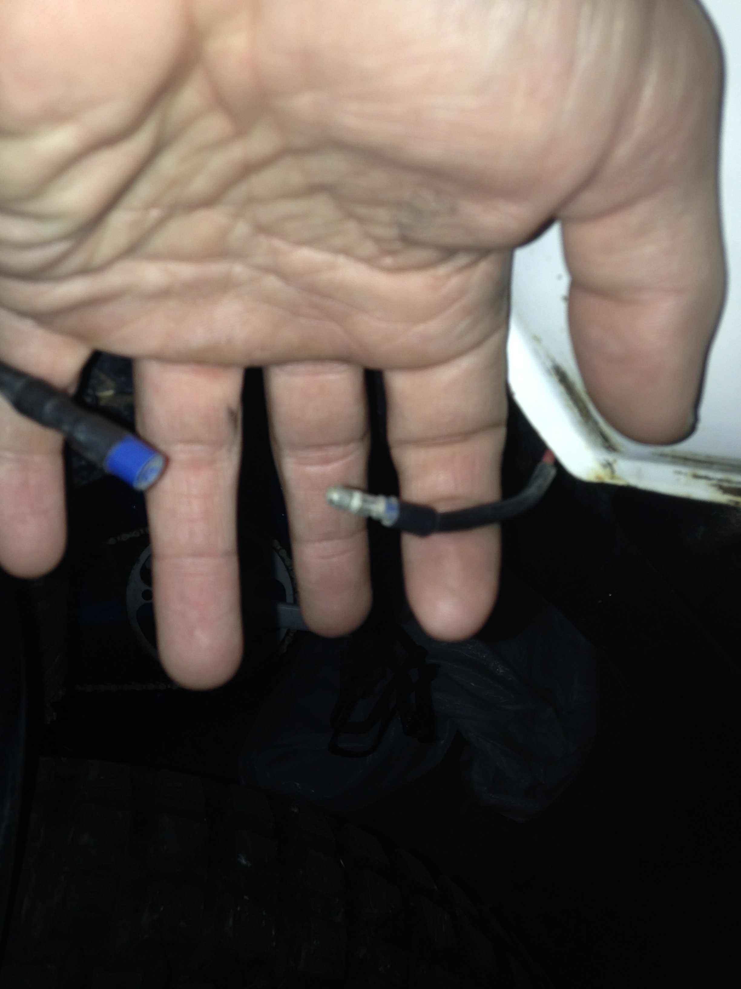

Right now I'm trying to figure out how to wire up the horn. I have an extra horn from a kz400, one of these switch assemblies http://www.dimecitycycles.com/chrome-retro-horn-headlight-and-starter-control-switch.html and one wire going to the front of the motorcycle providing power to the headlights. The black wire on the switch goes to the horn button, so I'm guessing that I connect that to the negative connector of the horn and the red wire from the positive connector needs to somehow be linked to the wire that powers the headlights, but what about the ground? In this diagram it shows a ground coming from the switch but this switch totally does not have that option. I guess I'm asking where the hell does the ground come into this equation?

P.S. the red wire (you can see the color towards the tank) is the one that goes toward the rear. I'm pretty sure it connects right into the capacitor. I'll check that when I get home from work.

The case on that switch is the ground so it relies on the fact that the whole frame of the bike should be a common ground. As long as it has good electrical contact to the bars you should be fine. To check that set your multimeter to continuity mode and put one lead of your multimeter on the negative battery terminal and the other on the bars.
To wire up the horn cnnect the red wire to +12v and the black wire to one of leads for the contact buttons on your switch. The switch will complete the circuit by momentarily providing the ground loop.
Looks like those are aluminum dirt bike handlebars. The anodized coating on those bars may not be conductive. In that case you could run a gnd wire from the metal clamp on the switch housing to one of the bolts on the triple clamp.
Since the switch will be the gnd for your headlight as well you'll want good electrical contact.

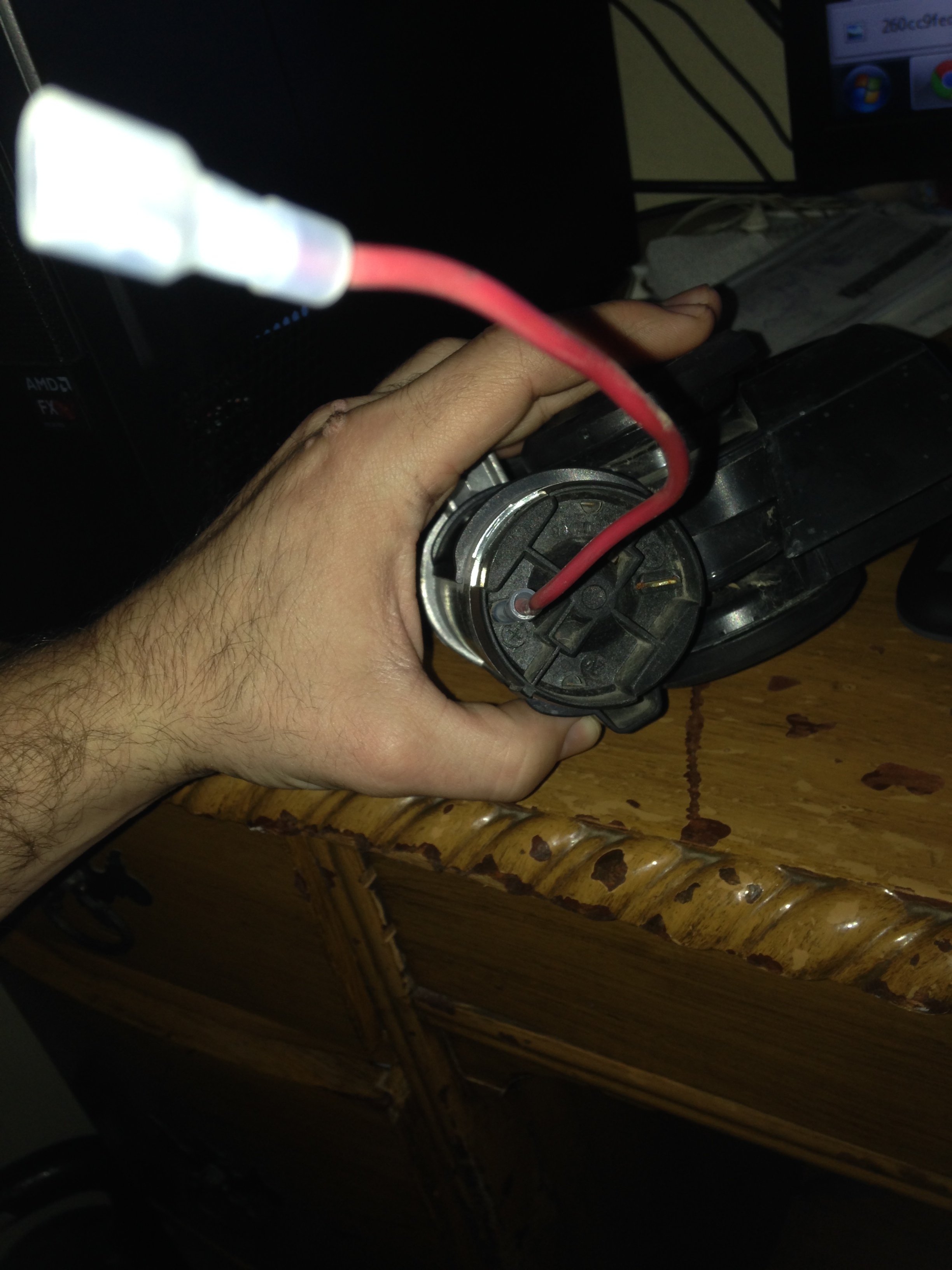

Got my LED light in, super easy to replace the h4 bulb with, especially with the adapter. However, the bucket I have is juuuuuust too small. So I'm either going to punch a hole in the back of this baby, or think about making my own since it'll be hiding behind a plate in the front eventually anyway. Still waiting on the horn to come in so I can get it inspected.
