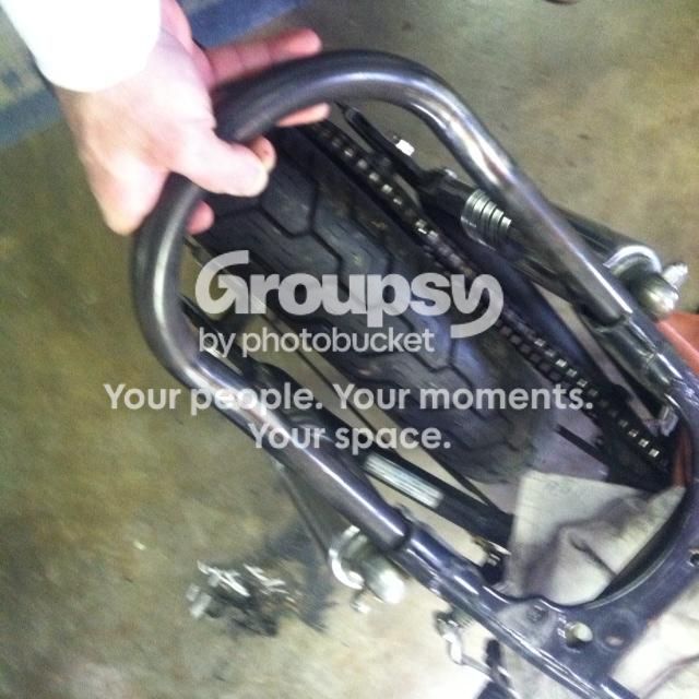

one thing I would recommend from research I have done, you mentioned in your first post that you were not going to use a front fender...a lot of the older bikes used the fender as a fork brace so I would suggest sourcing one out or make sure you get a solid fork brace to add in at some point in your build
I know you may not be at this point in your build just yet but just one thing that jumped out at me since I was unaware of this when i started my build.

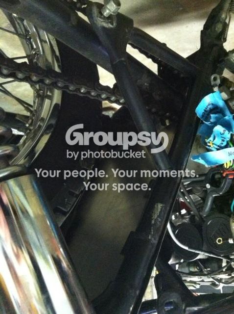

yorkie350 said:sweet way to keep crap from back end doing something on those lines myself remember ya gotta leave at least 3" cut out for chain side especialy when ya suspension is under full load or ya gonna go ??? oops![]()
