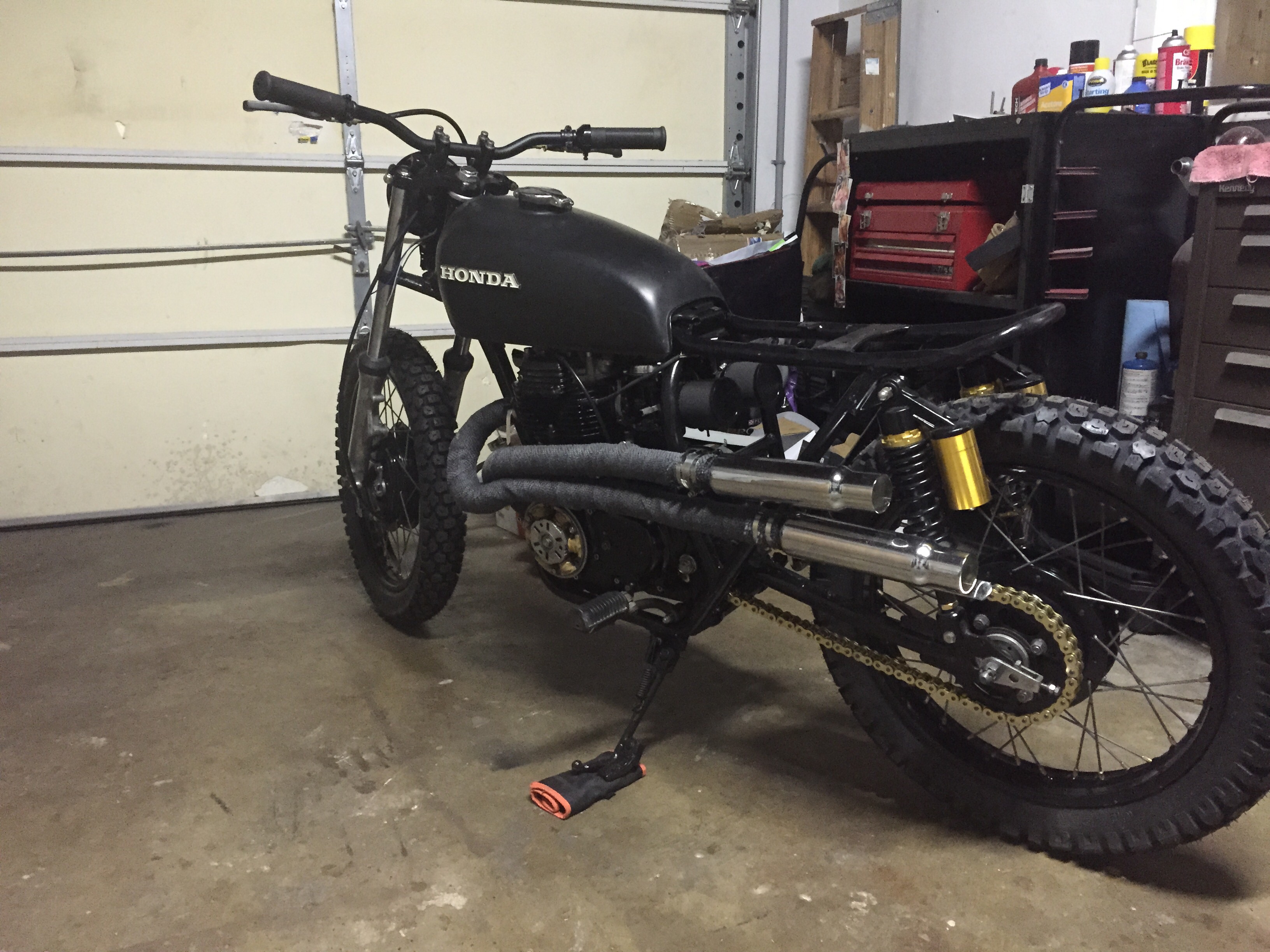

I decided to mount my own tires. ....after realizing the task at hand, I decided a beer was a necessary tool for this job. So I grabbed one. Beer one made it through the front tire. Then came the rear tire. Stronger. Thicker. Ugh. Grabbed some whiskey. Jameson. On the rocks. It was rough. But it was completed. Couple scratches. Couple times debating how much I wanted to just pay somebody to do it but it's done now and I learned from experience. I'll true them tomorrow.

I've pinched enough tubes that I just pay the local shop. Good you got them on without a hitch.
I think next time I'll pay somebody to do it. I was terrified of getting the tire on then realizing I had a hole in a tube or something. I aired them up last night and they are still at they and psi as last night so I'll call it a success!

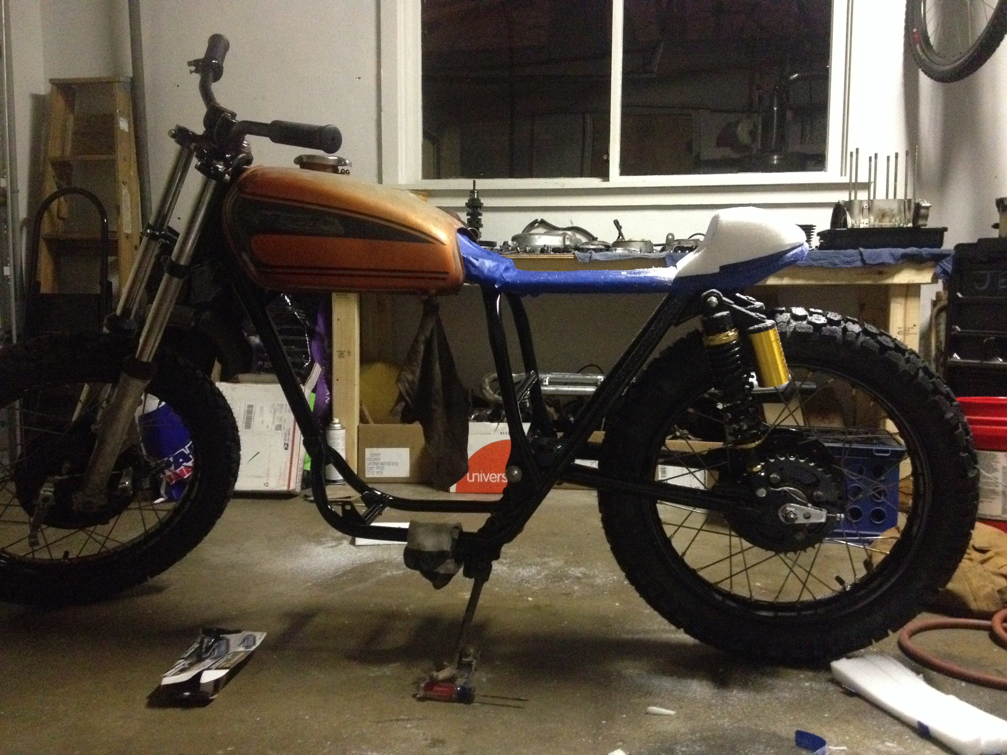

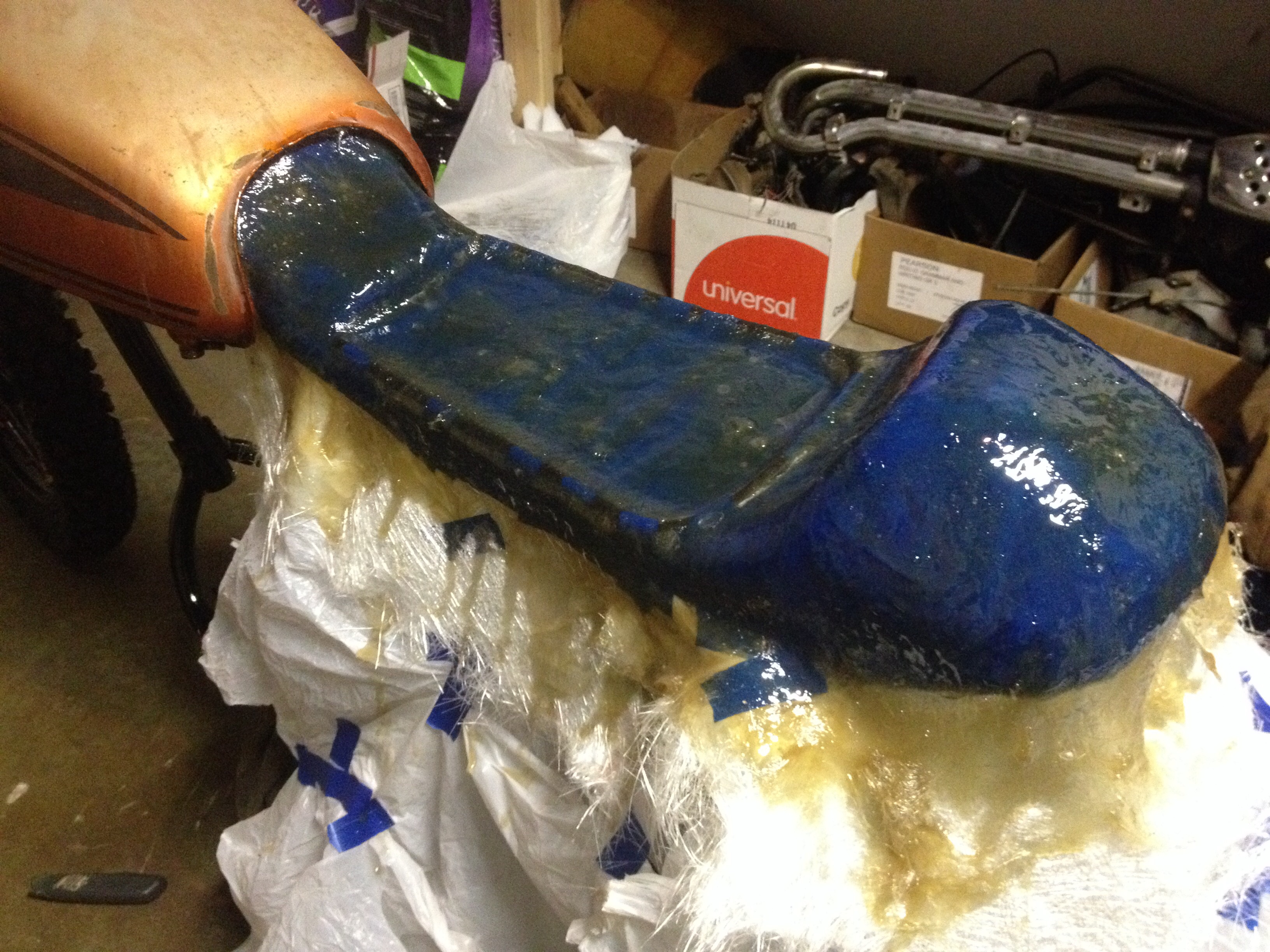

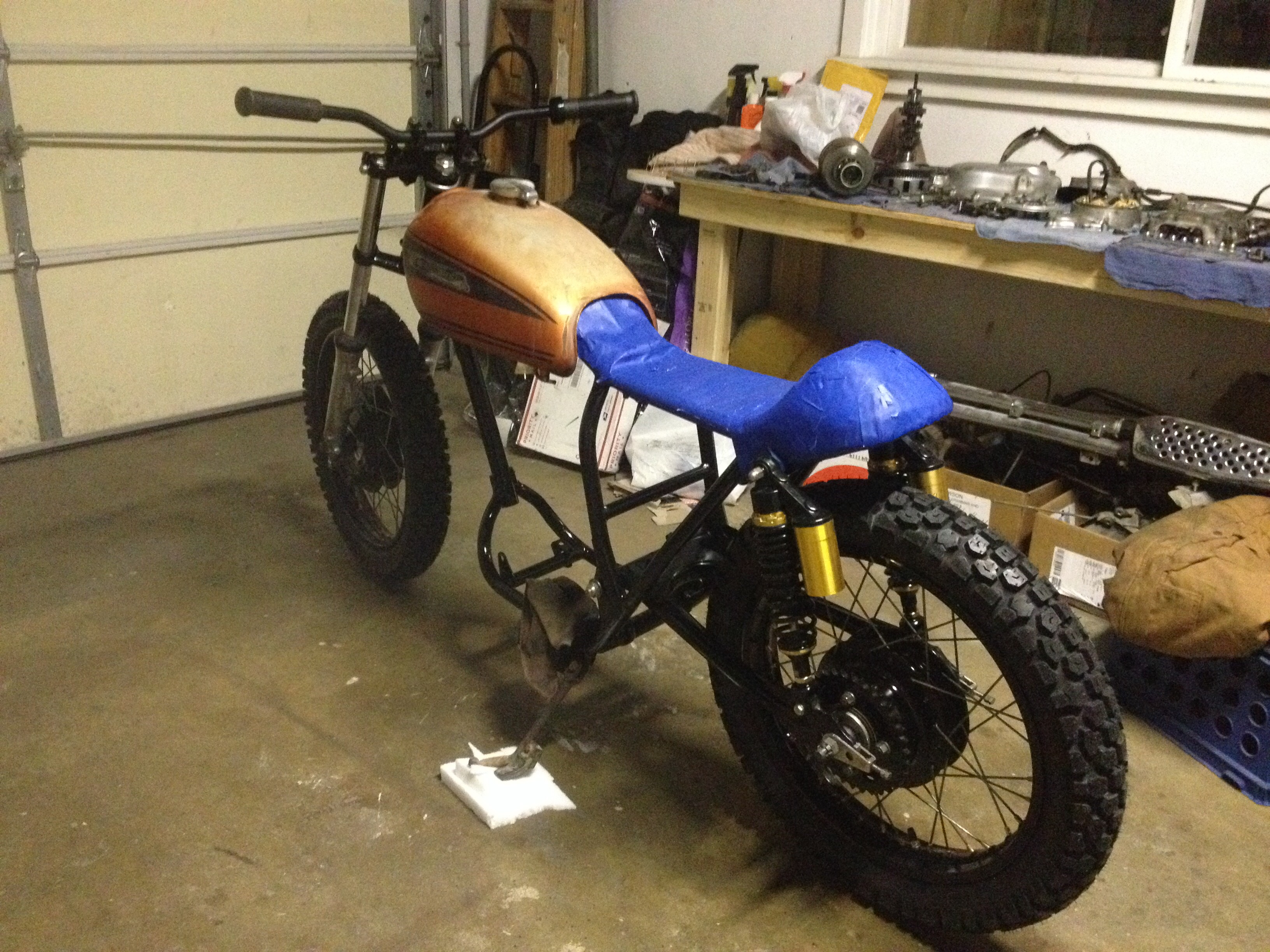

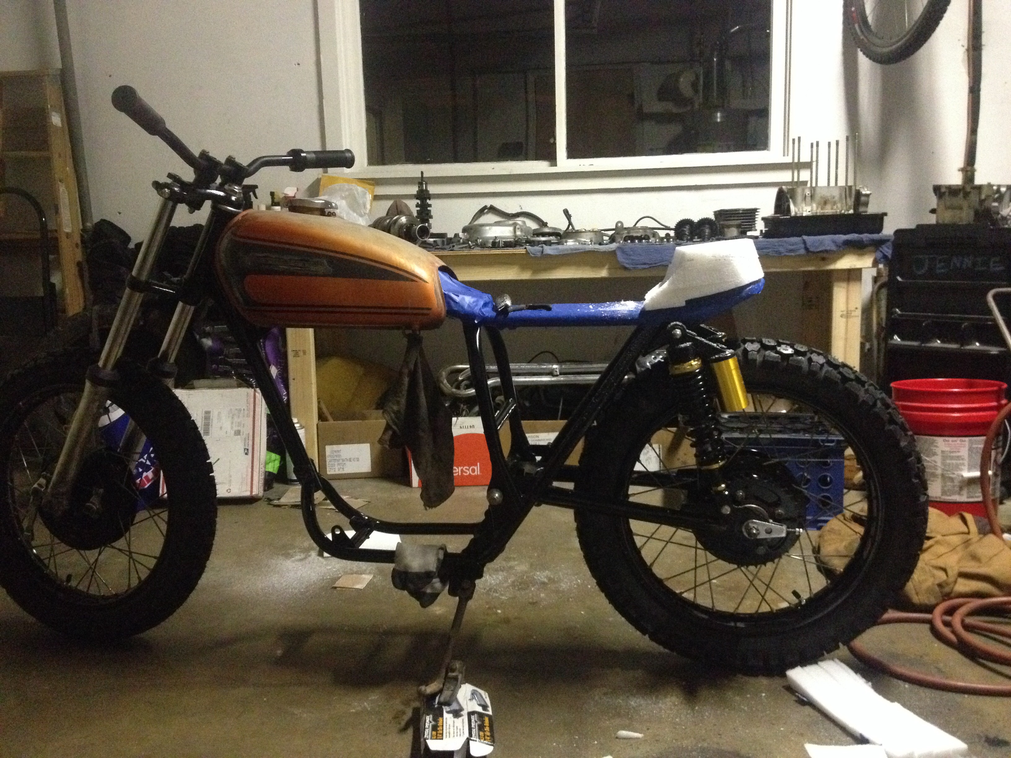

I was absolutely terrified of doing the seat since it seemed pretty difficult, but it worked out pretty damn well! I'm super satisfied with how it turned out! A few gin and tonics gave me the courage to go for it!
I used four 1 inch tall pieces of foam. I didn't have any adhesive so I pretty much just held the pieces together really tight and did it extremely carefully. The mess was massive.
It's in the garage and hopefully it hardens the way it's supposed to.

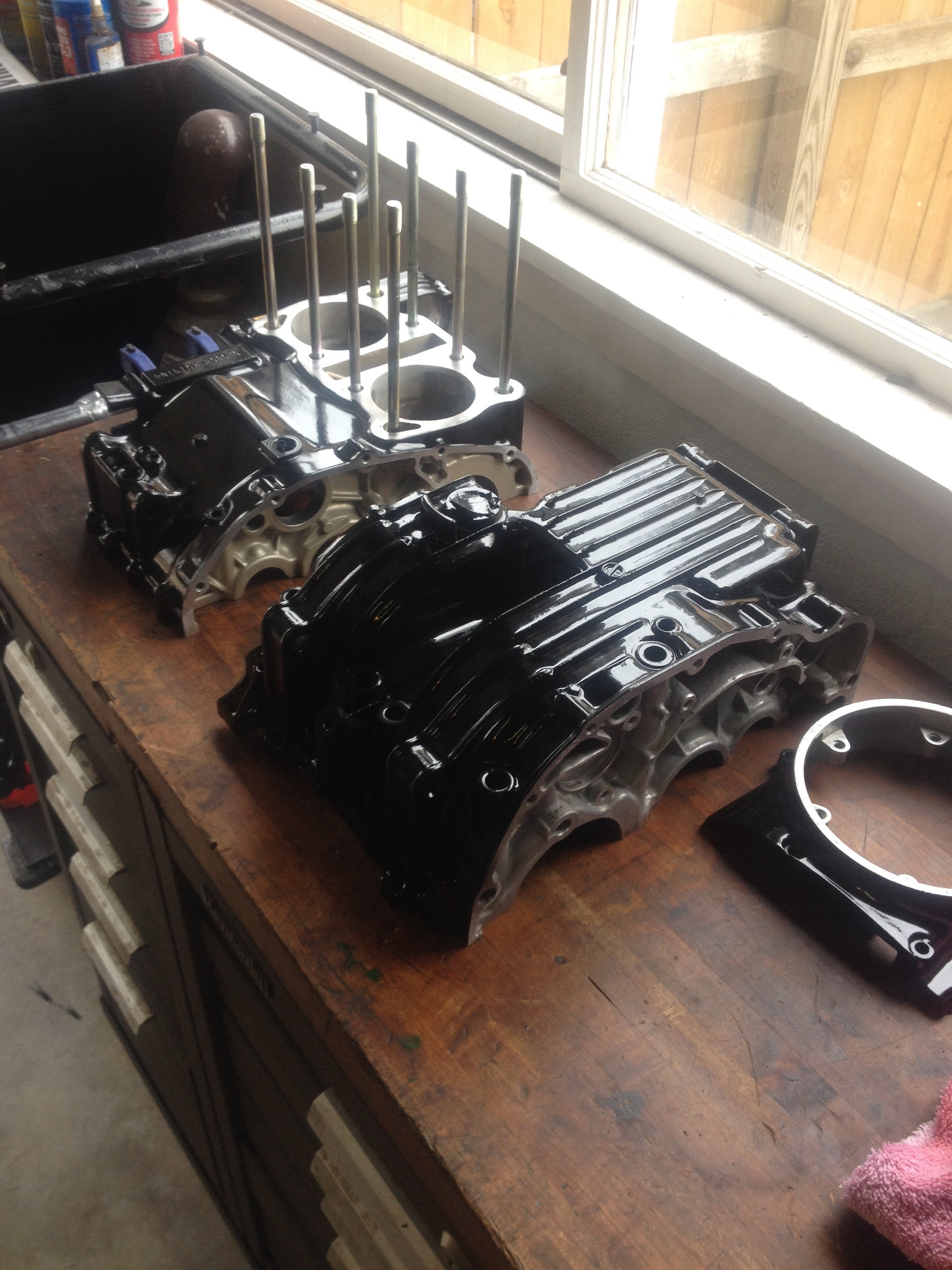

Cleaned the motor completely out, and painted it!
I'm getting ready to order some parts to pretty much get the whole motor built. At the moment I only really need gaskets. Anybody have any recommendations of what else I may need to build this? I need a new ignition set as well. Ebay seems to have all the good deals at the moment. Let me know if you think I need anything else! Also, when putting the gaskets on, do I need to add anything to them?

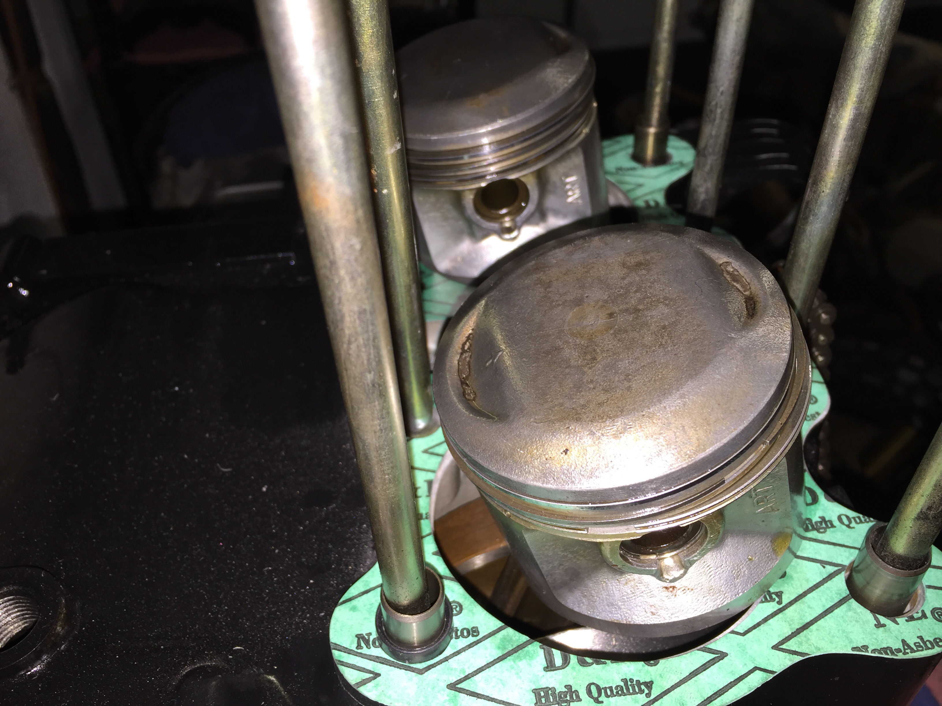

Just trouble checking before I put these jugs on. The arrow on the piston is pointing forward. Correct?

I was putting the jugs on and broke a piston ring....which sucked. But I found two Pistons and rings for an insanely good price. Those just arrived today so I can put them all on tomorrow! ....with a ring compressor this time.
