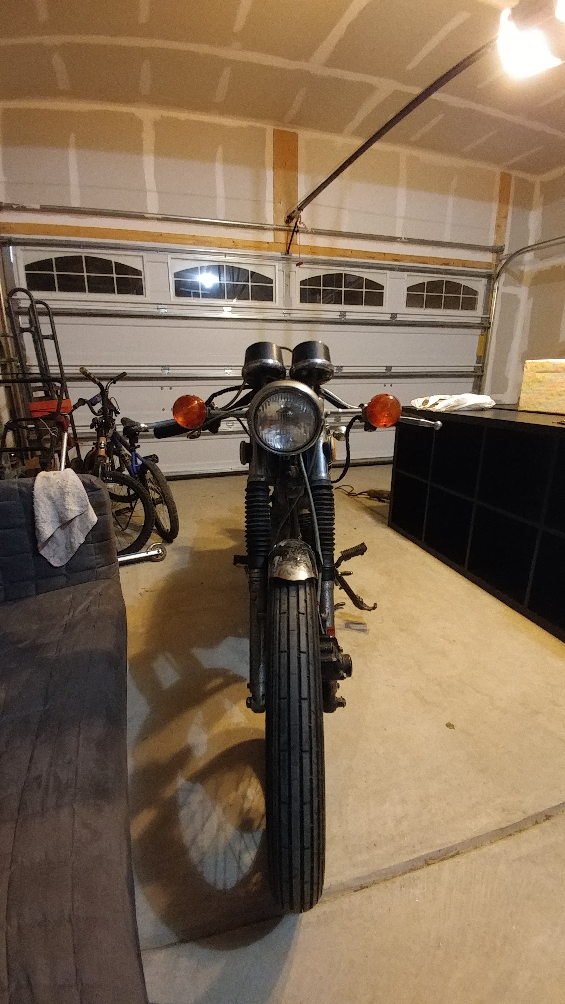

I've taken over ownership of my brother's old CB125. It's a '75 and when my brother got it back in the 90s, it was near mint. It's survived some stints off-road and at college while in his care.
Now that I have a garage and a little $, it's time to do what I've been wanting to ever since he got it. The plan is to build a cafe seat, clubman bars, convert all lights to LED and 12v. Replace the lollipop turn signals with something a little more modern, and maybe some rear sets.

Today I replaced the battery with a WPS 12v li-ion battery, a 12v regulator/rectifier and bodged an LED neutral light to verify the conversion worked. I also removed the battery tray, air box and toolbox.
