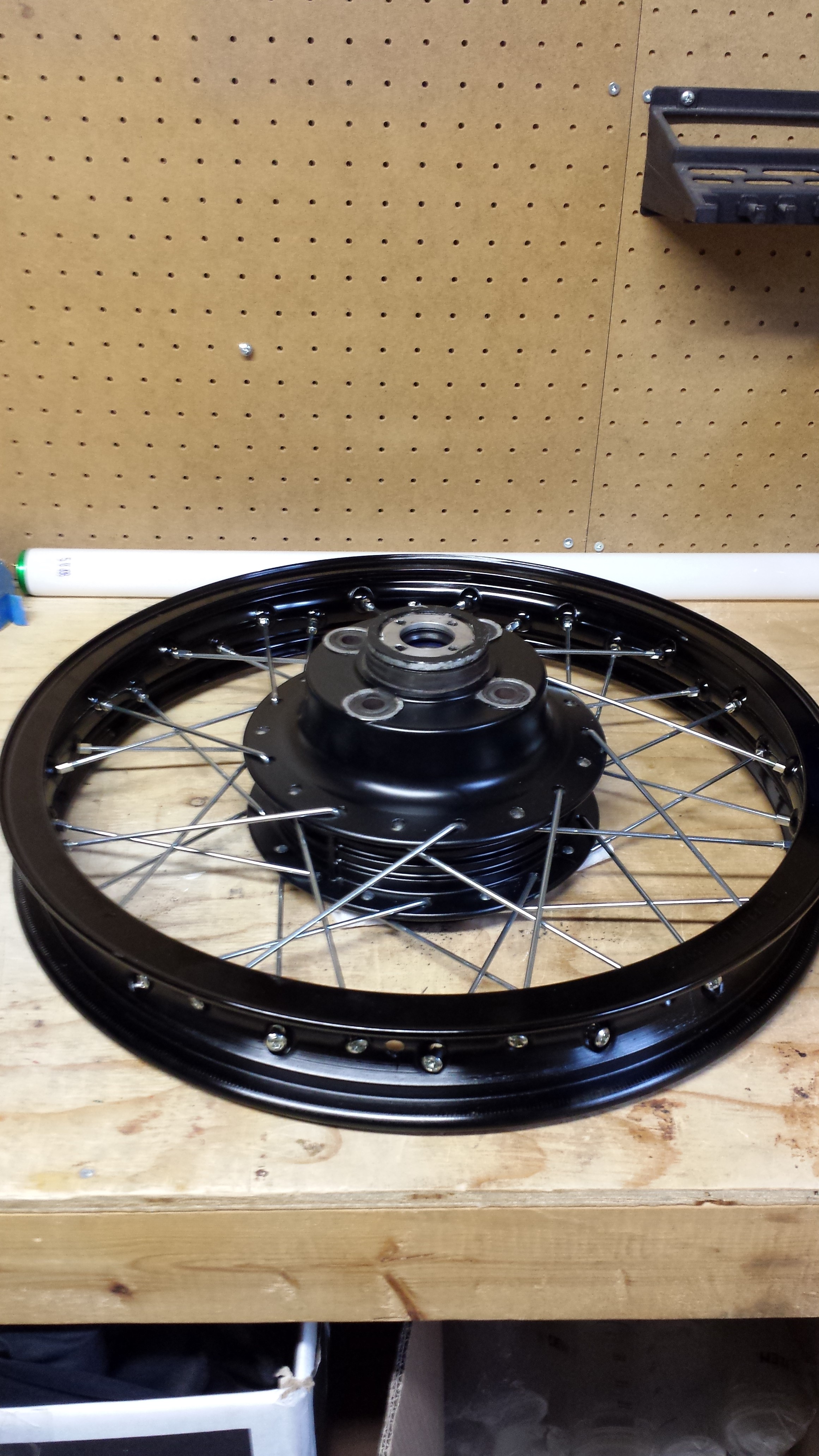

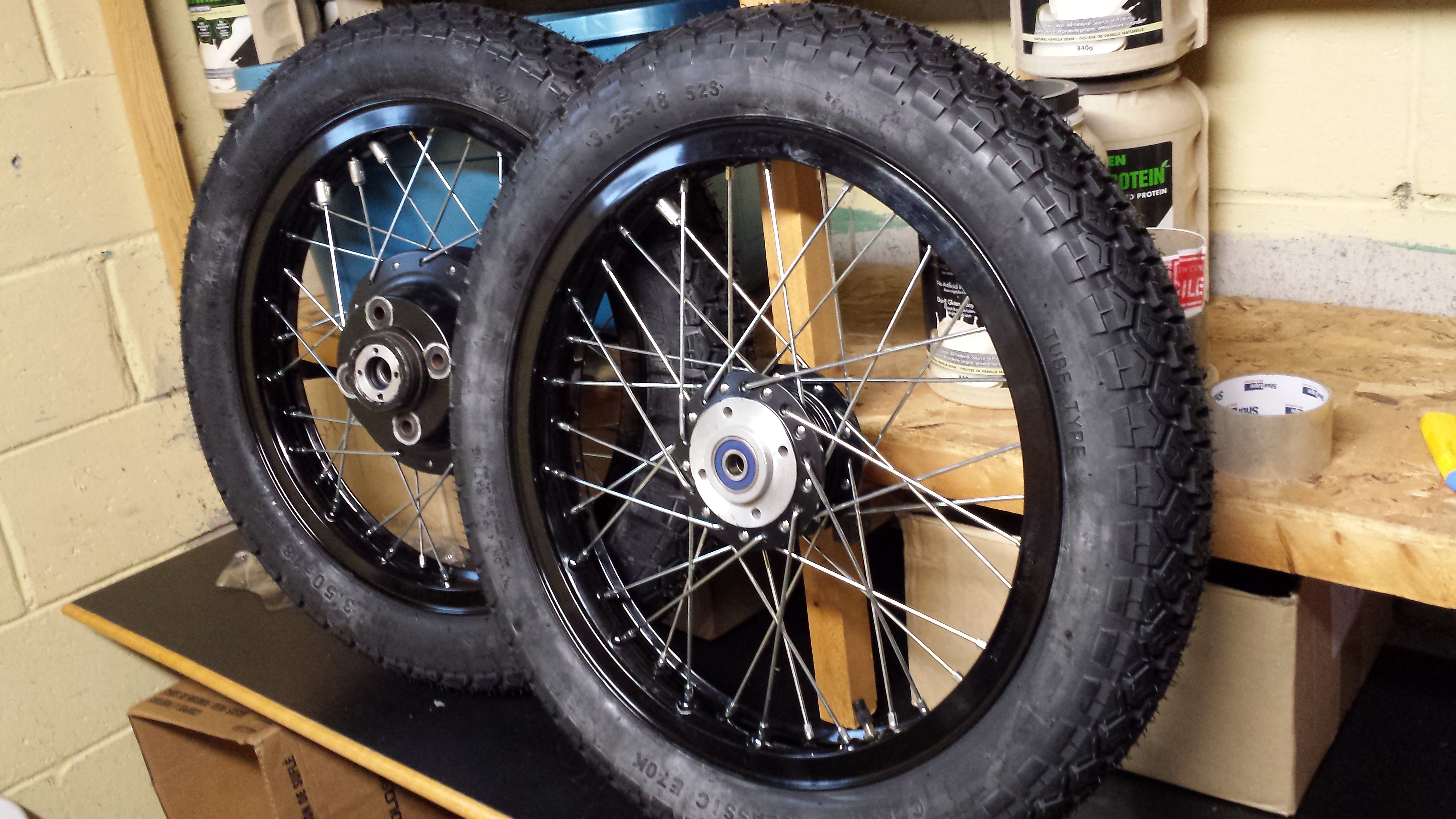

Hey Guys. A little update. Got the bearings pressed and fit. New rims showed up from mikes. Relaced front and back wheels. I sent them off to the shop to be trued and have my new tires mounted. Further pics to follow.
