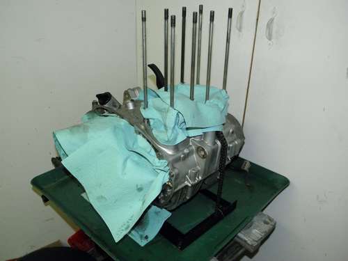

Cases in the basement thawing, top hat went on with some copper permatex, soak your tube of whatever gasket maker in hot water for 20 minutes and it lays out wicked neat lines, and engine complete ready to go into the frame. All my engine machine shop work was done at Auto Service and Supply on Vine in Hamilton, super great guys, good work at reasonable dollars.

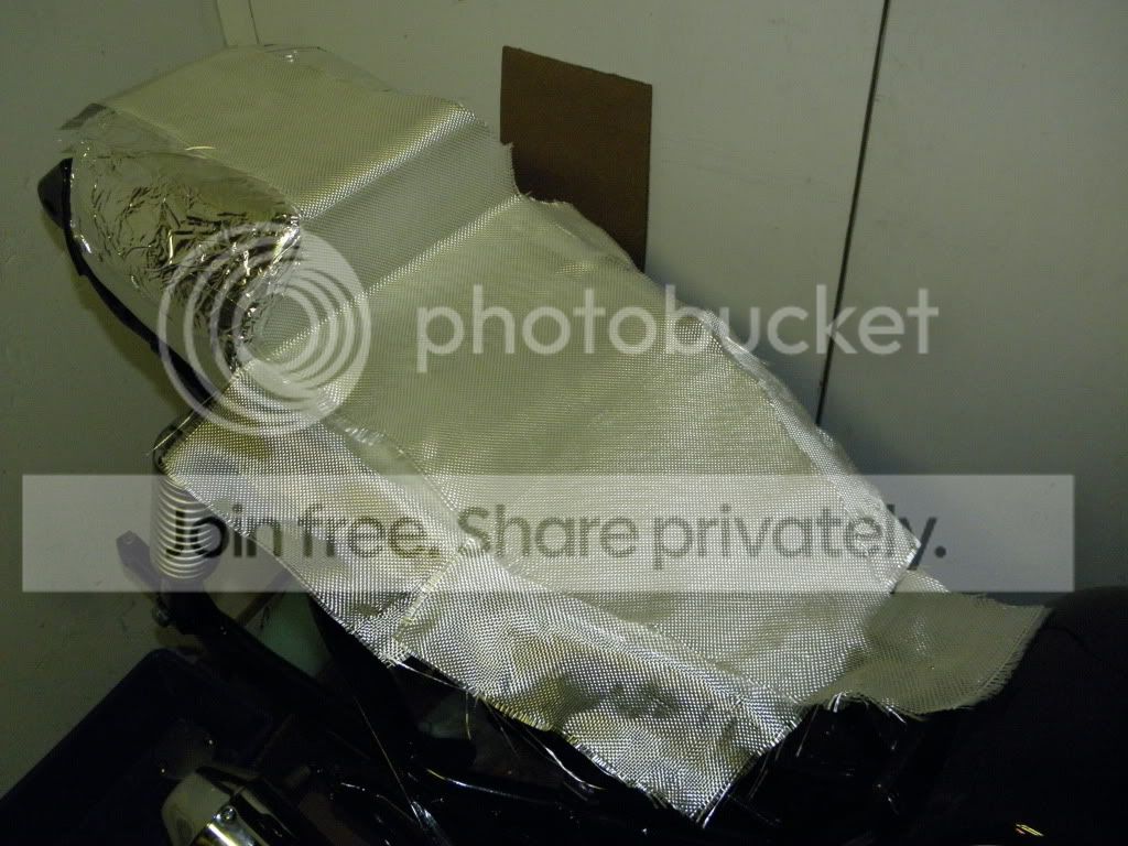

I had a go at the seat, thought that I would be able to salvage the stock pan, tack some simple curved sheet metal to it and have a seat, mocked it all up with paper and tape and wasn't happy with either of the two versions that I came up with..

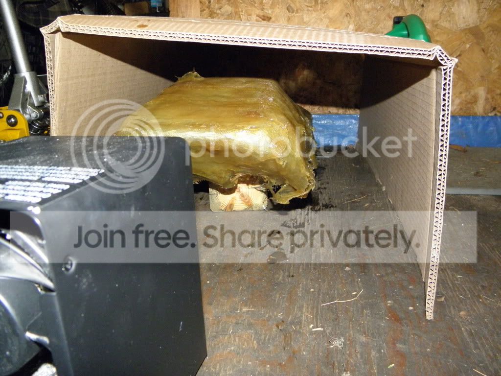

So I totally abandoned that and decided to have a go at the fiberglass route, i've never done it before but heres what i came up with
Precut all of my fabric and set up my custom fiberglass cooker in the garage
And finally a picture of what I have so far, first sand complete ( clamped the belt sander to the workmate upside down and knocked down the big lumps ), needs another 3/8 taken off the bottom and then i'm ready to tackle something that I am good at ... bondo! and framing out the bottom.
All in all i'm happy with what've got so far, not bad for a first try, I think.... Could be a little smoother but it is what it is i'm pretty good with the mastic so that should even everything else out.

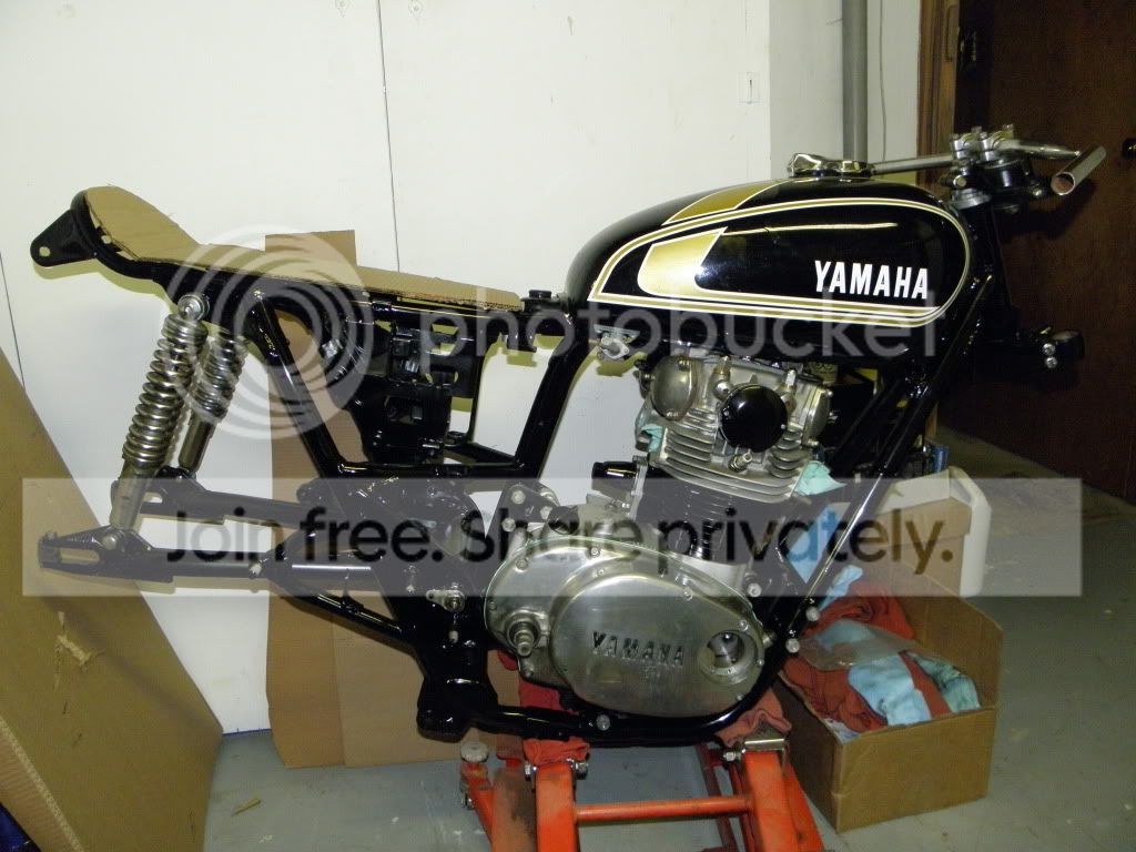

With all that done I bolted the wheels up and its a roller now. I'm at about the limit of what I can do in the basement as far as assembly. i need to keep the weight down and the protrusions minimal to make the trip up the stairs a little easier. Anything that I do from this point on is likely going to be fitted and removed. As for tomorrow I see sanding the seat and some electrical work....
Bike as it sits now
