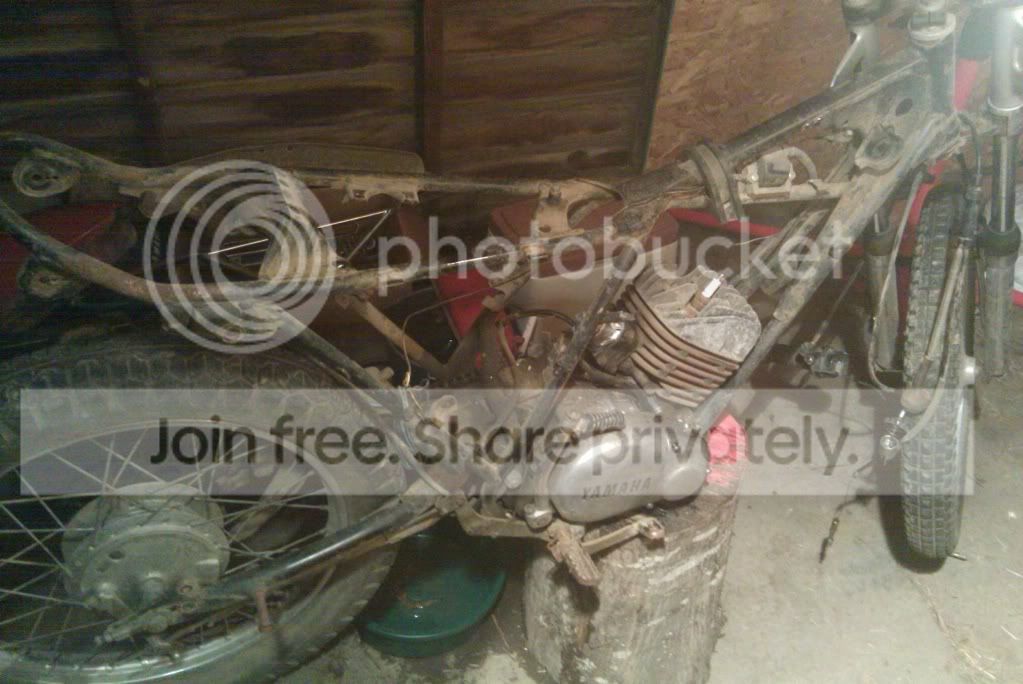

Here is my 1975 Yamaha DT 100 Cafe Racer project..... Picked the bike up for $100 bucks off of craigslist, today and started right in on it. It runs great, however found a little problem in the tranny you will see in these pictures, I will keep posting my progress and let me know what you think with it all and any suggestions you might have..... thanx a bunch

Wow... not sure what spooge that is on your oil injector pump. I've heard of dudes disconnecting it and just running premix.
You may want to check out www.yamahaenduro.com, if you haven't already. I used it lots when I was working in my 68 DT1 250. Loads of knowledgeable guys on that forum. The site seems to be down at the moment, but you will find tons of valuable info there!

Easy swap mate - you can change them out. You could also just dismount the injector and run premix at about 25:1 ('bout 5~6oz of oil per gallon of fuel). I would recommend a JASO-FC rated oil, but most anything will be fine for it as long as it says '2-stroke' on the bottle.
My Kawasaki G4TR (early KE100) is almost identical to the DT's in a lot of ways (frame especially) and the engine is easy to remove.
I would recommend getting a new piston, rings, gudgeon pin & bearing for the poor little thing, and if your budget extends to it... then get the bore replated to spec with something like Nickasil. Most modern engine reconditioners offer such a service, the little 100 should be about $200 to do and will save you in the long run.
Complete engines are getting hard to find in anything coming close to reasonable nick, so if yours runs and rides without problems I say keep it, and just do what I mentioned above - 30 year old piston rings have a habit of becoming fragile and breaking off into your case, jamming the transmission and potentially damaging the piston and bore.
Don't ask me how I know that fun little fact.

The oli pump goo looks like it may clean up. Try some rustol (harbor freight carries it) as it looks complete and worth the effort. Get yourself a manual, factory type preferred, as it will pay for itself.

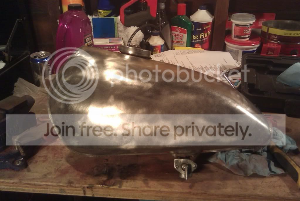

Got everything grinded down and working on trying to get the gas tank to the right shape as it has a few dents.... anyone have any pointers on getting dents out of those tanks....ALSO
had a big question.... Looking at possibly making my own custom oil tank.... has anyone done this before..... and if so... how did u go about doing it.... does it need to be any sort of special design? Does it need to be any special type of metal or thickness? And does it need to be coated inside or anything......
If anyone knows that would be awesome.....
