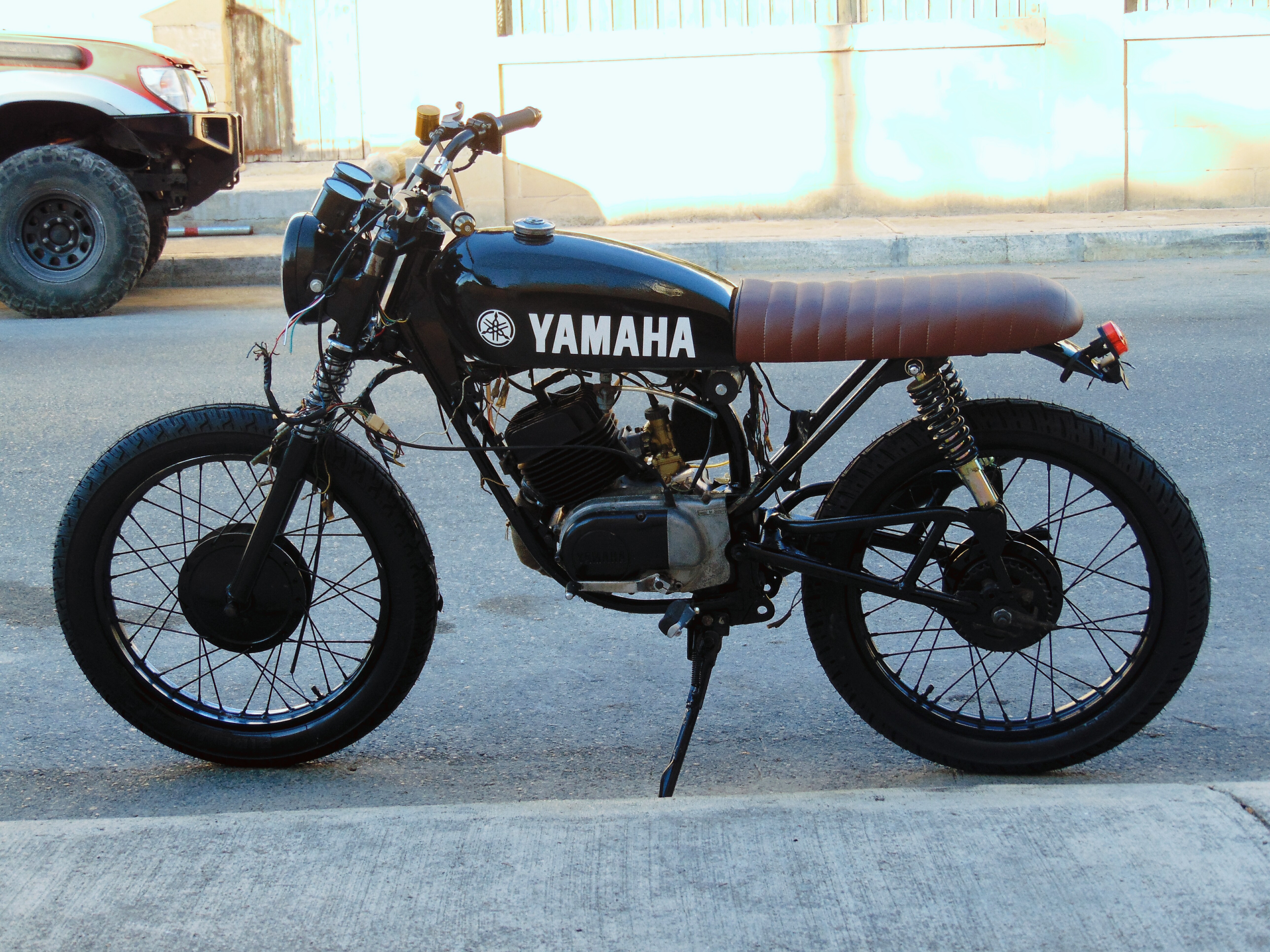

20295d1466003167-1975-yamaha-rs125-rebuild-ascendance-received_10154206768678428-1-.jpeg
All that left is Tyres, clean up the rims and Wiring and she is done.

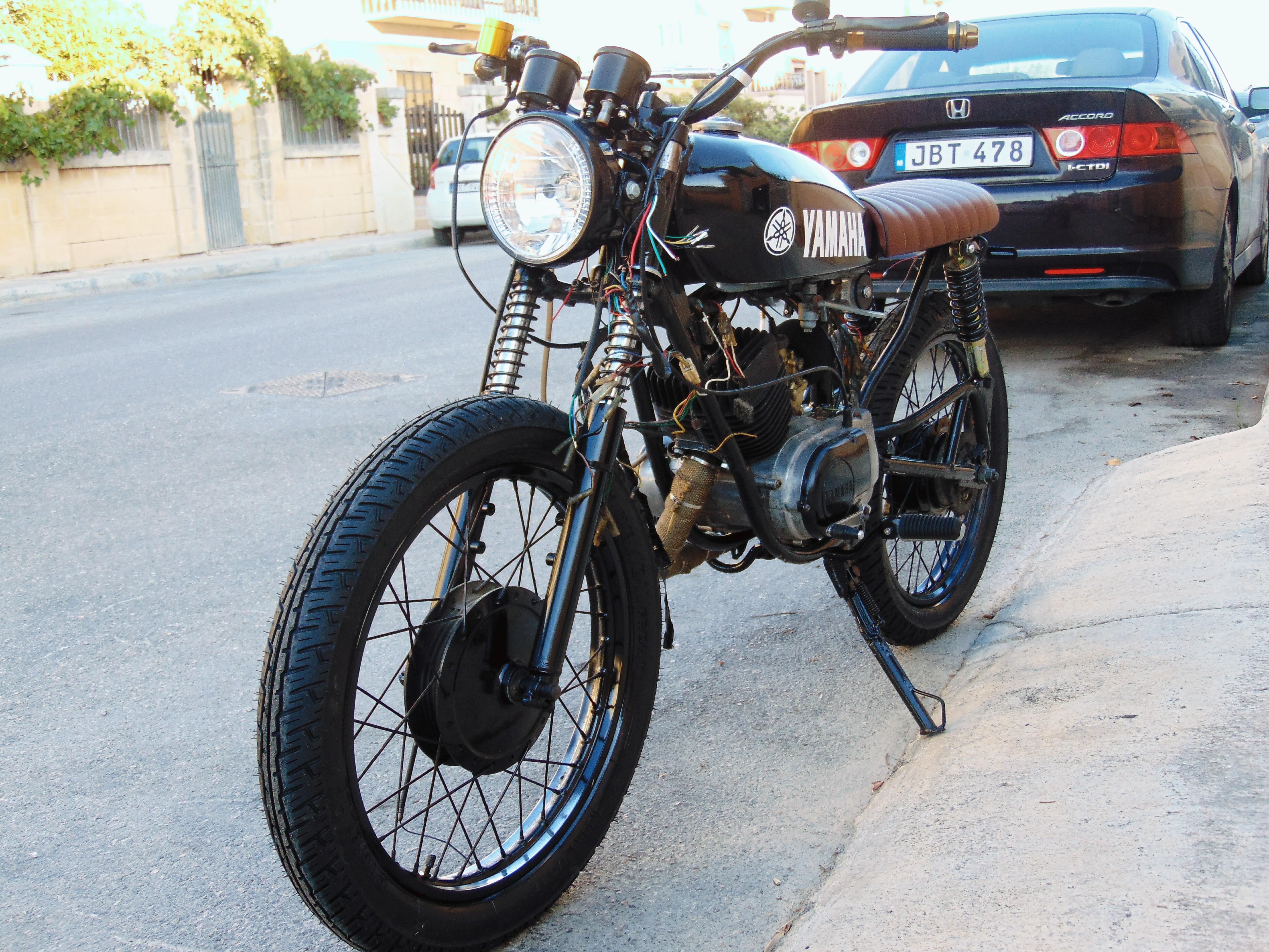

20299d1466003331-1975-yamaha-rs125-rebuild-ascendance-received_10154206768323428-1-.jpeg
20300d1466003505-1975-yamaha-rs125-rebuild-ascendance-received_10154206768713428-1-.jpeg

Good effort Alain, nice little runner you got there, nice fat tyres would set it off a treat.....it'd be nice to see it out on the road....with a better camera perhaps? ;D
Hi yeah the camera is shit I took the photos with my phone quickly. Il Crack out DSLR and take a good photo-shoot. Thanks for the feed back. On tyres what would be a good size front and rear for something like this . I know the rear one was a 17 3.50 how big can I go and what style ? . Also cause I couldn't find any knowledge on this what battery does it take the previous owner butchered the wiring loom aswell and Im literaly going on trial and error I managed to find an wiring diagram but thats about it not much info on these magneto models. Cheers ;D
