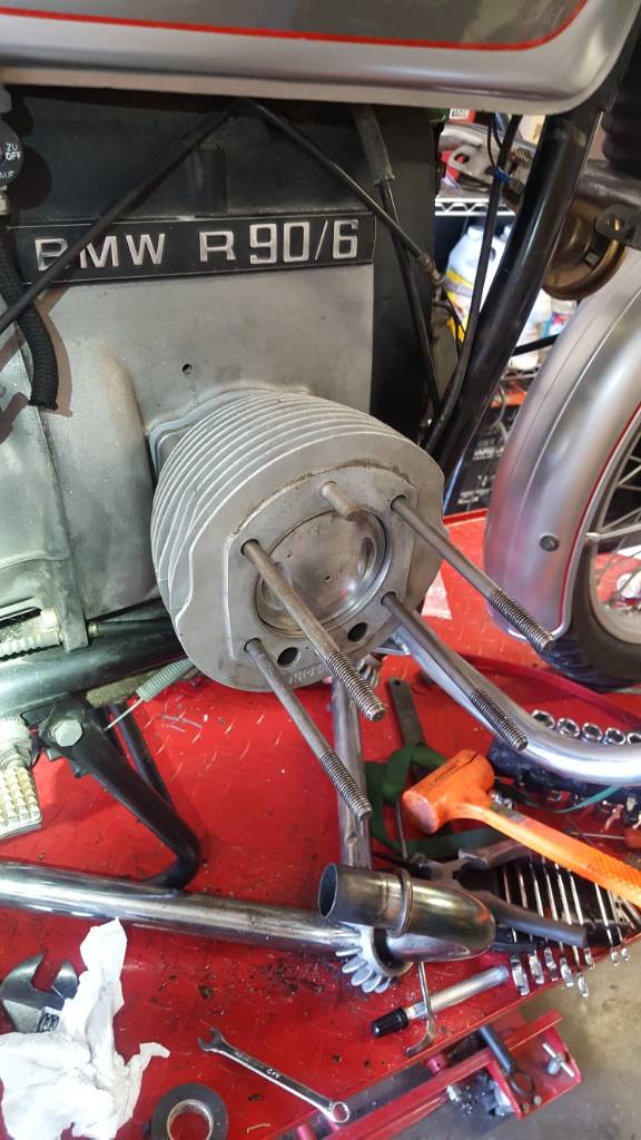

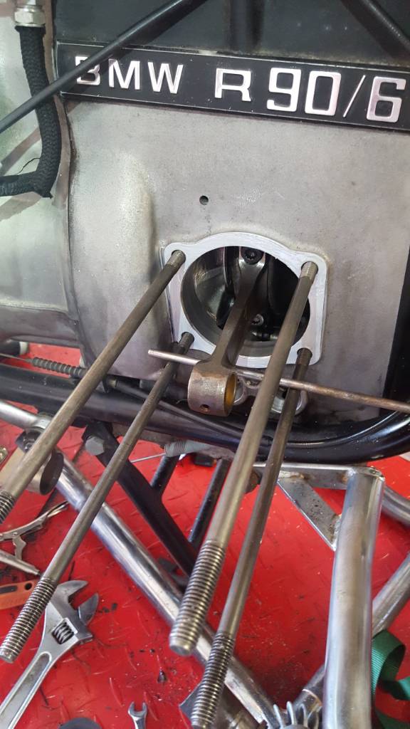

Top end put back together with fresh push rod tube seals and gaskets, and the fresh carbs to boot. I didn't do rings at this point as I didn't have the scratch and they were both pushing 145 cold psi per side. If I end up starting to blow smoke, ill do it then, but for now, it'll do. I put er together, clicked the starter and away she went. I'm sure it will need a carb sync, but that will have to wait til tomorrow.

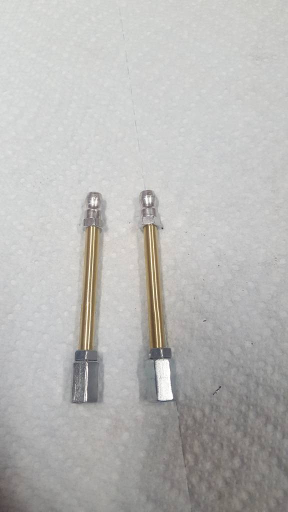

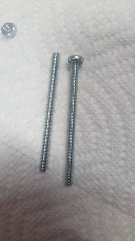

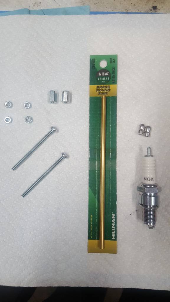

Time to start syncing the carbs. One known method on airhead bmws is to short out one side then the other using spark plug short rods and a screw driver to the head, until it runs evenly on both. I'm sure this is nothing new to most of you guys, but I figured I'd share my carb sync short out rods. I didn't have the time to wait on a set to order them, and this method is much cheaper. All told I think I have around $7 in the pair. I used two 4 mm by 60 mm long bolts with the heads cut off, two coupler nuts and four standard nuts (all 4mm) as well as a piece of 3/16 inch inside diameter brass tube cut into two equal lengths around 50mm long. All materials where in the hardware section of Lowe's. The coupler nut is recessed on the threaded rod enough to screw over the spark plug. I also used two old spark plug thread on terminals. The standard nuts just act as lock nuts to keep stuff from coming apart. These do fit on both Bosch and NGK caps.

Question on the spark plug shorts....why not just pull the cap off the plug? just easier and quicker to short it for a second to listen?
Thanks guys.
And sonic, there is a bunch of debate on that. Some claim that anything with points is safe to do just that. Some claim that you shouldn't pull plug caps on anything post /5. I figured for $7 I would just make up some short rods and not risk it.
You definitely don't want to pull caps with most (if not all) electronic ignitions.
John Deere made a snowmobile back in the day called a spitfire that had a unique to it c.d.i. ignition. If you didn't have the cap on the plug and pulled it over ONE TIME it was fried. Now, there are none of those boxes left, so many of those sleds are sitting around in good shape with a fried box that isn't available anymore.
I did light myself up even with the short rods. I grabbed a file instead of a screw driver the first time and it had a wood handle with a metal sheath up a little farther than I had realized lol live and learn.
