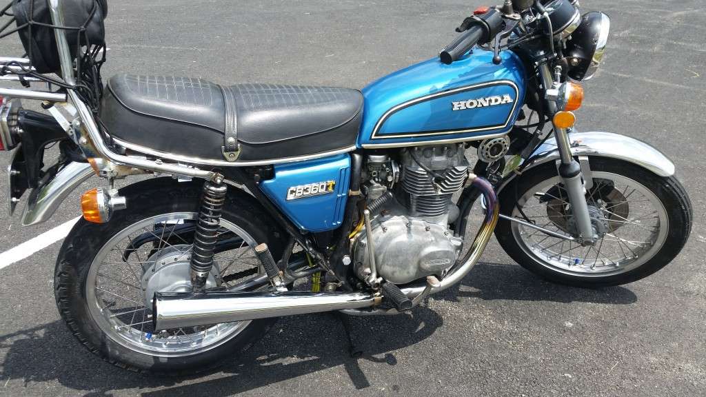

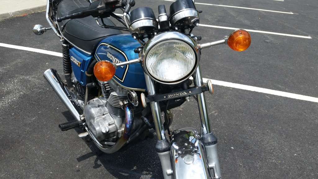

Was out on a 36 mile ride today, and took some updated shots:
She still needs a lot of work, start clutch, cleaning and touch up, more electrical clean up for better reliability
At least at this time, I roll her out, 1 or 2 kicks and she is purring like a kitten. Between the Pamco E-Advance ignition, Sonreir's excellent R/R, well synced carbs, the bike just runs well. No fuss.
Of course, if I have time, and the choice is to clean up or ride, Sophie stays a dirty girl and goes riding.
:D They sure have a nice and classic look when left bone stock and super clean. Nice work bud.
Very sweet machine. The fuse box will be a nice upgrade to the system.
The only major deviations from stock are silencers and wheel rims
Rims probably have the biggest and best effrect but also look like a period upgrade 8)
All in all, it's a better bike than a Triumph 500 twin (which is a comprable motrcycle)

Stock silencers are a little pricey in new condition. I used the cocktail shakers on my CB350 back in 1972. They were period correct. Ones like I have and Dunstall replicas were also used. Except for the e-advance ignition, and Sonreir R/R, I could take the bike back to say, 1978, and no one would know that it was from the "future" . Oh, I would need to delete the digital voltmeter from the tach... :)
BTW, the Key ring was purchased from a Honda Dealer in 1979. I need to have it face out, has the golden Honda wing emblem on it....
it looks fantastic ;) cudos for keeping the stock turnsignals as well they have so much more class than leads an are so much more brighter anyway

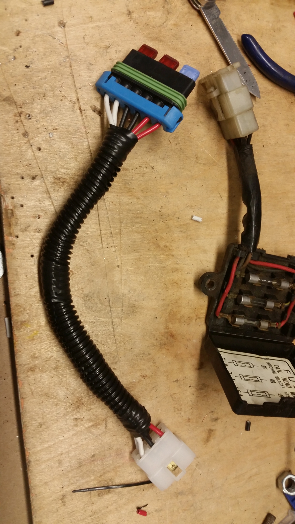

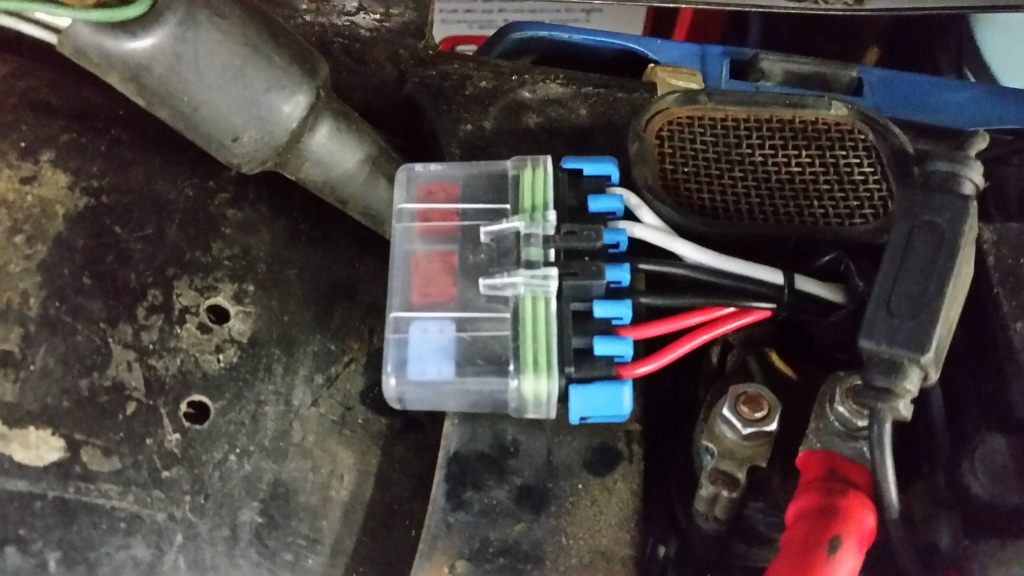

I haven't updated here in a while....I had some health issues last year and wasn't riding or wrenching. This year a little more riding. Sophie has been reliable and hasn't needed anything but gas and oil.... I finally had a little time to some other upgrades , so today I replaced the old fuse box with a new one that uses micro ATC fuses. The ATC fuses are less fragile than the OEM glass, and the fuse box I am, using has automotive type sealing to keep the fuses dry and protected.
I replaced the 6 pin connector too....This is a much more reliable solution .....

JustinLonghorn said:
Did you get the fuse box from CycleTerminal.com?
They have them on eBay and Revival and a million other places. I got one with four terminals for the 7fitty at Revival.
http://www.ebay.com/itm/Universal-Waterproof-Fuse-Relay-Box-Panel-Car-Truck-ATV-UTV-RV-Boat-4X4-Marine-/181835098358?hash=item2a563768f6:g:XxcAAOSwjVVVz4UP&vxp=mtr
https://revivalcycles.com/collections/motorcycle-fuse-block-and-replacements/products/waterproof-3-circuit-breaker-block
