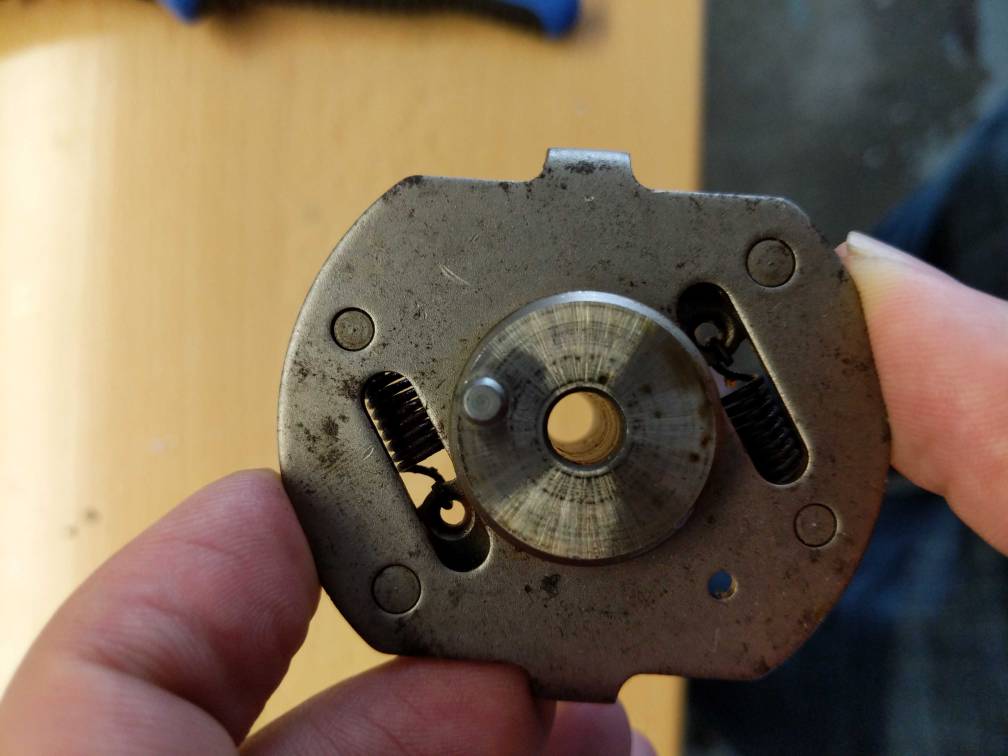

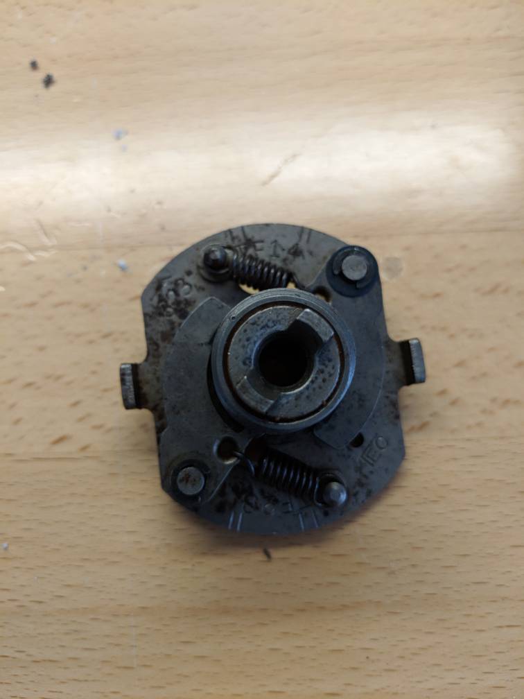

I'll give that a go. The advance weights are the spring loaded bobbit behind the points plate attached to the cam right? Maybe I put it on the wrong way? How could I tell?
I think they have a line on the cam that has to be up at a certain TDC. An easier way is to bring the motor up to TDC valves closed on #1 and see where the cam is. If the points are just breaking open for 1-4, you are OK. If they are wide open, the cam is upside down.

Do you see anything wrong with this?

Re: 1976 CB550F "Barn Find"
Just flipped the lobe. P1-4 start the light at f1-4
