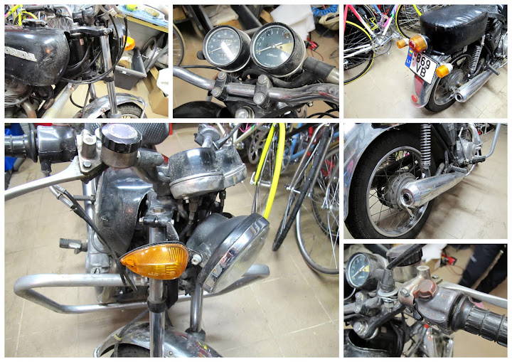

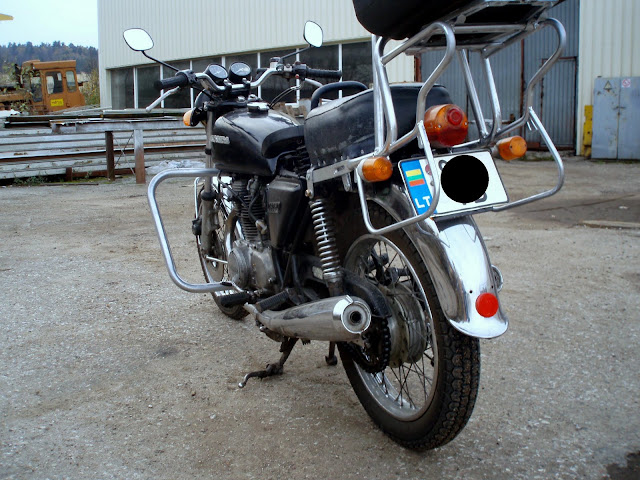

It looked like this in the add:
It looked like this when I got it:

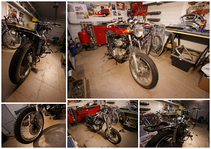

It looked like this after several hours spent:
As you may have noticed, that's a funny looking seat in the back. There were other smaller interesting elements on this bike too. The reason for this is the land the bike and I come from - Lithuania. As it's a Baltic state, 1980 bikes are quite rare here. The market of older bikes is dominated by Russian and Chezh bikes. I think you can count pre 1980 honda's on fingers of several hands. So as you may have understood, this bike has the headlamp from JAWA bike, the seat is from IZ and so on...

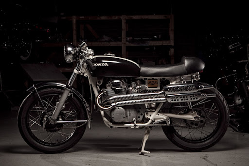

Oh, and my inspiration comes from this wonderful bike (if anyone have some bigger pictures, please share :]):
Re: "The Jack" 1976 Honda CB250g
now thats some good inspiration!

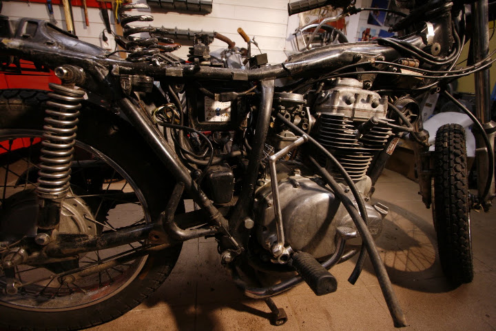

Thanks. I got the engine completely out and yeah, I think i will need a new gasket set, as it's really not looking as well as i wish it would.
By the way, the engine has a marking as CB250E. Although the model of the bike is 250G and in eBay, only gaskets for 250G could be found. May this be a replacement engine from some other model ?
All the disassemble is done...
Now I'm getting everything ready for sand blasting and power-coating. And here comes some questions:
1. How do you remove those inserts (damn, I don't know English term for them) from the rear fork ?2. How do you remove headset cups ? Or maybe you don't need to do that ? :]
Thanks in advance ! :]
The "E" just denotes an engine number, as opposed to the frame number. All honda motors have the E suffix.
The 'bushes' are pressed in, so you have to press them out. Or you could make up a 'puller' that will draw the bush out using a long bolt, a snug-fitting socket, and some washers.
By the looks of those, I'd replace them :o You can drive them out from the opposite end with a long screwdriver/punch. They're a tight fit, but should pop out with a bit of persuasion. A lot of people replace them with tapered bearings.
